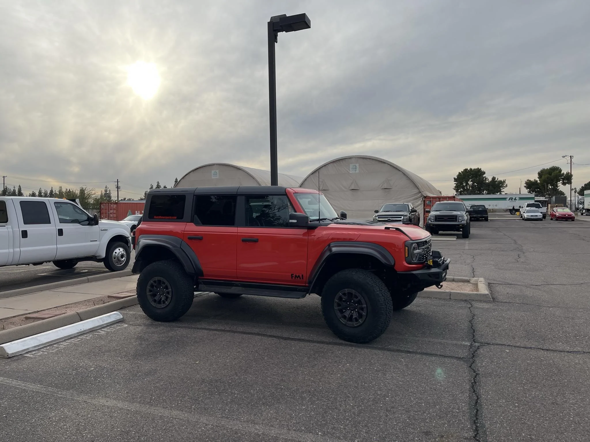

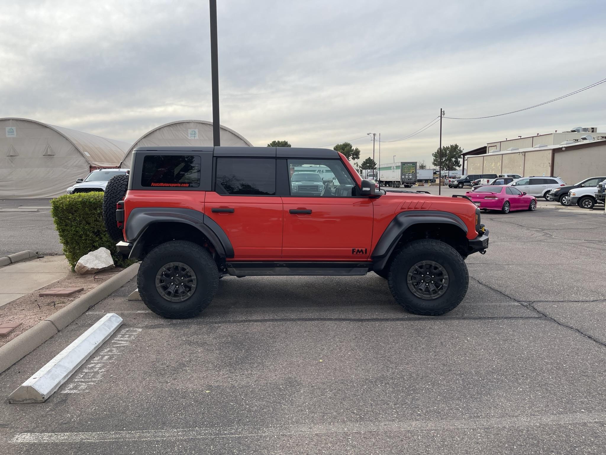

Here is ours with the 1.5" front and back. still has a little rake in the front but not bad. still with 37" tires on it.
Thanks for this! Couple of questions:
1. Would this setup accommodate 39’s with no rub or would you have to go the full 2” up front?
2. Would the 1.5(front) and 1(rear) lift/level allow a 39” tire with no rubbing?
3. Last question what’s the height of your vehicle with the 1.5 front and back with the 37’s. My garage is 80” so I want to make sure I fit with my changes.
Thanks for all of your help by the way. I have RTR 17x9 +18 and am looking to go with BFG KO2 39’s

I havent tried the 39" tire on this setup with the 1.5" kit on all 4. I would think you would want to wait for the 2" for that. I will also have a 2" rear and a 2plus level front shortly. I think that would get you what you want. I can try to measure it for you also. I didnt measure how tall it was to the roof.
