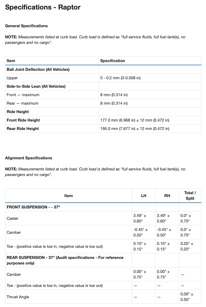

Hey Gang,
Going to do a 1.5 inch lift with perch spring collars and will be doing an alignment after. No shops have the specs yet and I don’t want to be at the mercy of the dealer if I don’t have to.
Does anyone have the alignment specs for the Bronco Raptor?

I highlighted something in the second table....WTF is that?
Specifications - Raptor
General Specifications
NOTE:
Measurements listed at curb load. Curb load is defined as "full service fluids, full fuel tank(s), no passengers and no cargo".
Item​
Specification​
Ball Joint Deflection (All Vehicles)
Upper​
0 - 0.2 mm (0-0.008 in)​
Side-to-Side Lean (All Vehicles)
Front — maximum​
8 mm (0.314 in)​
Rear — maximum​
8 mm (0.314 in)​
Front Ride Height
BASE, MID - BIG BENG, PREMIUM - OUTER BANKS, WILDTRACK, BLACK DIAMOND SERIES vehicles​
96.0 mm (3.779 in) ± 12 mm (0.472 in)​
BADLANDS SERIES vehicles​
113.0 mm (4.448 in) ± 12 mm (0.472 in)​
ADRENALINE RUSH PACKAGE - HERITAGE STANDARD, OVERLAND, WILDTRACK UPGRADE SERIES vehicles​
122.0 mm (4.803 in) ± 12 mm (0.472 in)​
Rear Ride Height
Series​
LH​
RH​
85.0 mm (3.346 in) ± 12 mm (0.472 in)​
247.0 mm (9.724 in) ± 12 mm (0.472 in)​
102.0 mm (4.015 in) ± 12 mm (0.472 in)​
265.0 mm (10.433 in) ± 12 mm (0.472 in)​
115.0 mm (4.527 in) ± 12 mm (0.472 in)​
278.0 mm (10.944 in) ± 12 mm (0.472 in)​
Alignment Specifications
NOTE:
Item​
LH RHTotal / Split
FRONT SUSPENSION
CASTER - BASE, MID - BIG BENG, PREMIUM - OUTER BANKS, WILDTRACK, BLACK DIAMOND SERIES vehicles3.47° ± 0.60°3.47° ± 0.60°0.0° ± 0.70°
CASTER - BADLANDS SERIES vehicles3.35° ± 0.60°3.35° ± 0.60°0.0° ± 0.70°
CASTER - ADRENALINE RUSH PACKAGE - HERITAGE STANDARD, OVERLAND, WILDTRACK UPGRADE SERIES vehicles3.18° ± 0.60°3.18° ± 0.60°0.0° ± 0.70°
CAMBER - BASE, MID - BIG BENG, PREMIUM - OUTER BANKS, WILDTRACK, BLACK DIAMOND SERIES vehicles-0.23° ± 0.50°-0.23° ± 0.50°0.0° ± 0.70°
CAMBER - BADLANDS SERIES vehicles0.12° ± 0.50°0.12° ± 0.50°0.0° ± 0.70°
CAMBER - ADRENALINE RUSH PACKAGE - HERITAGE STANDARD, OVERLAND, WILDTRACK UPGRADE SERIES vehicles0.20° ± 0.50°0.20° ± 0.50°0.0° ± 0.70°
Toe - (positive value is toe in, negative value is toe out) - All Vehicles0.20° ± 0.20°
REAR SUSPENSION (Audit specifications - For reference purposes only)
CAMBER - All Vehicles0.00° ± 0.75°0.00° ± 0.75°
Toe - (positive value is toe in, negative value is toe out) - All Vehicles0.22° ± 0.20°
Thrust Angle0.00° ± 0.50°

Caveat. Ford specs are one thing, actually getting aligned properly so that it steers correctly and set to keep tires from prematurely wearing is another. Find an experienced shop that knows how to push, pull, bend, slot things to get the best possible alignment. A lot of places, "set the toe and let it go" and don't bother with anything else. In two months when the tires wear they'll say the alignment got knocked out by hitting a pot hole or something.

Thanks @flip and yeah wth is Overland! Maybe Everglades, but I think it has just the standard SAS packing.
I'll use the Wildtrak Upgrade/Adrenaline Rush specs for my Raptor and yes, the numbers are just a starting point and not a full successful alignment.

Hey Gang,
Any success with this? I did same setup and took to dealer for alignment cause I thought they were only ones with the proper specs. Turns out they used the Badlands w/ Sasquatch specs which I'm not sure would be the same for Braptor.... My steering wheel alignment is also out of whack now.
Haven’t tried yes, I’m traveling for business. Did they used the Wildtrak Upgrade Specs? That’s what I’m planning to use.
