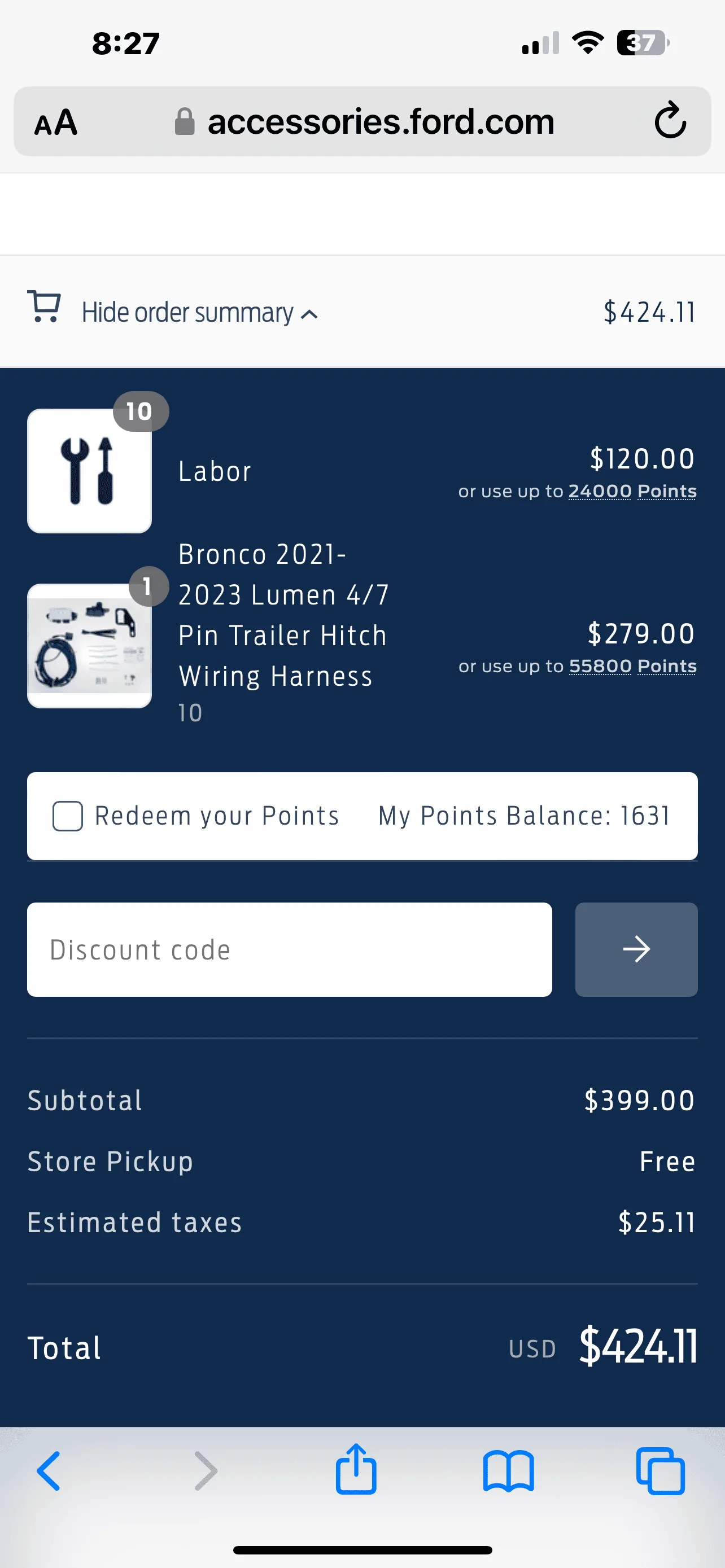

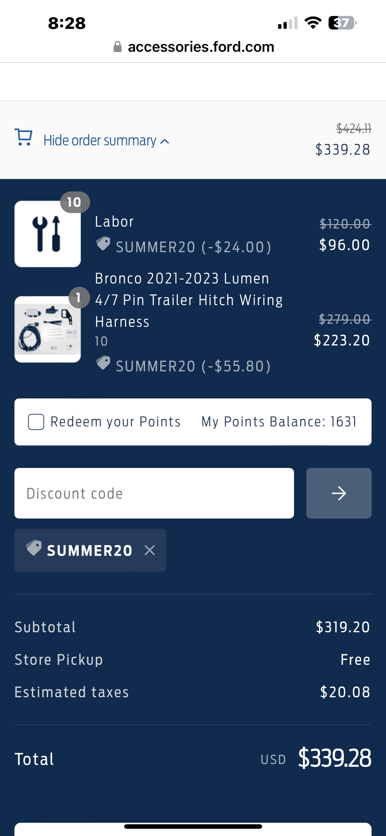

The Ford accessories website has 20% off orders of $300 or more (Summer20) if you select dealer install itā€™s puts it over that threshold. Iā€™ve attached screenshots. Also remember if the dealer installs it then itā€™s covered by the warranty. Well worth not having to put up with the aggravation. Iā€™m scheduling for next Friday.
