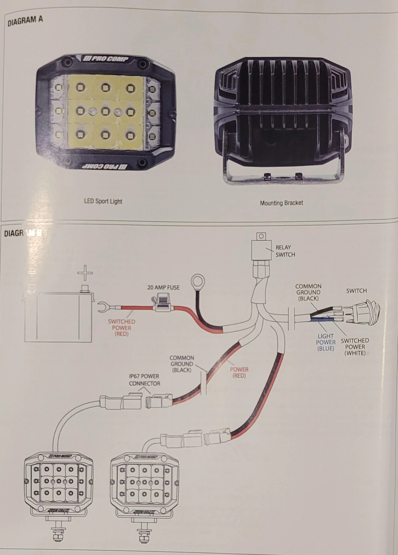

Just got these Pro Comp lights to mount at my mirrors. The question I have is in regards to the harness with the lights. I just installed lights in the bumper running to the #3 access. switch, I want to run these to #4. The harness with the lights includes a relay. Do I need to keep the relay or cut it out and wire direct like I did with my bumper fogs?

If you’re wiring to the factory Aux switch then you don’t need the relay. The relay is only necessary if you’re using the aftermarket switch

A relay is for low amp activation of a high amp load. I have the RIGID 3" pods and two of them pull less than 4 amps so as long as your switch circuit is rated higher than your load no need for a relay.
