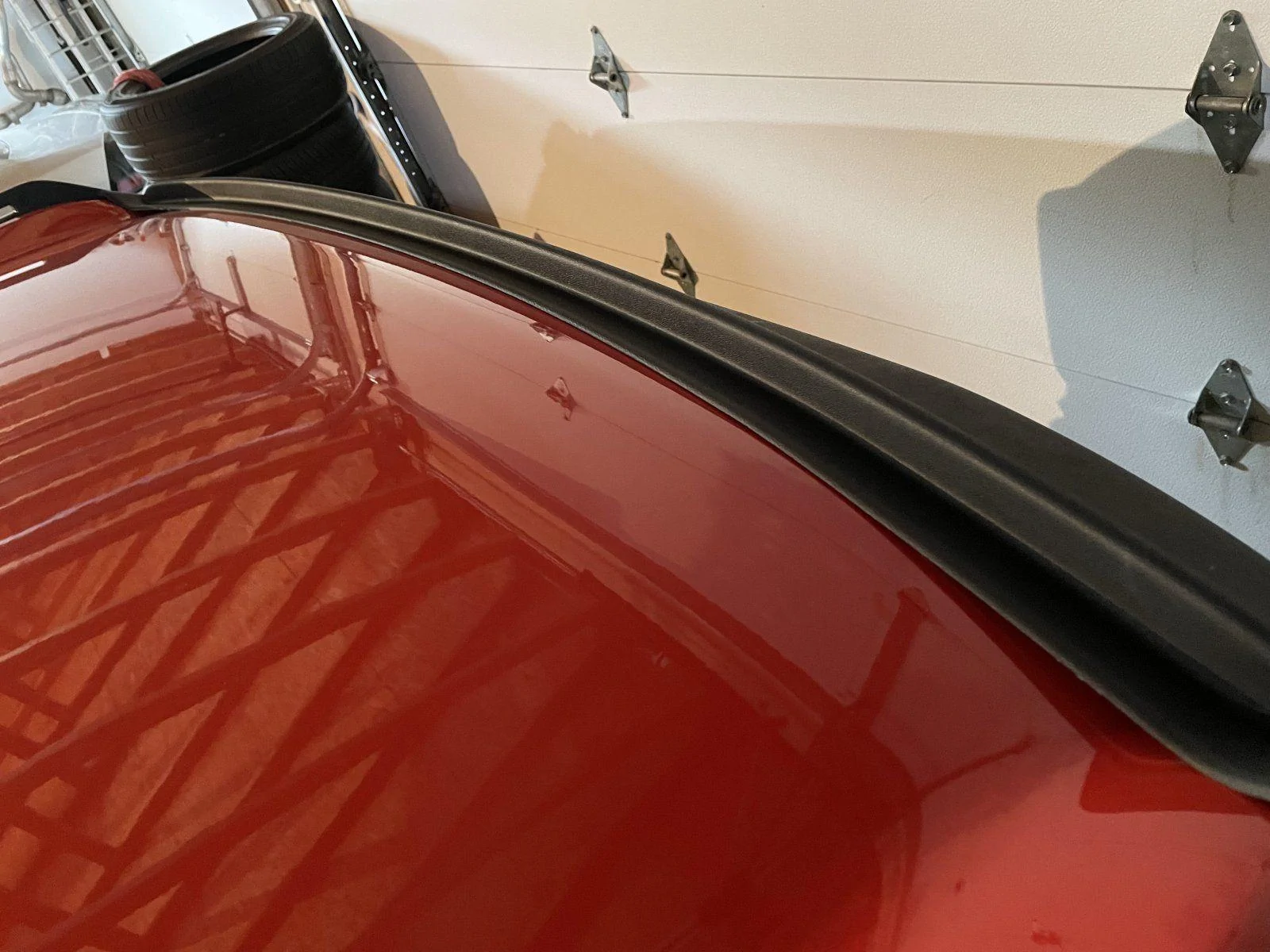

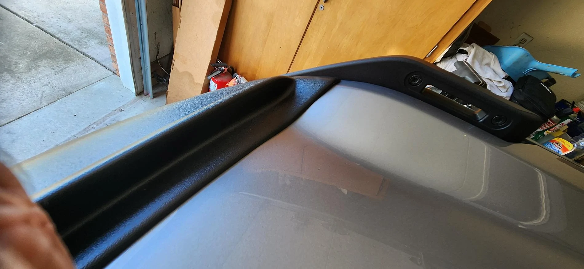

A heat gun solves the bad fitment in about 10 minutes. This is Ford's version, I didn't realize it was without that small deflector lip. With that said, it seems to be made of a self-healing plastic that dampens the impact enough to deflect and slow down rocks.
I used 3M PPF underneath to protect the paint.

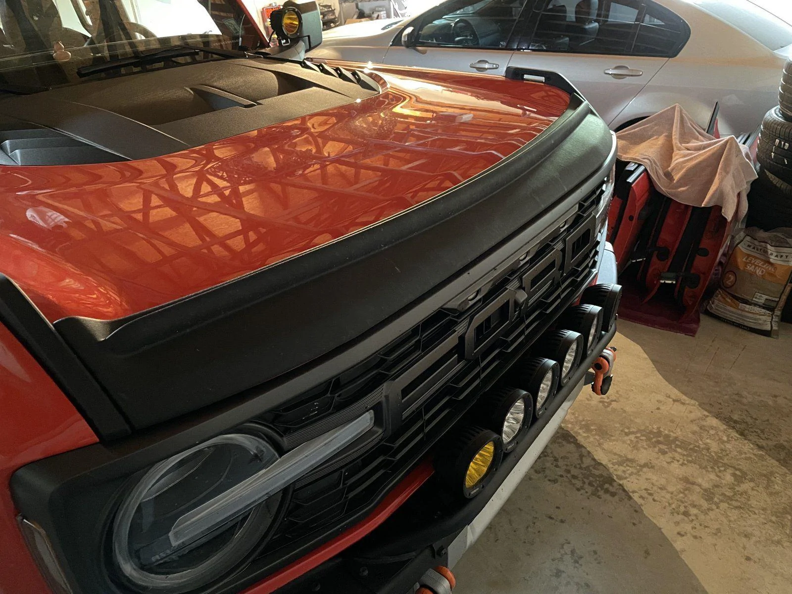

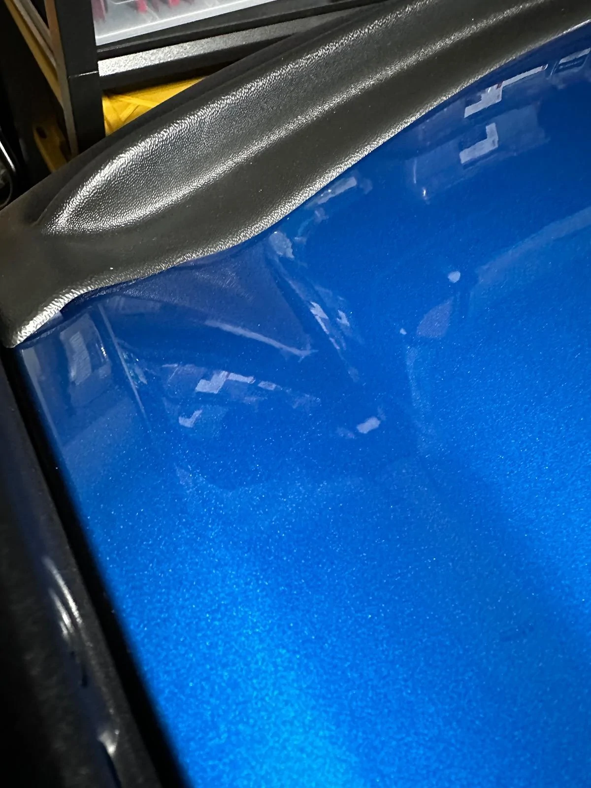

I just installed this hood guard/deflector on my 2026. It’s not rigid like some of the other ones so just left it in the sun for a little while to get more flexible. Also added more double sided tape to allow as much contact as possible. Turned out pretty good i think. Provided the link to amazon where i got it from.
https://www.amazon.com/dp/B0DWFC292N?ref=ppx_yo2ov_dt_b_fed_asin_title&th=1

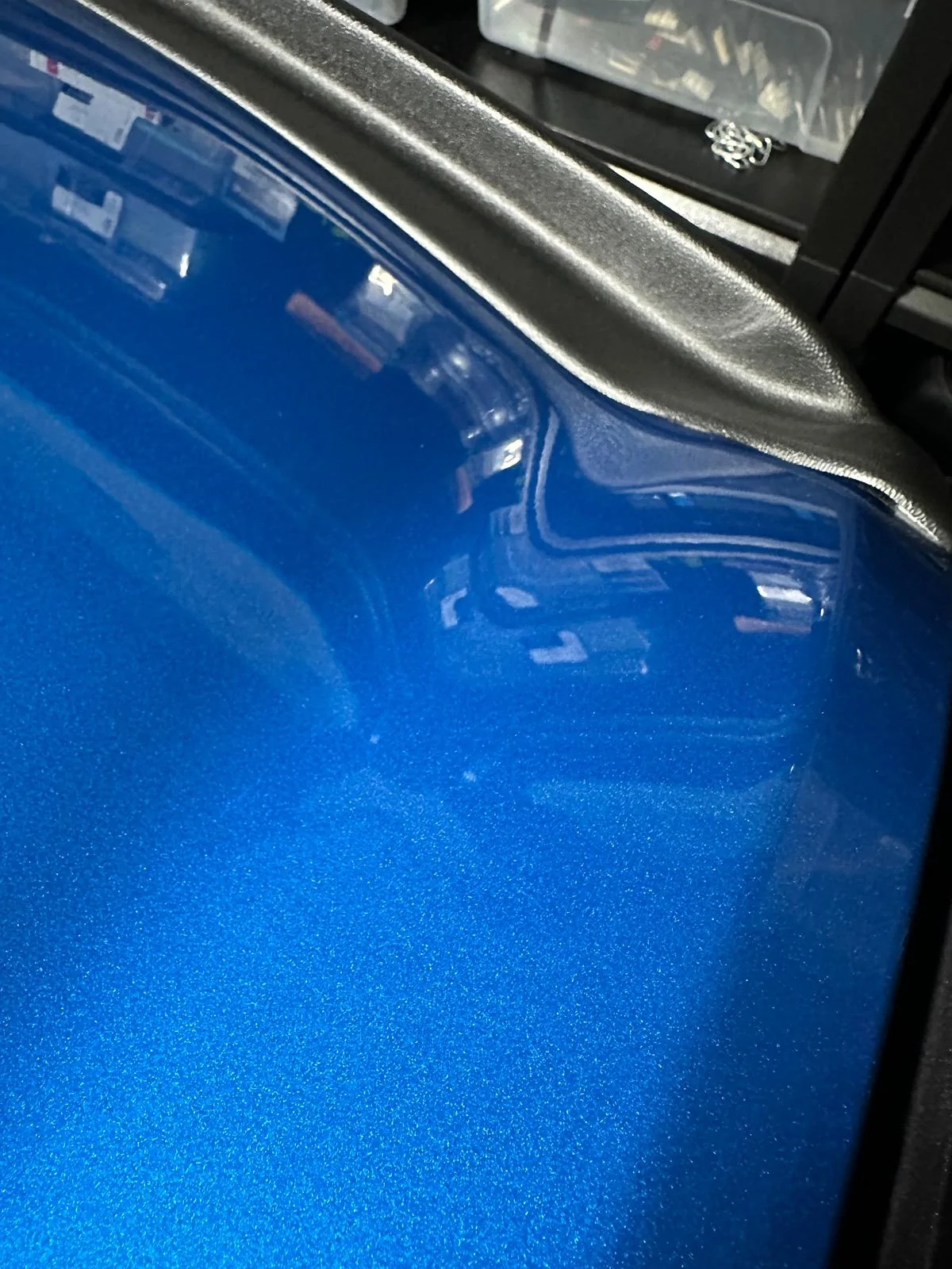

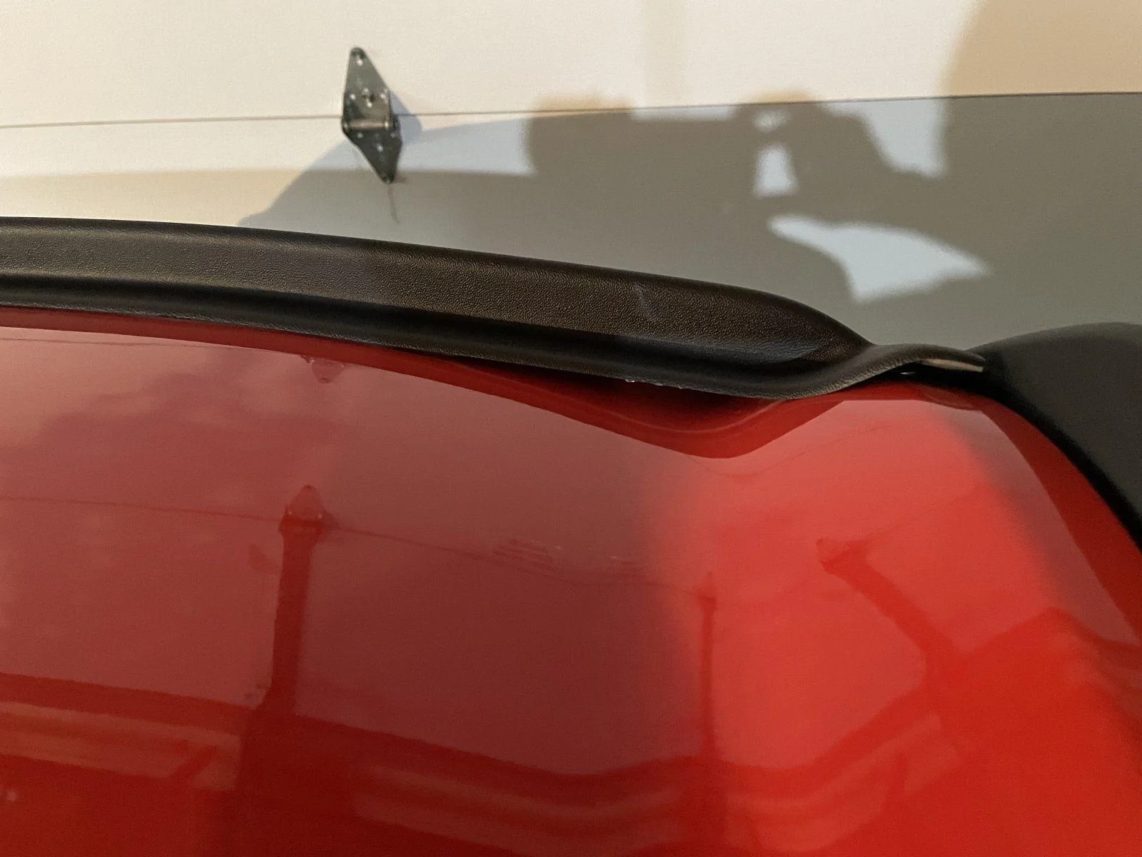

Used a Wagner heat gun and shapes the outer ends. Someone else did this trick in the forum. Took about 30mins. Just wear leather work gloves and take your time.
