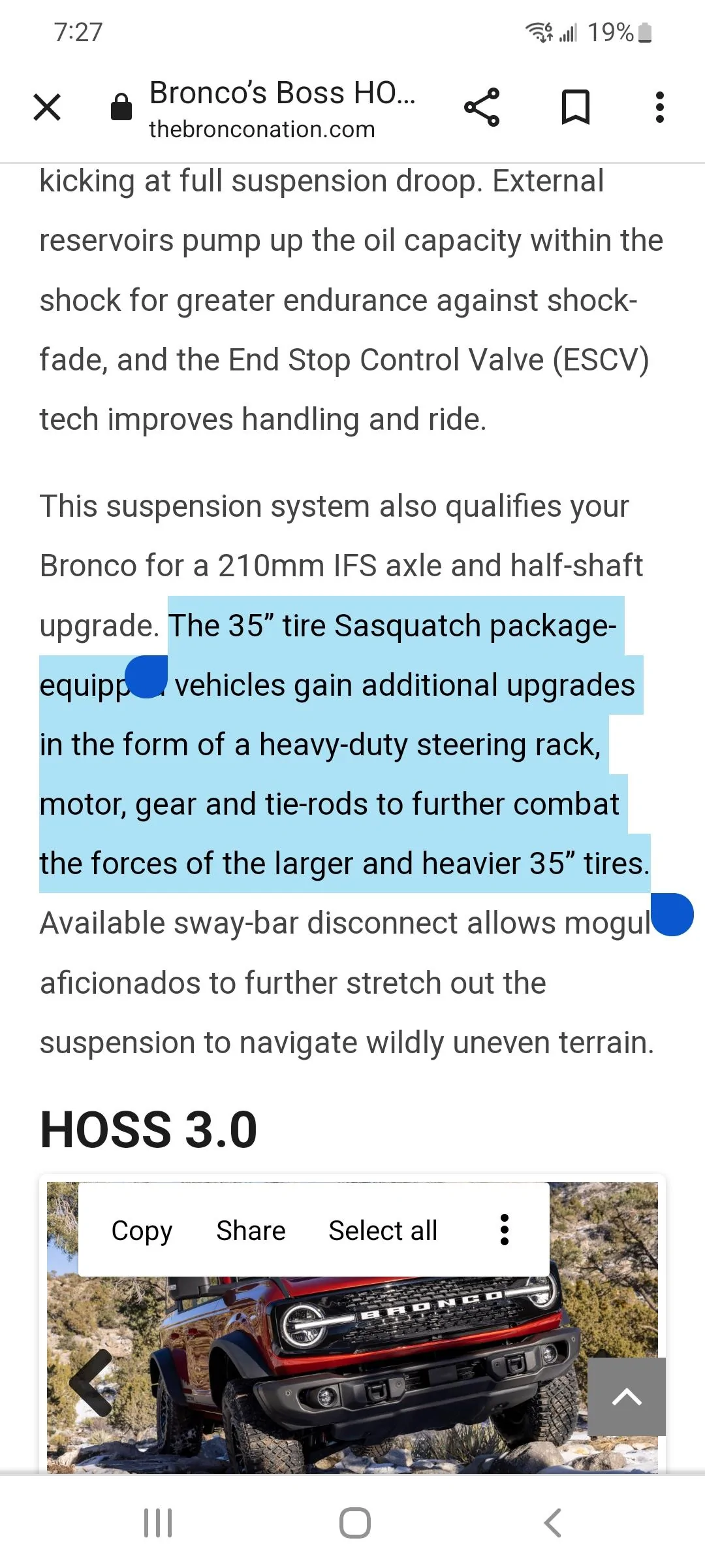

Super late to the party (and there's probably a better thread by now), but I've recently discovered that the Sasquatch package–on all series–also comes with an upgraded steering rack and tie rod setup (heavy-duty, but not severe-duty from 3.0 and Raptor). @RagnarKon can you confirm? You're a source of truth here and can probably even verify different part numbers if this is the case. Is there a better place to put this once verified or not?
The upgraded steering rack and tie rods is only available in the HOSS 3.0 package, which… as of right now is only available on the Wildtrak trim.
In my opinion it should be standard as part of the HOSS 2.0 suspension (Badlands and all Sasquatch’s Broncos). Maybe in the future it will be, but not right now.
I was talking about this little hidden gem on Bronco Nation. Anything to it? I mean, I'd think it'd be well known by now if that was the case.

Further down in the article it states that there's a "severe-duty" for the Hoss 3.0 and Raptor. So three setups...basic (all non-Sas), heavy-duty (SAS), and severe-duty (3.0 and Raptor).
I mean, it's what it says 🤷
Let me guess where you heard that piece of mistruth "my dealer said"?
No, Sasquatch does not have and upgraded rack.
Next time it's best to start a new thread instead of digging up a year old thread.
As usual, more BS from BN.
Read above. And play nice. I responded on an old thread to stay quiet.

Who is the source of the data, BN or a dealer, either way they are wrong, there are only two setups, NOT THREE.
