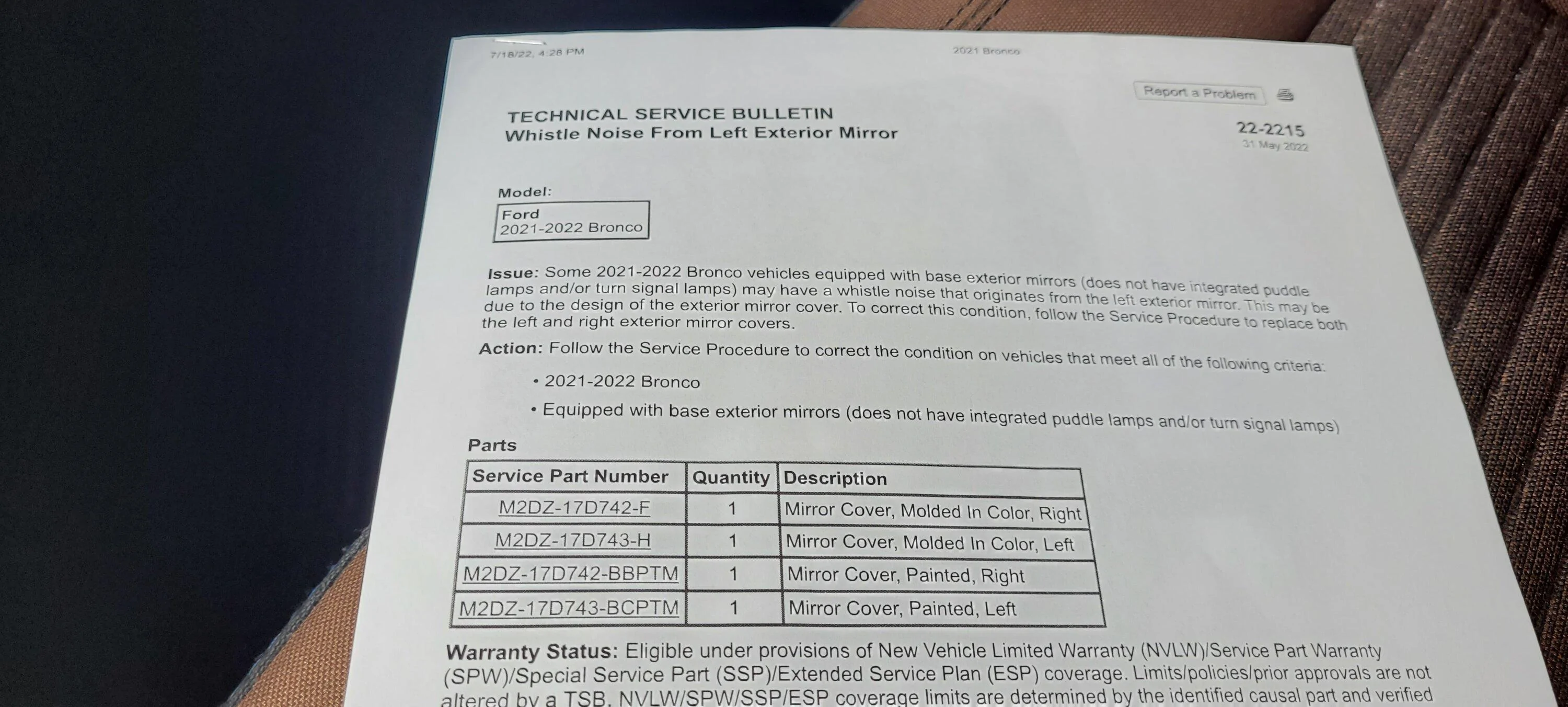

New TSB for the mirror whistle.
22-2215
They will replace the mirror caps.
Ford Bronco Whistling noise above 40mph - partial solution 20220718_165348

Now superseded by TSB 22-2297.
Tried to get my dealer to follow this. Instead they replaced the mirror cap with same type. Still whistles 🙄.

Good morning! Please send over a private message including your VIN and dealership info at your earliest convenience. I can look into this for you.
