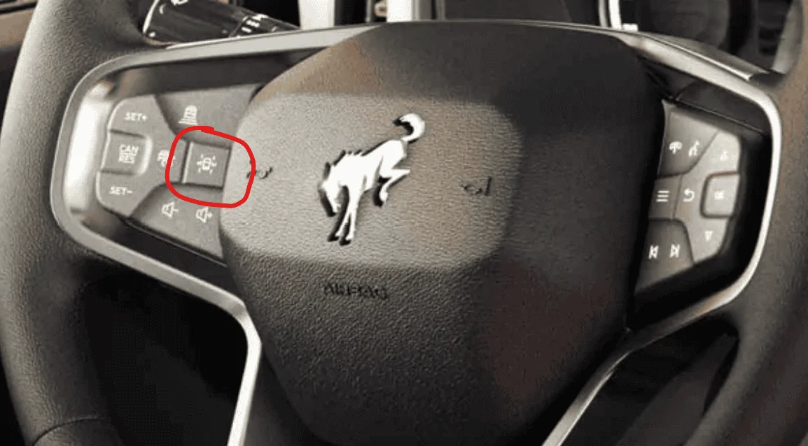

I noticed that this button would appear when I added the mid package. What does it do?

That is the lane centering assist. That might not be the right name for it, but basically if you drift out of your lane it will bump your wheel back towards the center. You can turn it off completely, or adjust the firmness of the assist in the settings. Personally I'm not a fan, but maybe they have improved since 2013.

Looks like the anti-thief spider button.

Bumping this thread with an update. The button does turn on/off the Lane Keeping System. https://www.ford.com/technology/driver-assist-technology/lane-keeping-system/
I had to turn the system off because the sensitivity on the steering wheel sensor is too low. When I have it on, the system is constantly alarming and telling me to put both hands on the steering wheel.
My '18 F150 had a previous version of this that was much more functional and rarely took issue of the way I handled the steering wheel.

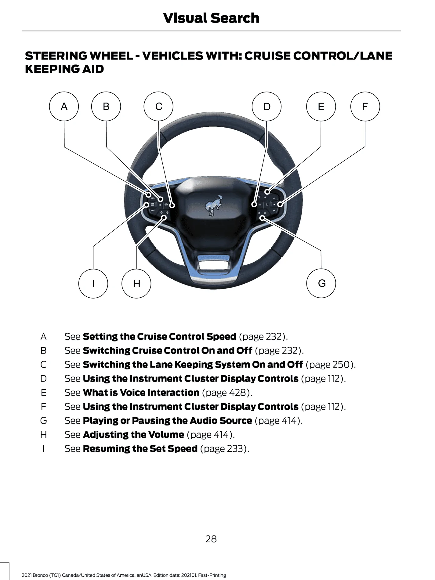

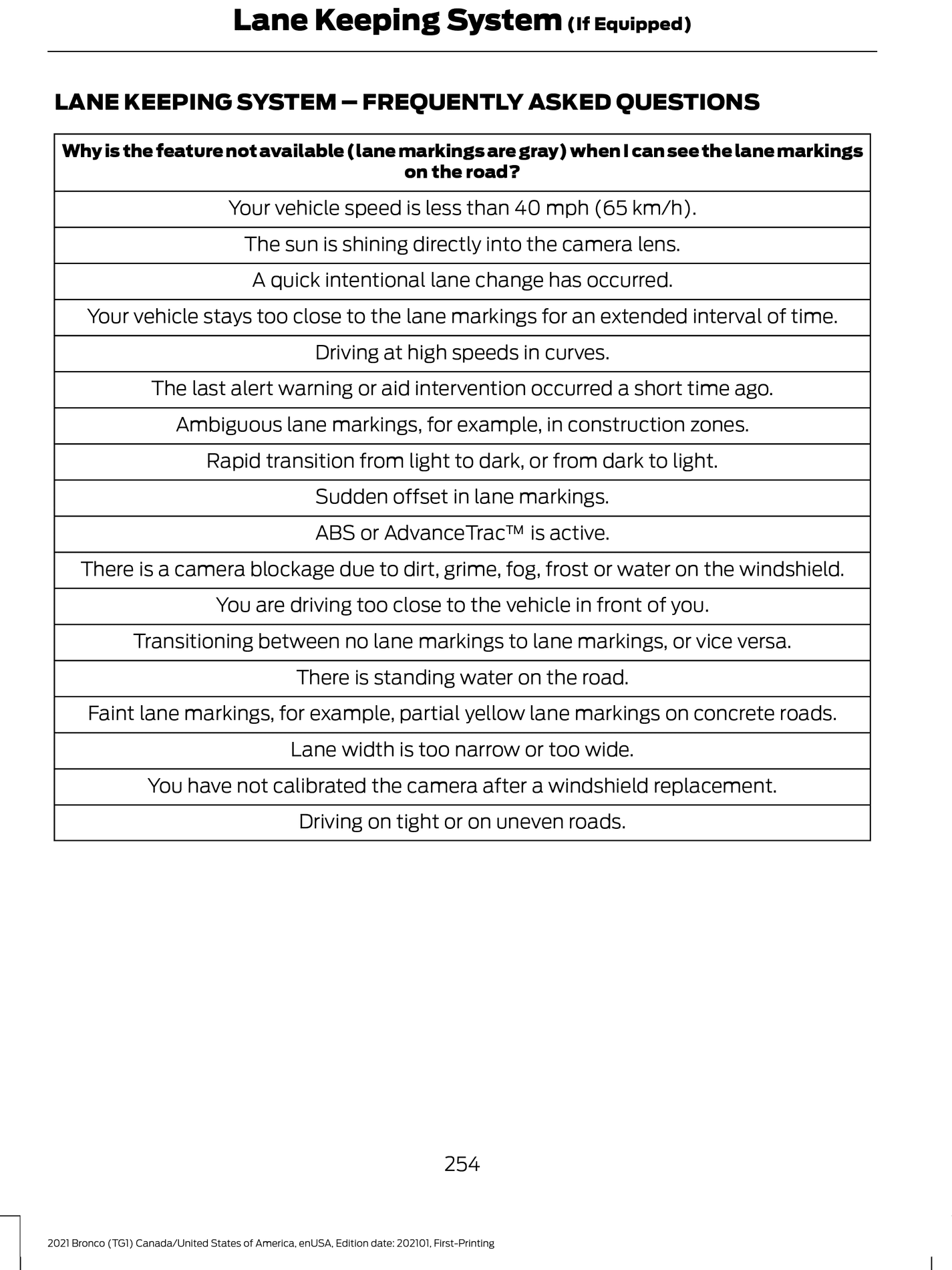

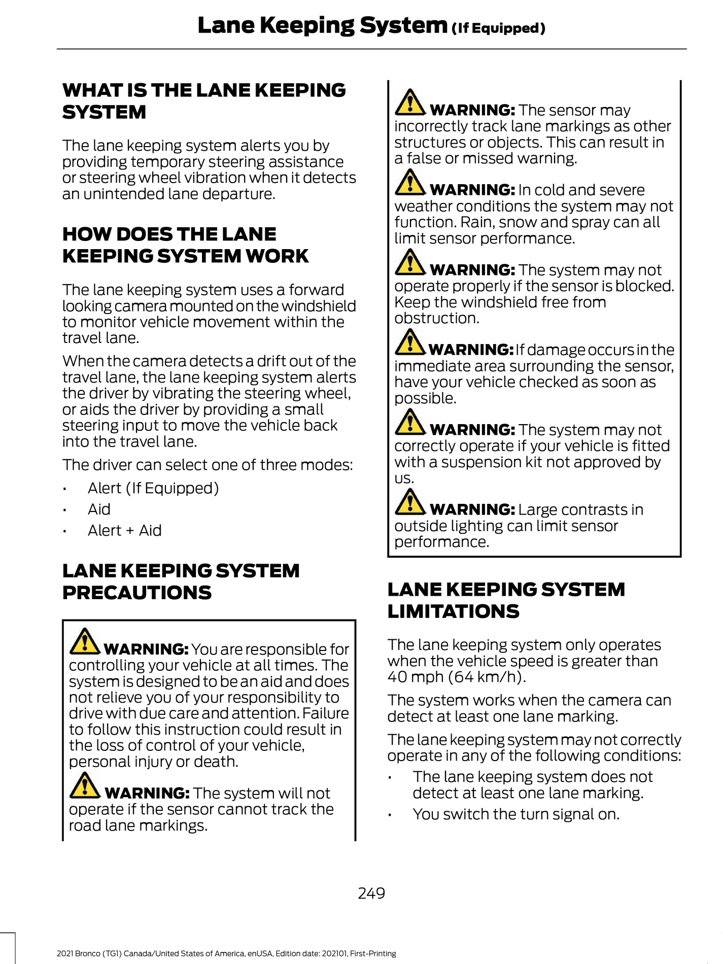

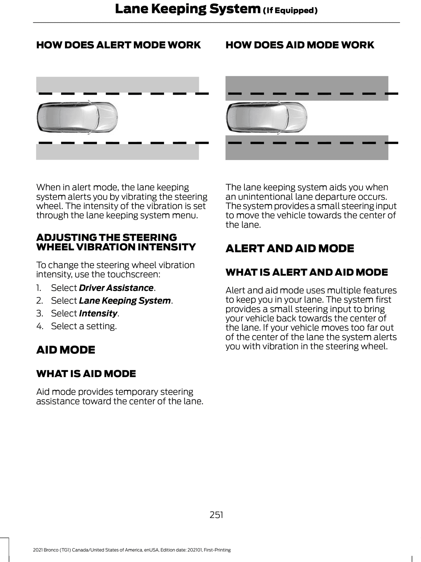

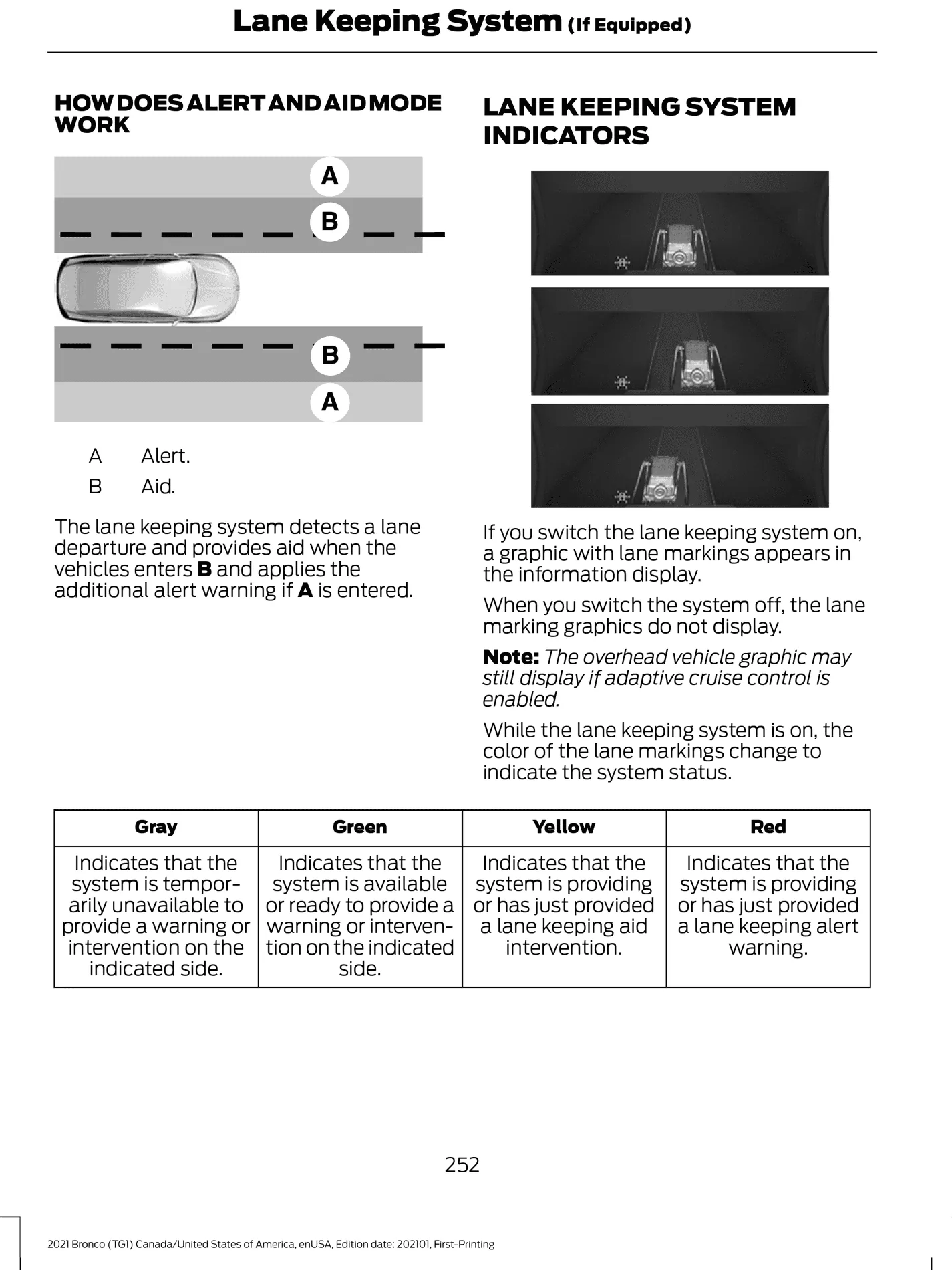

Detailed info from the Owner’s Manual…
