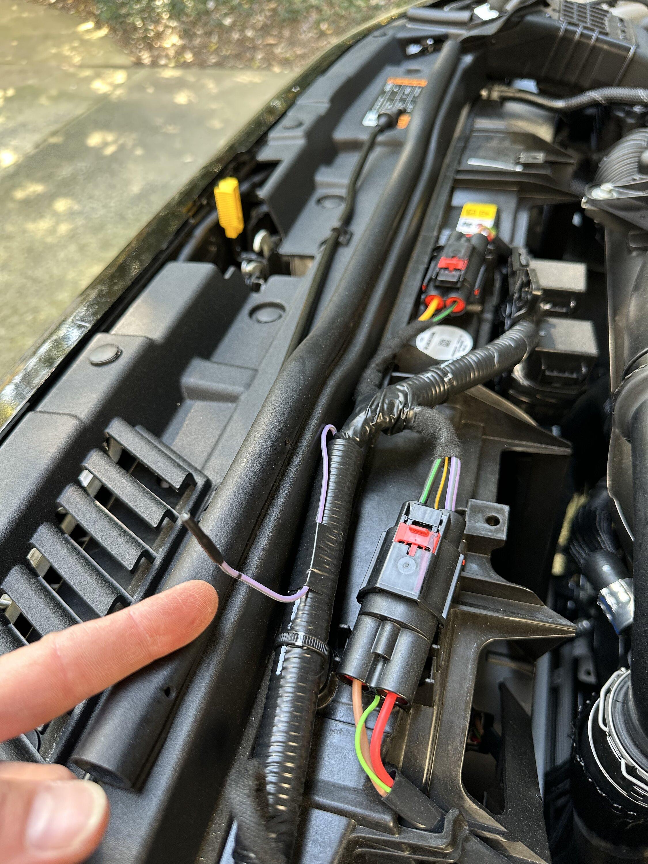

can’t find info on this wire. Anyone know what it’s there for?

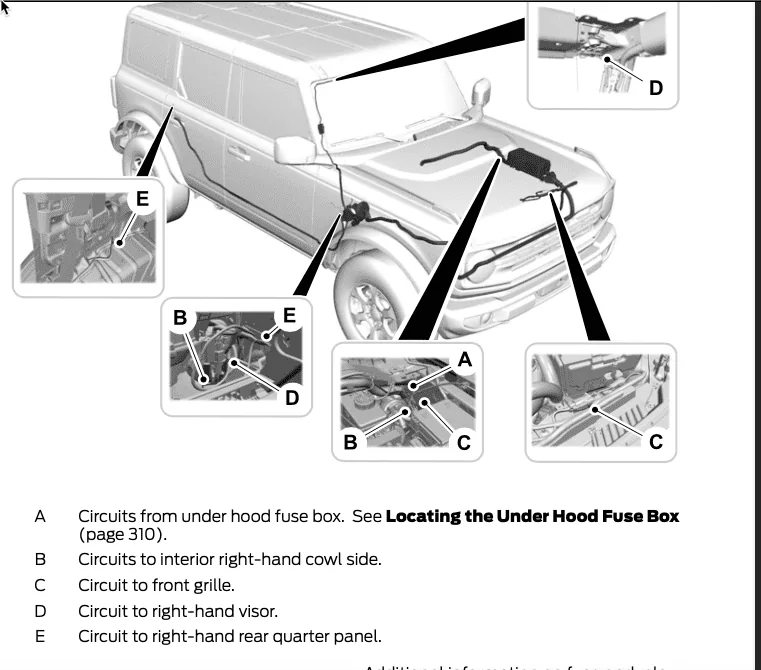

That is one of the circuits "C" relating to the picture, to tie into your AUX switches.
