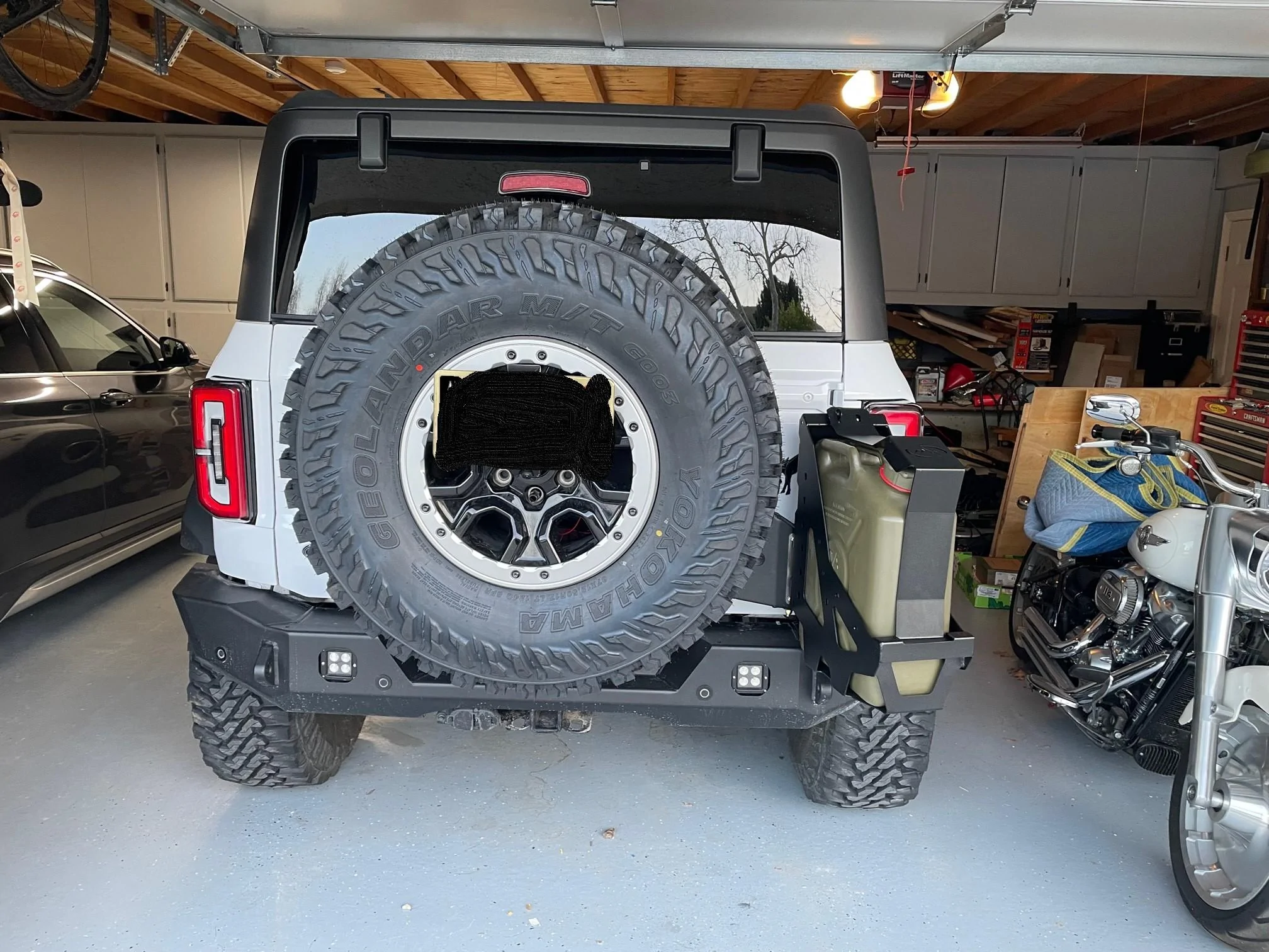

I think it is a bit of a half measure and if there is actually a worry of failure due to stress from heavier wheel or other wheel-carrier-mounted equipment, there are two much better solutions... Replace the hinges with beefier ones, or mount the tire/other equipment to the bumper on a swing arm. Both solutions are already available aftermarket, though at a much heftier price than the brace.
Yep.
I went for the bumper replacement to put the weight on the frame for longevity. It also let me mount a fuel can carrier for when I need it.
