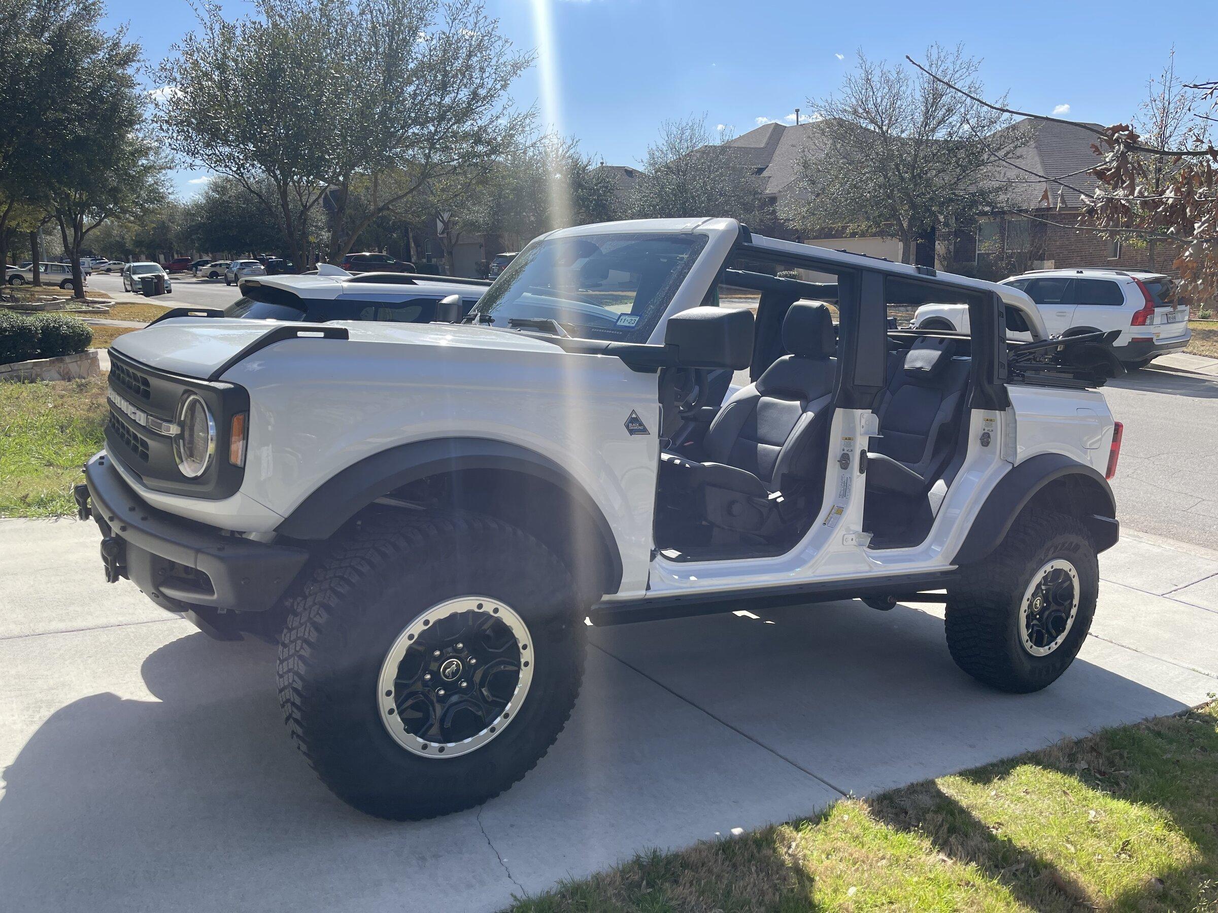

Been awhile since I've posted since taking delivery of my Bronco in December. So, its officially Spring and the first thing I did was take the doors off my Bronco for the last week. Its been great I missed the experience since selling my Jeep Wrangler. I've noticed though I keep constantly getting warnings pop up on my dash....none were really worrisome until I got one that said break failure and a host of other issues. I turned off the car and restarted and it never came back on. I'm assuming this is just a glitch but has anyone else had issues when taking the doors off and all the warning lights going off?
