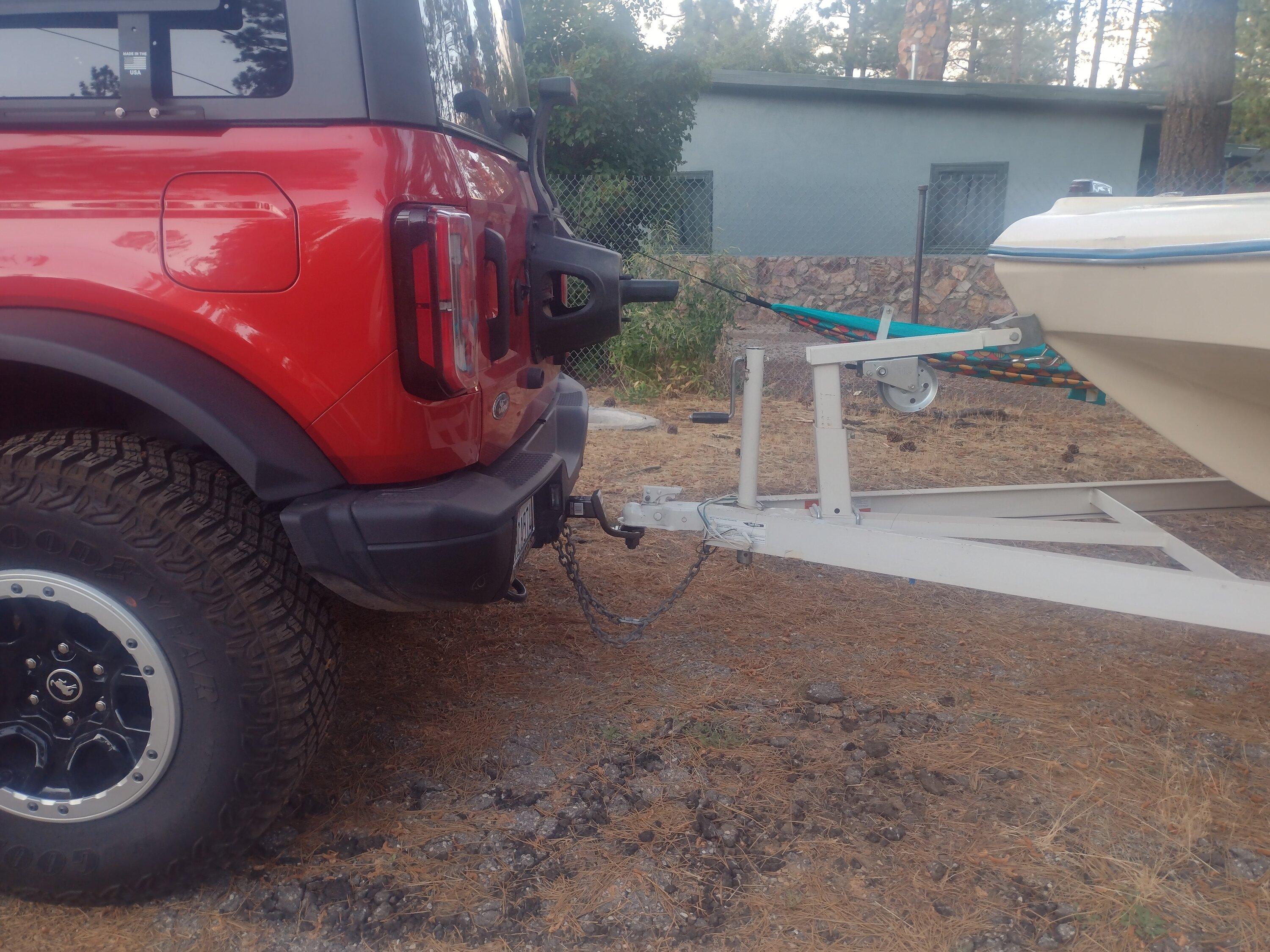

Just an fyi for everybody..don't expect to just hook up your trailer or boat! 2" drop hitch and I still had to take the spare tire off to hook up. It would have been
Ford Bronco Towing with Sasquatch badlands IMG_20230818_191627634
nice to know beforehand that the 35" tire doesn't allow enough space for a receiver with less than 3" drop.

In the future if you set your trailer level, measure that height then walk to the tow vehicle you can then measure the receiver height and see what size drop you need. You can look and see if anything may be in the way, added bonus is you have a measuring device in your hand to make sure.

For starters that trailer tongue is short. Look into an extended drawbar for the Bronco. Not an extension, but an extended drawbar.
