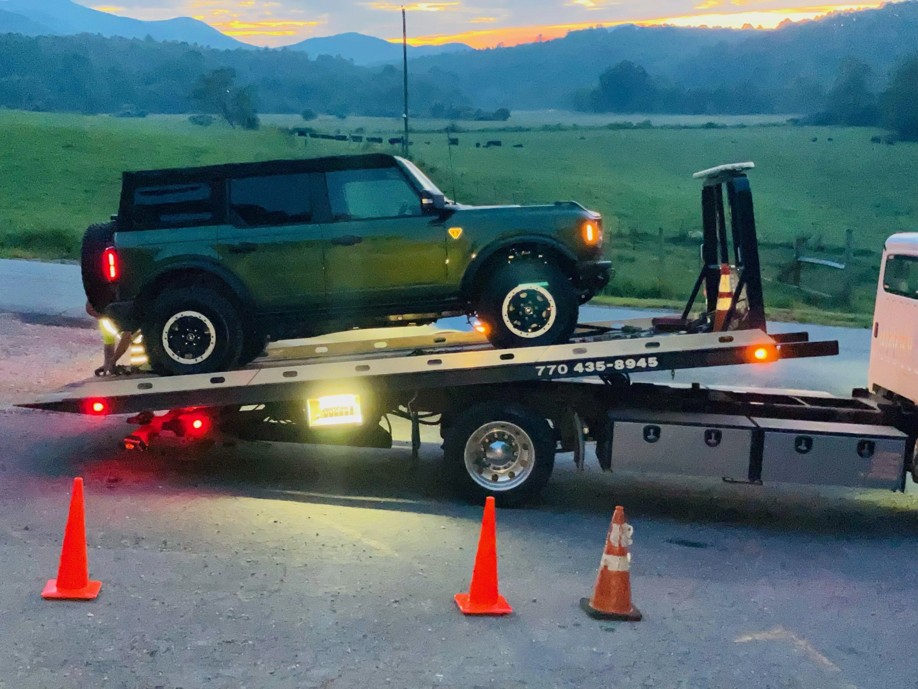

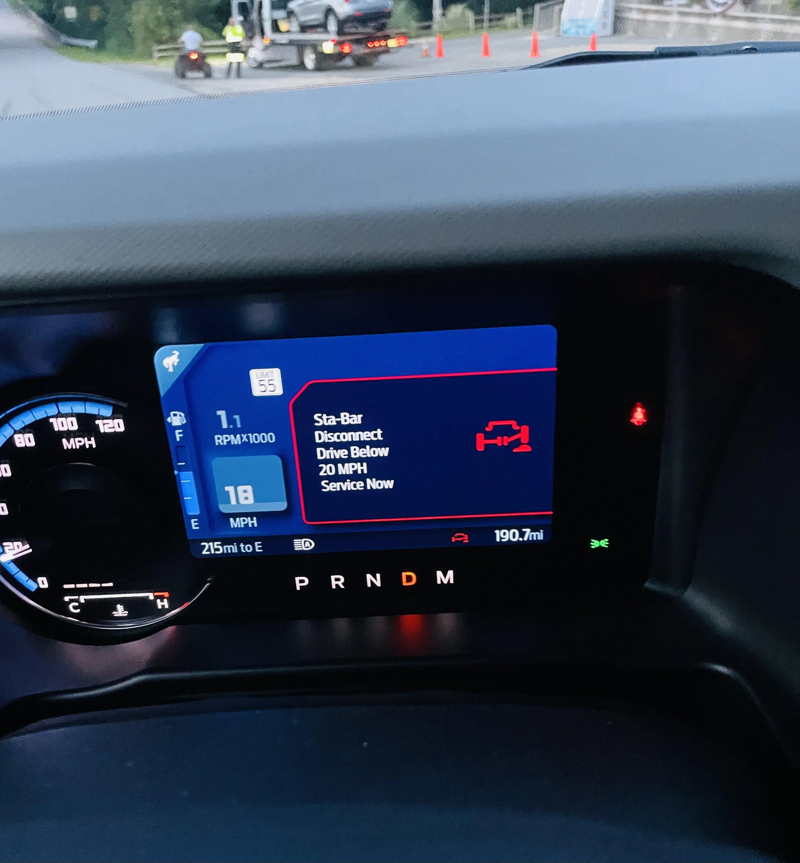

90 minutes after pulling out of dealership got this message on the dash:
Sta-Bar Disconnect Drive Below 20MPH Service Now
Had to get towed to dealership, they think it is a sensor gone bad, said about a week or two to get parts/fix.
Said they're 85% sure sensor is the problem, bar is connected. Badlands Sasquatch. Thanks for any help.

Yes my sensor was replaced and it was good for about a week. Part of the sta bar was eventually replaced and it’s been good since.

Also you can drive it until repairs made. I think if they reset the sensor they need to wait 8 hours or so before re-testing. Mine was fine for about a week (and 800 mile road trip), then threw warning again after backing up over about a 6 inch drop. It’s a known issue your dealer should be quick to address, but I think protocol is for sensor reset first.

They did come out with TSB 22-2325 to reprogram the chassis control module about a week ago for a similar issue. Has to have code C103A:74 in the system to be applicable. It doesn't really say anything as to what the cause is, just to update the module's software.
Going to ask Monday
This is great, will send this in. Thanks!
