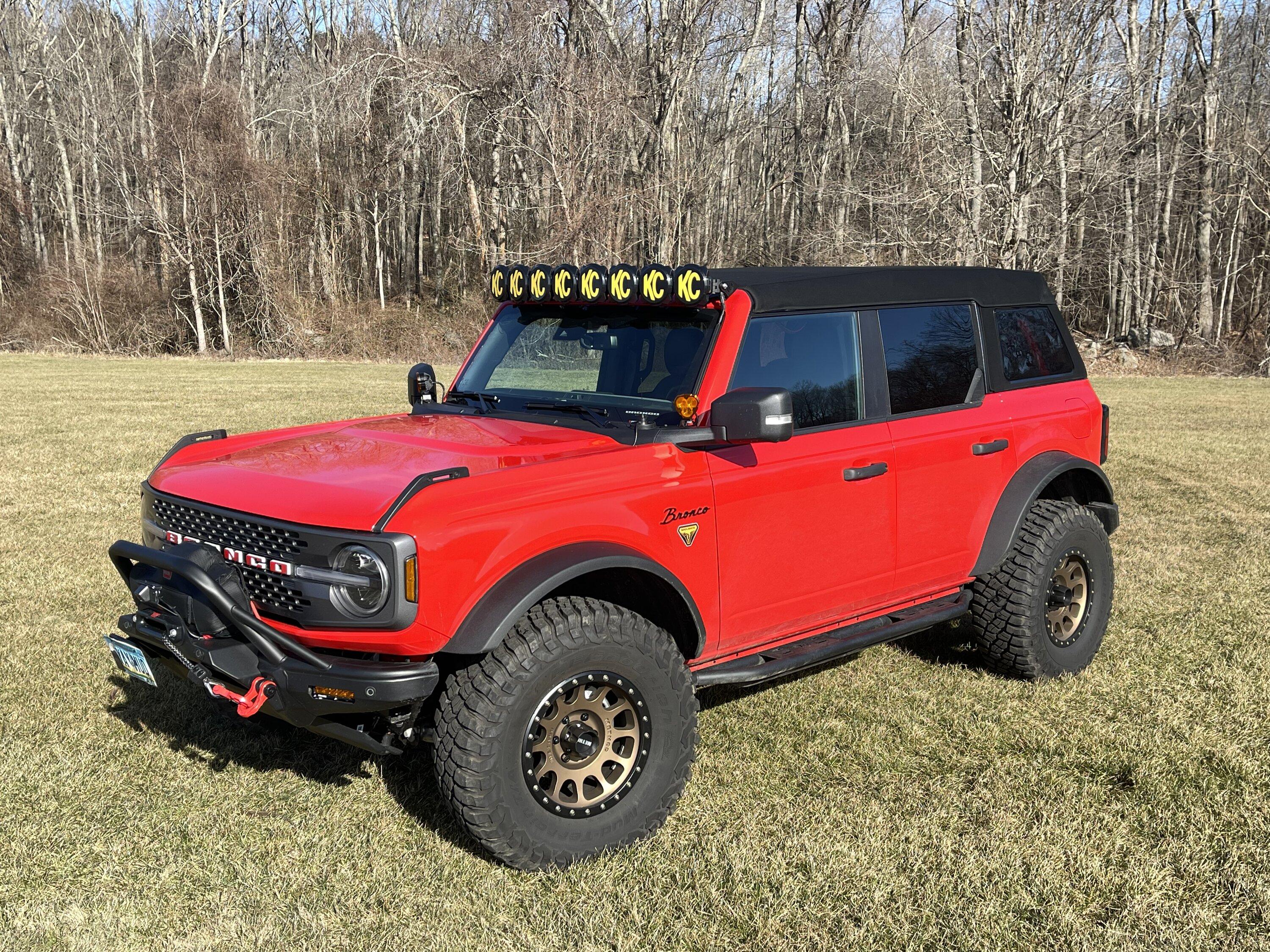

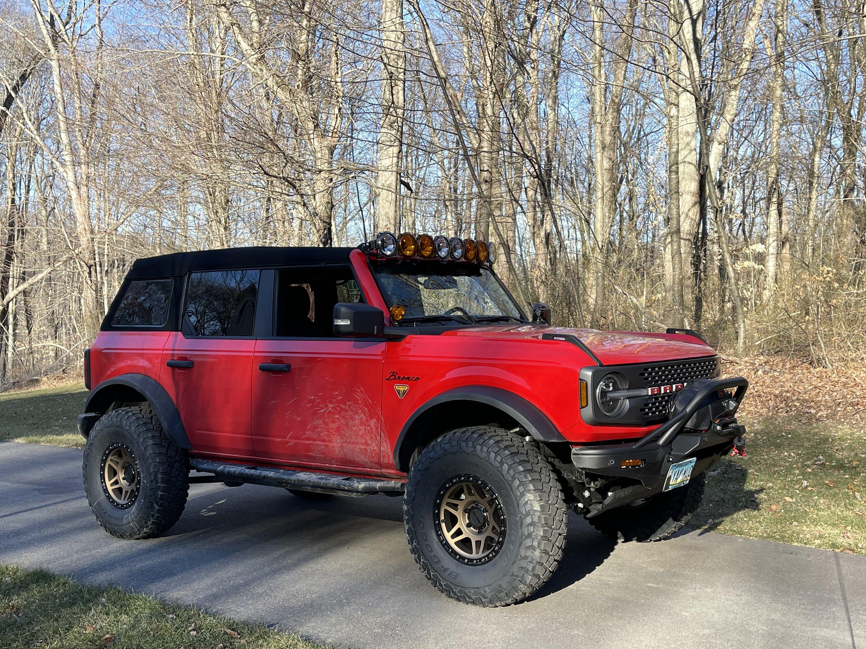

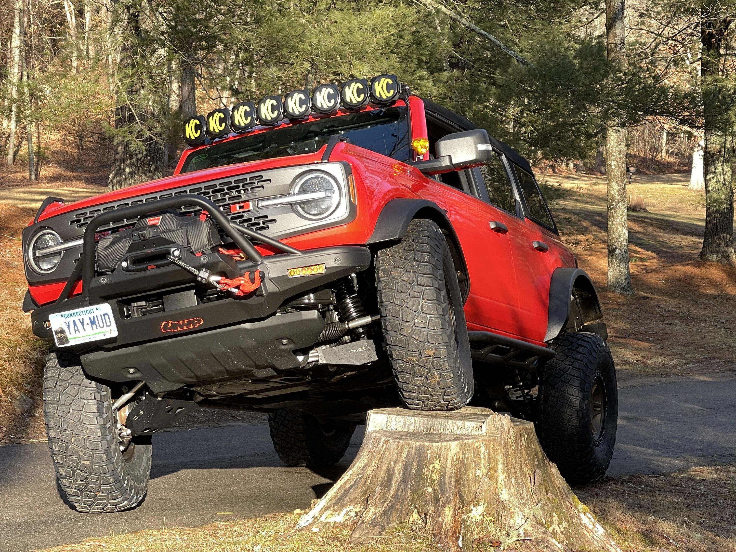

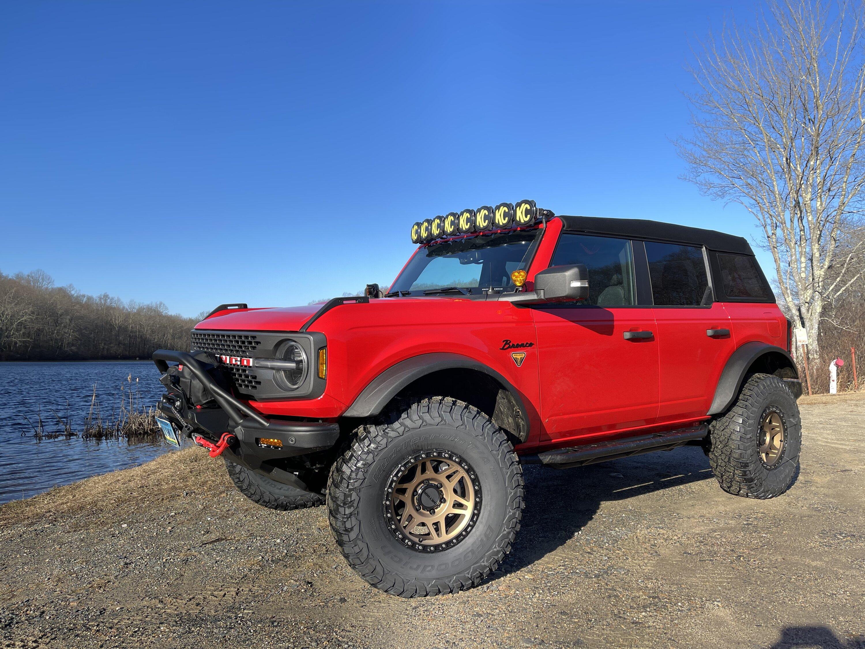

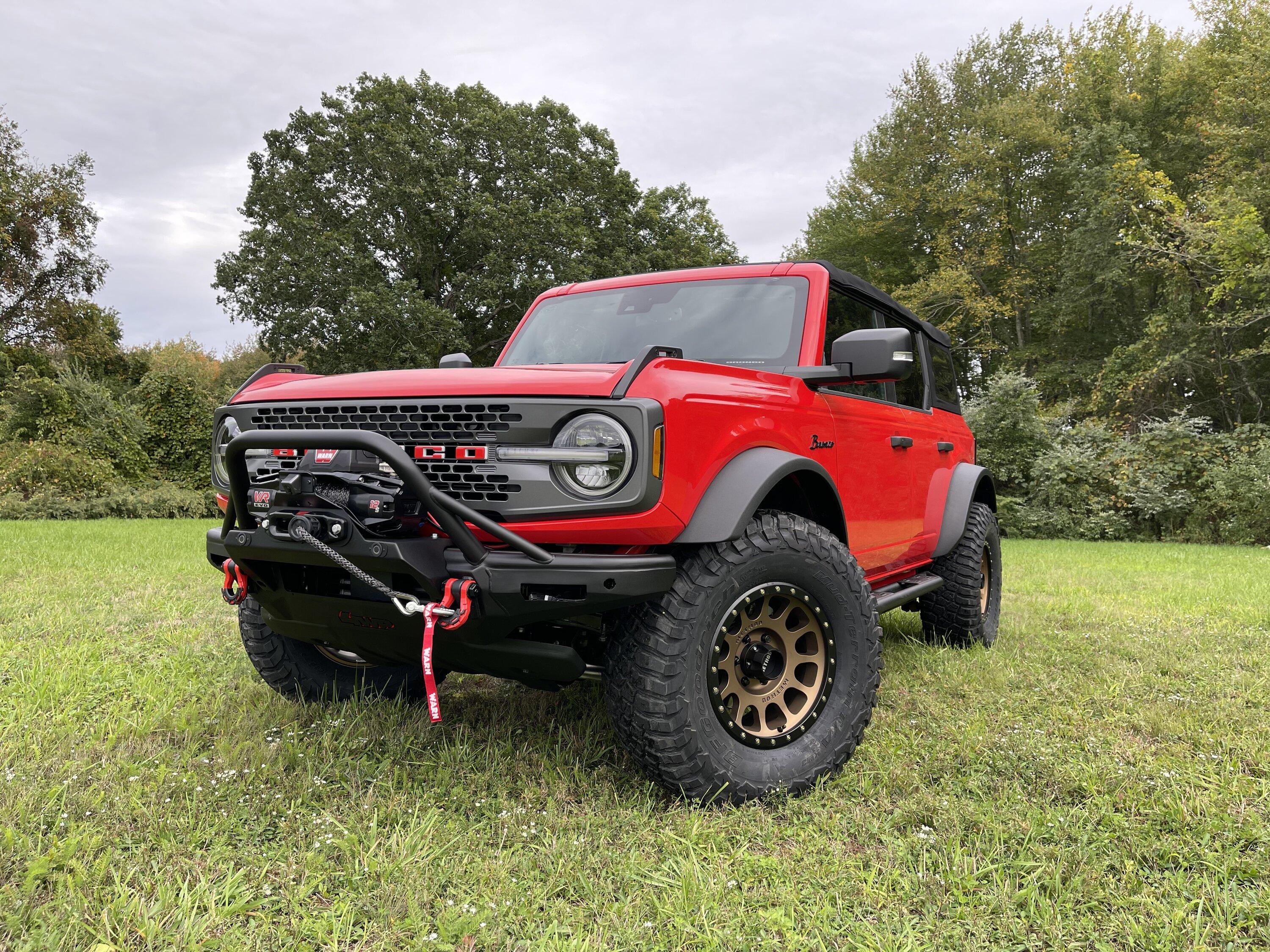

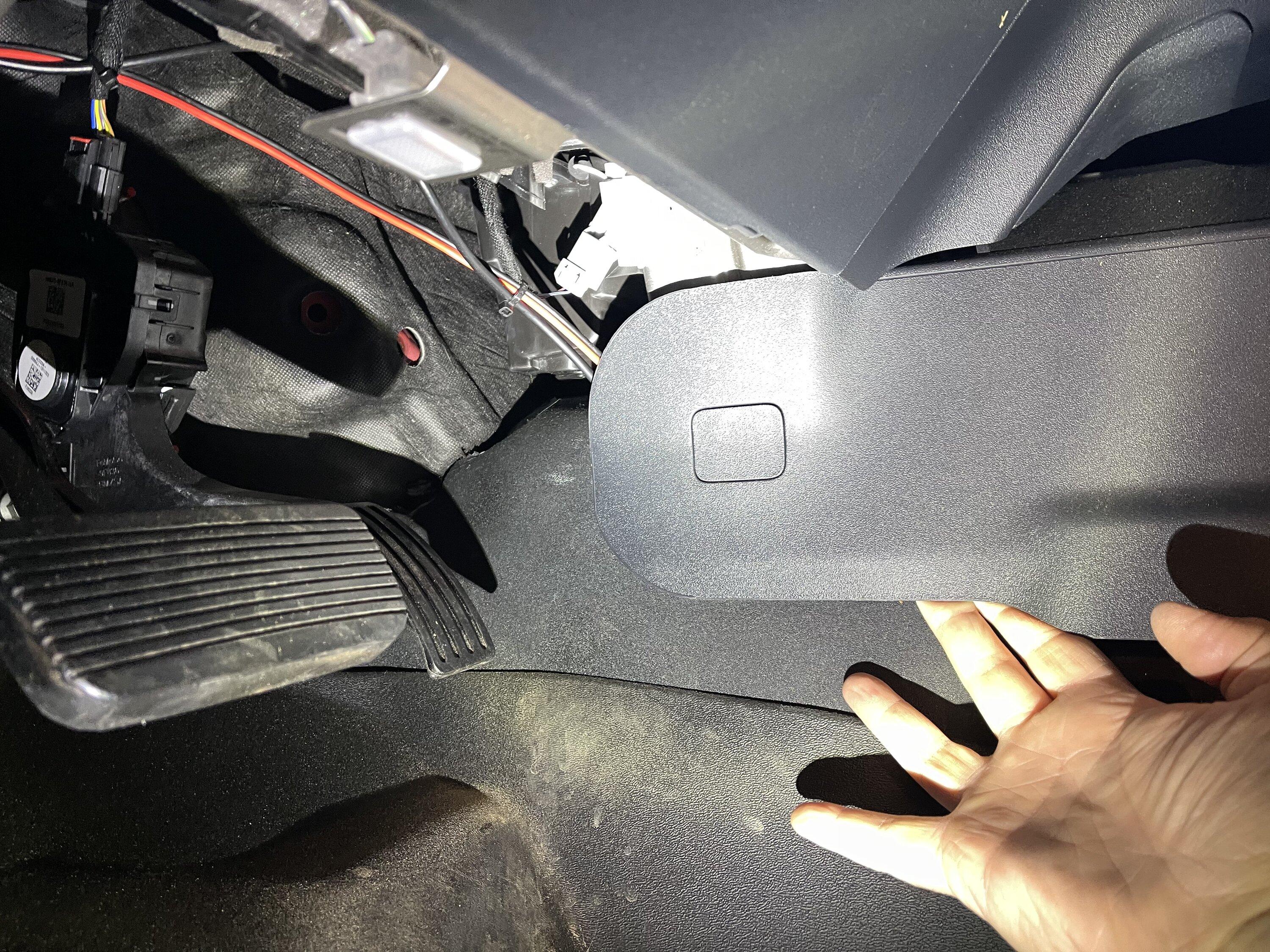

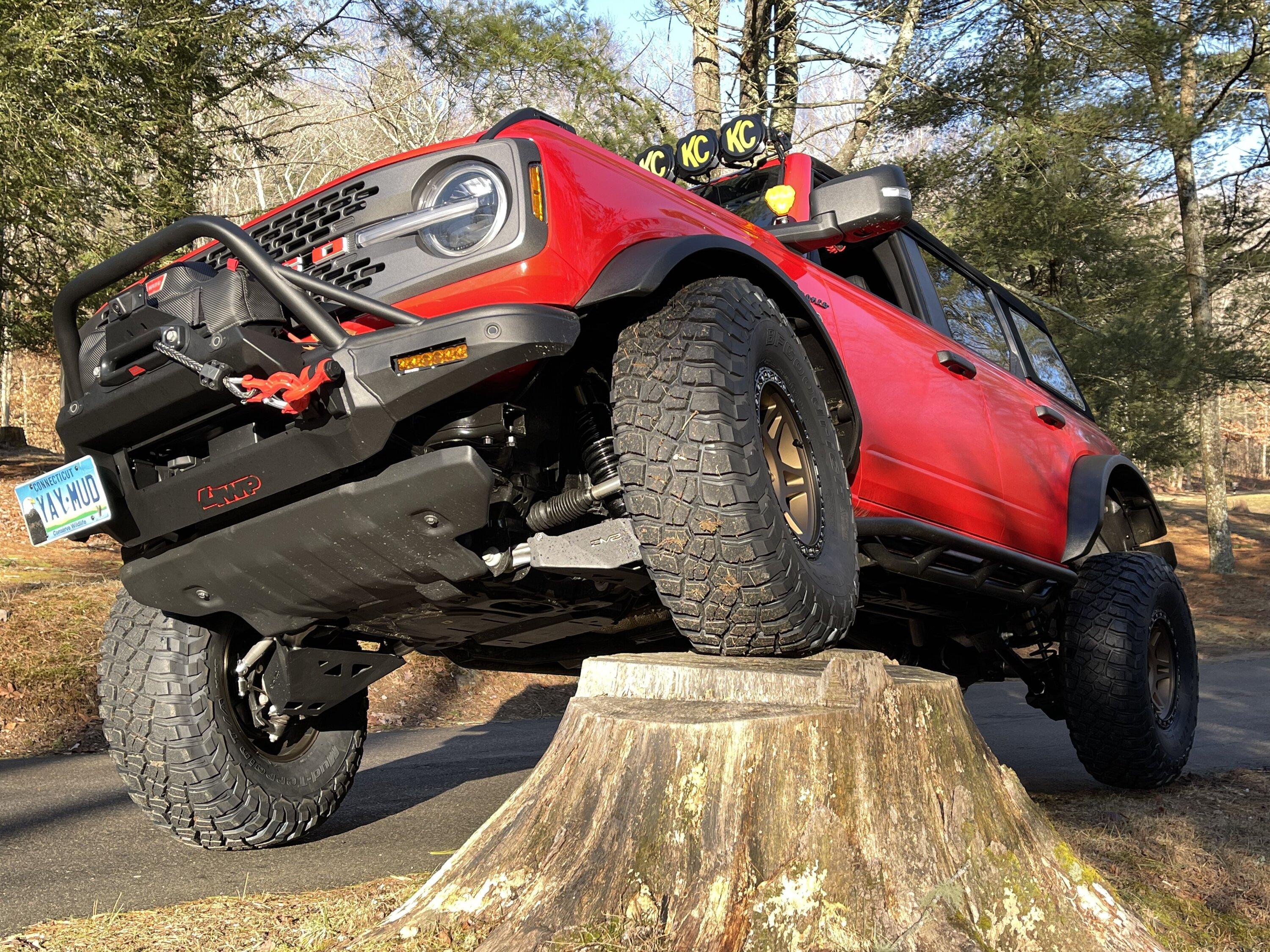

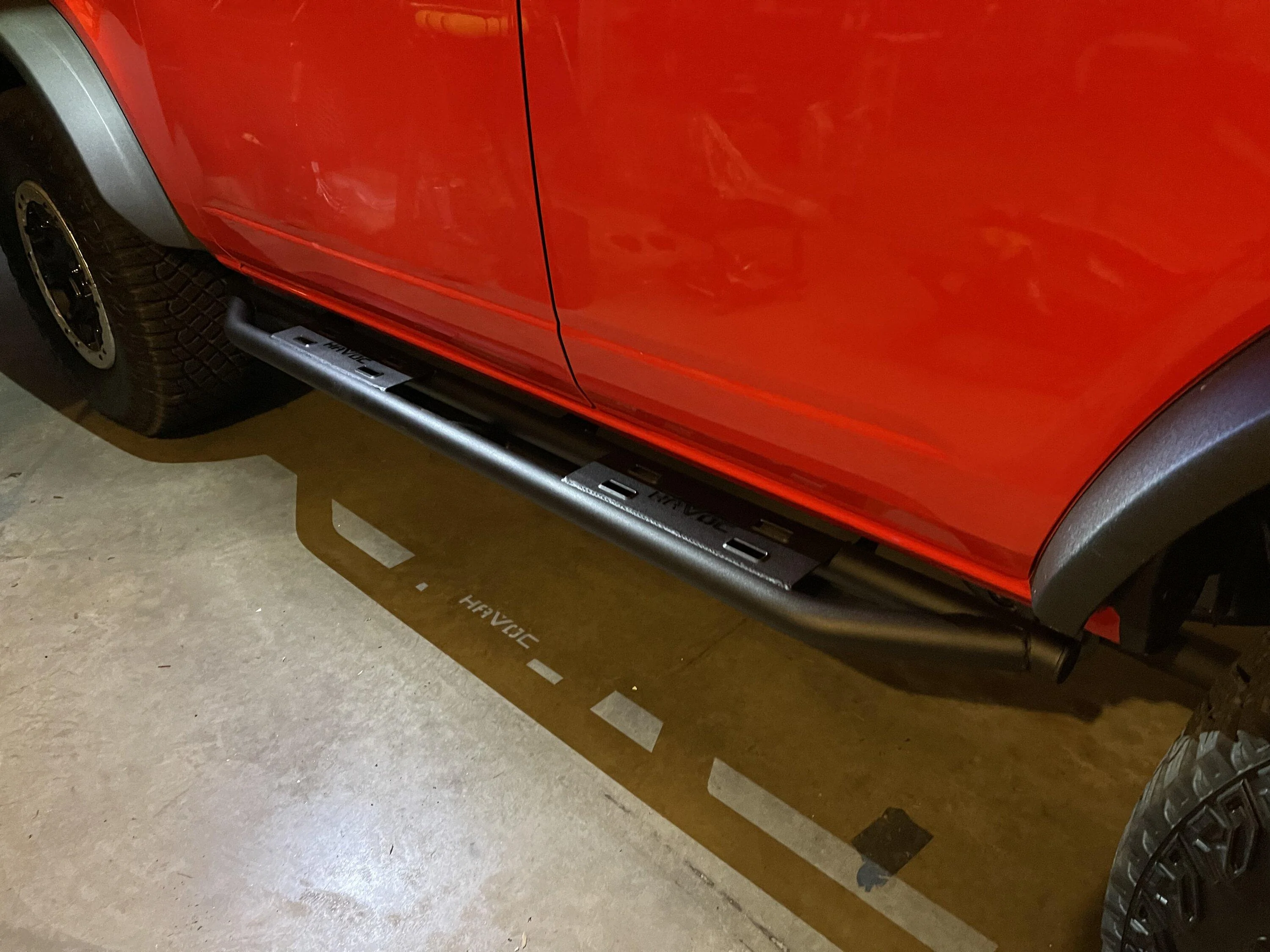

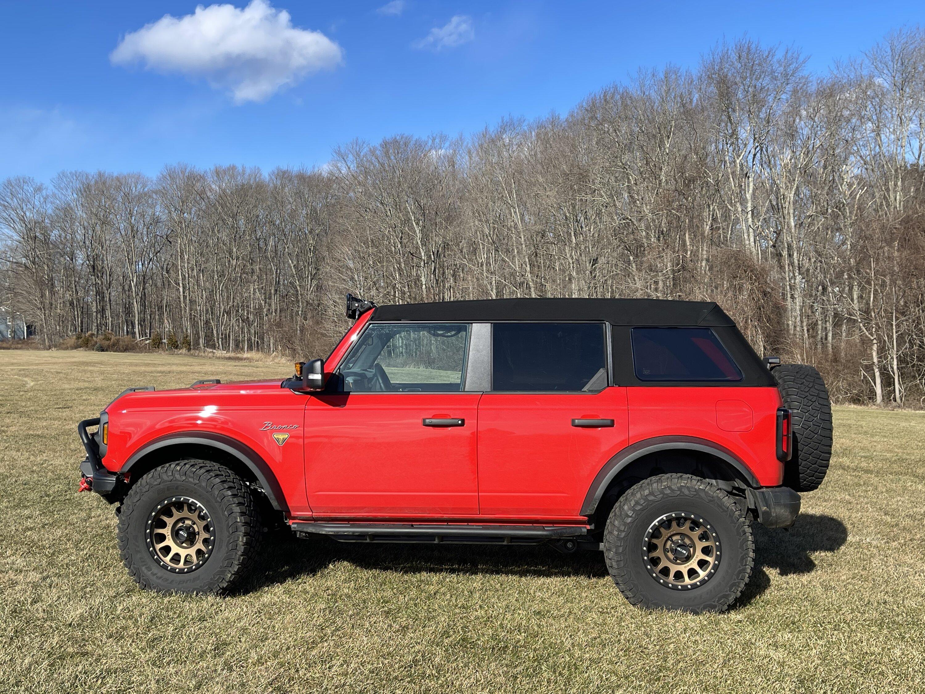

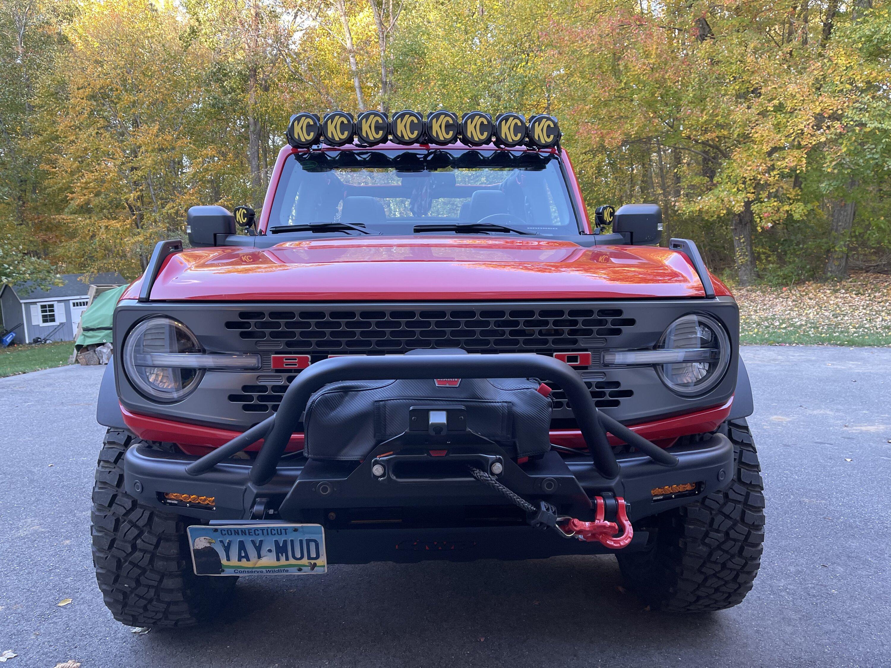

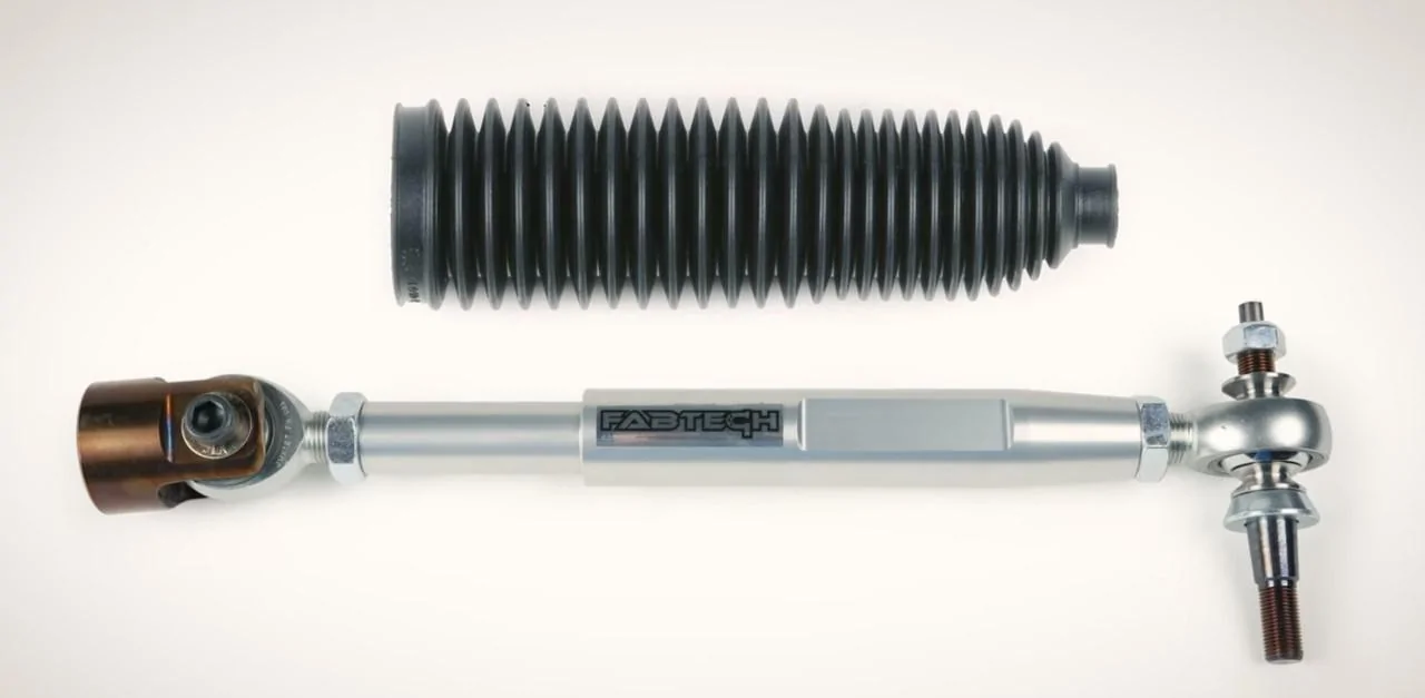

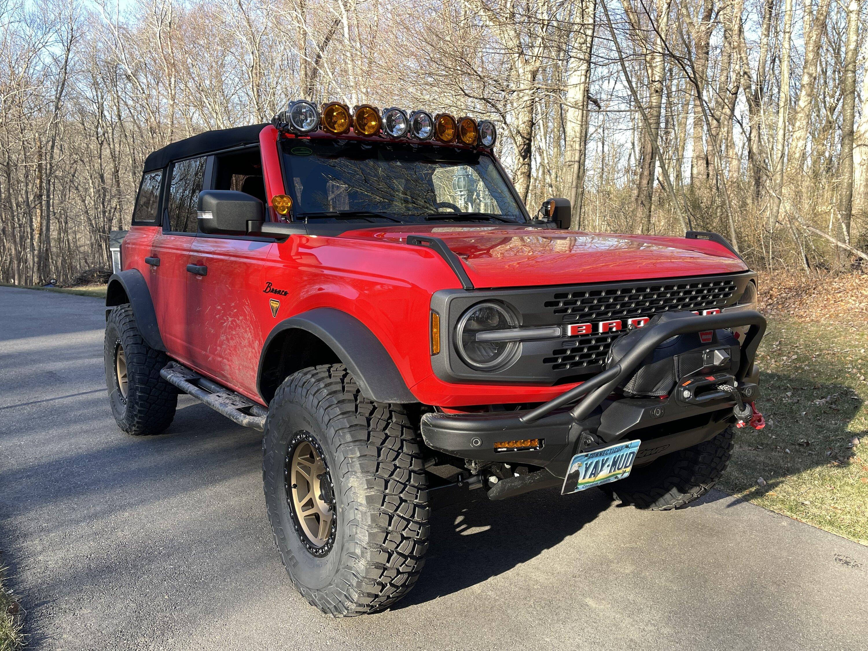

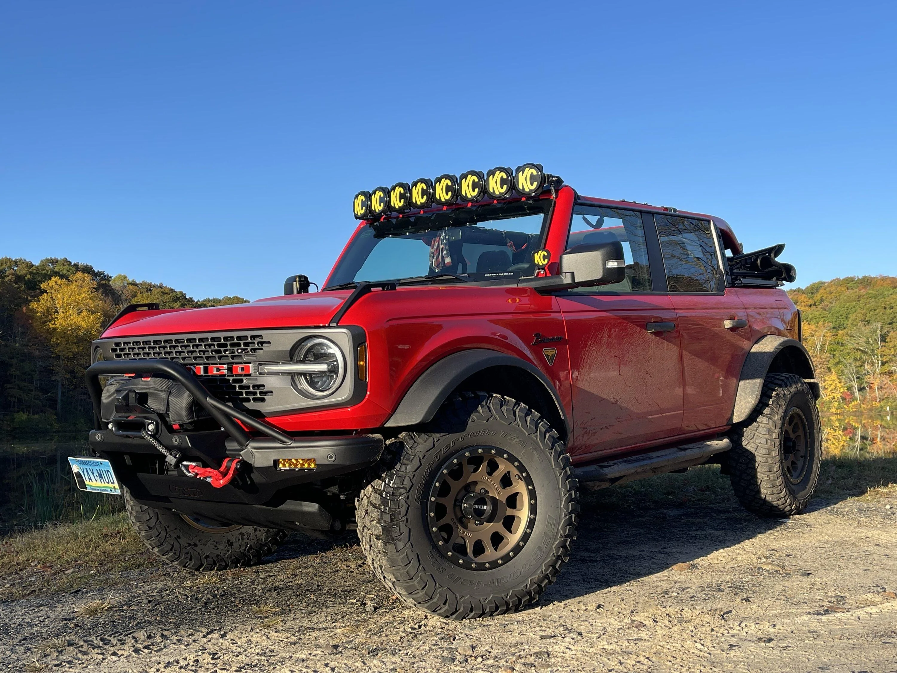

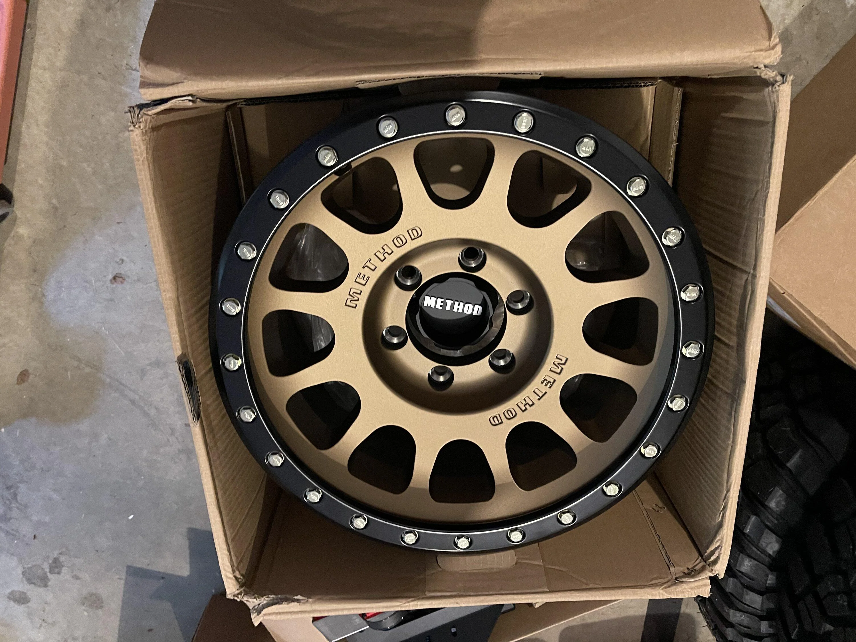

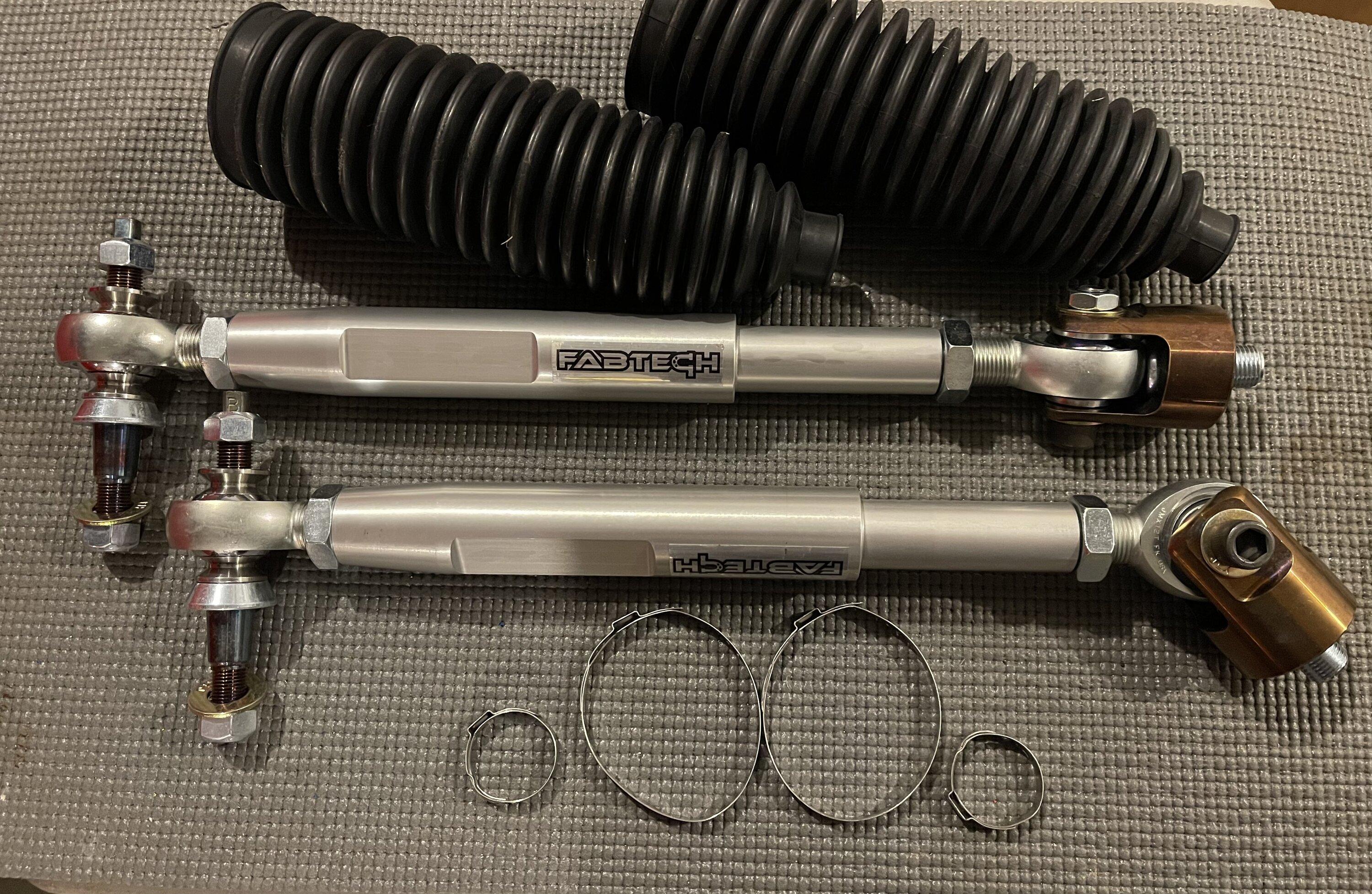

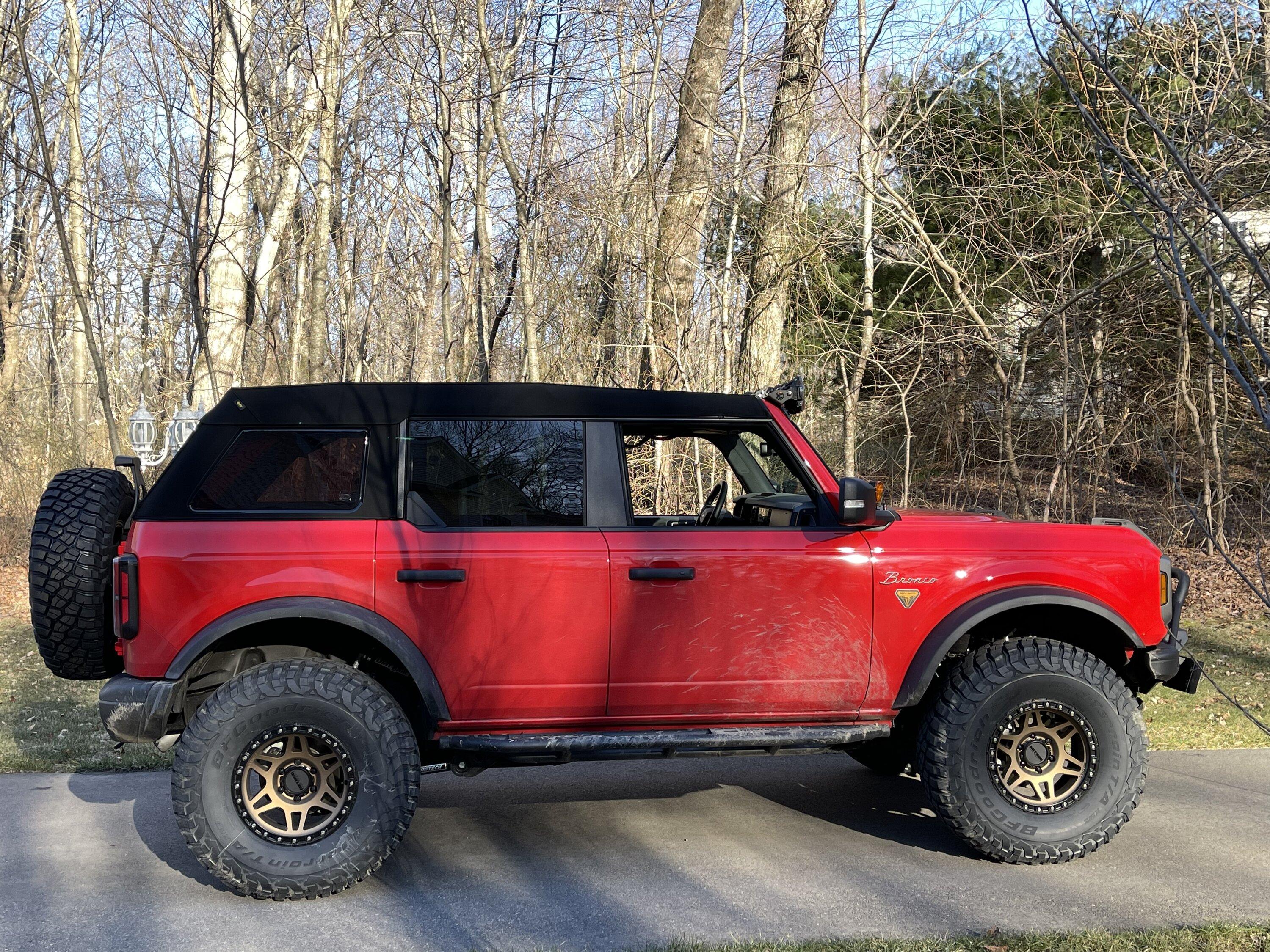

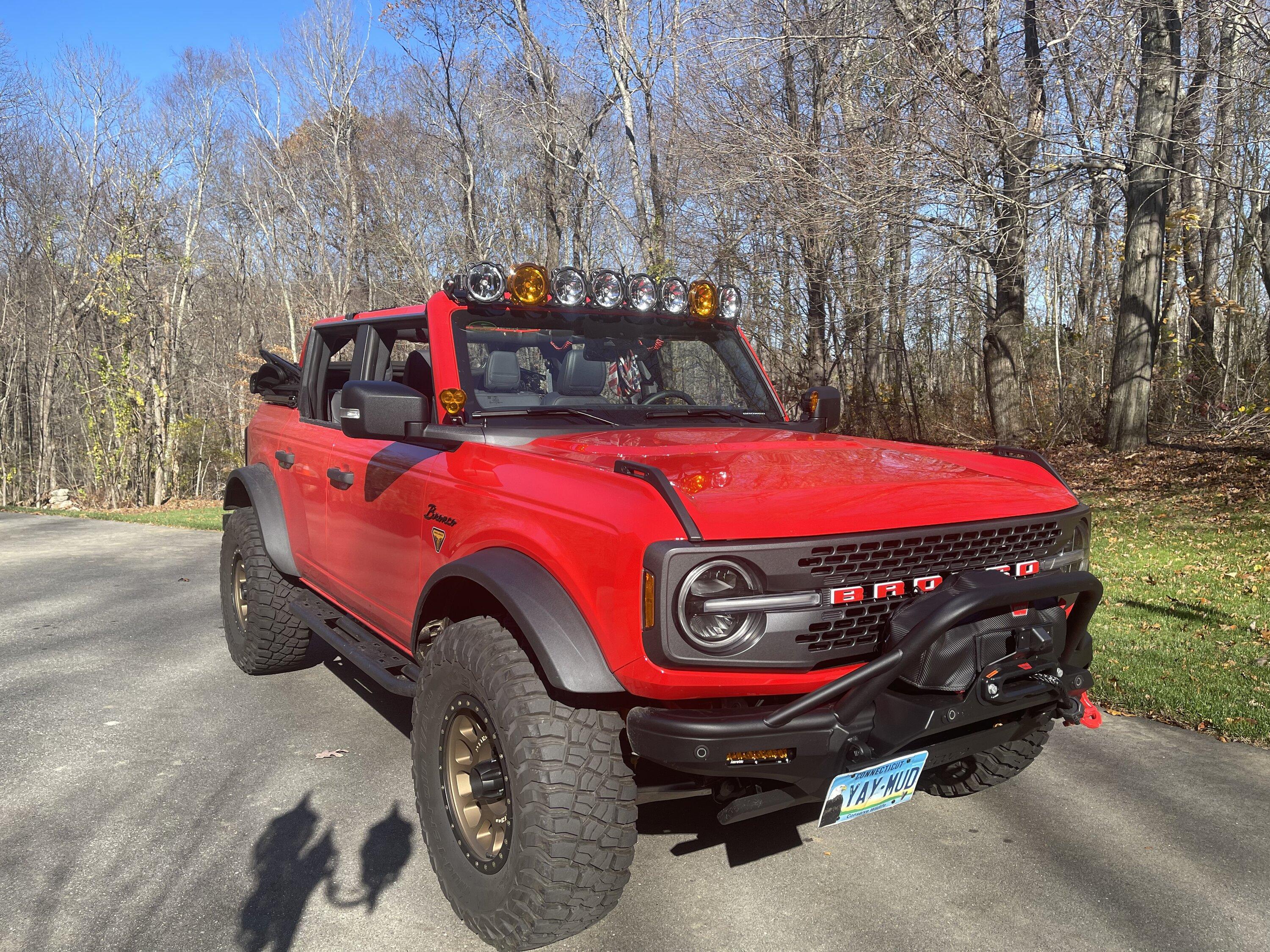

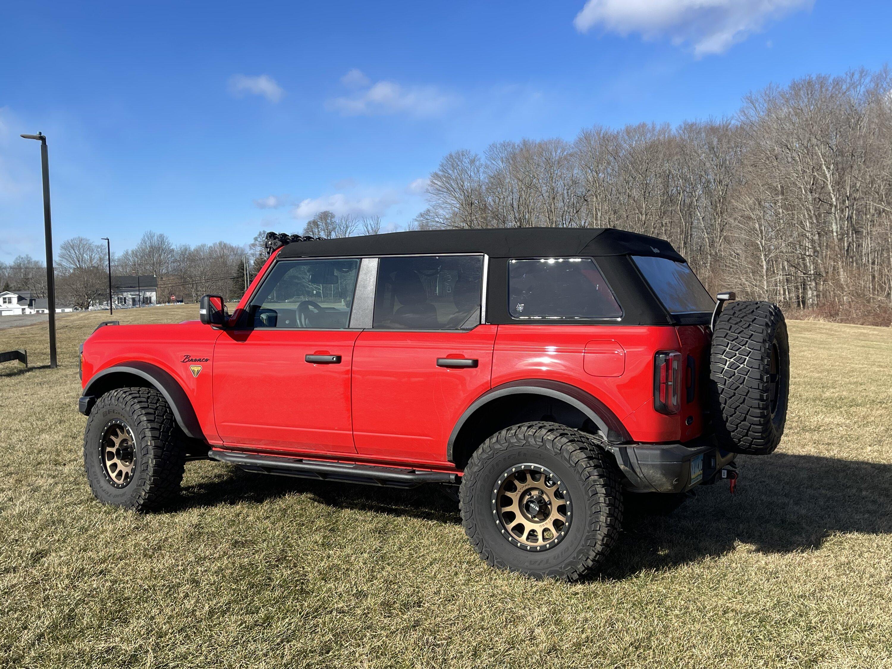

Progress over the last month... In my last post I installed the Bestop Trek Top, Bestop Bikini Mesh top, and a Hidden GMRS radio. (Don't know if anyone even saw the post.) Anyway... over the last few days, I've gone further yet again. Installed DV8 lower A-arm skids, rear shock mount and control arm mount skids, and their rear Diff skid and pocket winch fairlead and hook combo as well. (Which looks great, and I don't have to dangle the hook anymore.) I also removed the rear sway bar, and installed a Fabtech 3" coil-over lift with Dirt Logic Remote reservoirs, Heim Joint tie-rods, and swapped out my 35" KM3's on Method 305 wheels for 37's on Method 312's. I added a second wiring harness to the roof top light bar, so I can operate amber and white lights separately on their own upfitter switches. Still more to come, but here's my last few pics from the recent stuff. Pics of the skids will be added later today... I LOVE the look on 37's and the added capability with the lift! (No rubbing... even when fully flexed!) Coming up... Some little known fender flares that IMO should be way more popular! Stay tuned!

I'm pretty sure the lift is a legit 3" over the Sasquatch. Unfortunately, I didn't measure, but It IS a big difference. Swapping the 35's out for 37's also added another inch. It definitely "feels" like a much bigger rig. Standing next to it, especially in front of it where its quite clearly more imposing. The only part I actually measured was the ground clearance at the forward end of the rear lower control arm mounts, which measures now at 14". I didn't do anything additional to have no tire rub, just added the lift, 37's, and kept the wheel offset at "0", the same as the Sas wheels. I haven't yet stomped on the brakes, so I can't give any feedback there, but I'm sure its a dream compared to my old JK Jeep, which would do anything to depart a strait line when under hard braking. I did notice when going over some speed bumps, it soaks them up like they're not even there. First time I did it I actually laughed out loud. It was like running over a pencil. As for the body roll, it feels the same to me. This is actually a shock considering I also removed my rear sway bar. Even after removing that it feels the same. It's not like I go bombing around corners anyway though. I've had enough big squish trucks over the years to know better.

Do you have the preload set to give you the highest lift possible? Also can you measure from ground, through center of wheel hubs to the bottom of the plastic fender flare on the front and rear so I can get some comparison? Would be super helpful!

I didn't touch the shock preload adjustment. They come properly set from the manufacturer, although, I may dial the front ones up a half inch to an inch to make up for the extra weight of the winch and 4WP Bumper. and the measurement you asked for was 42" at 36 PSI tire pressure.

Update. I did find some rubbing. but its minor and quite addressable. So I found a light rubbing on the front tire at the back crash bar mounting point. The crash bars are removed from the factory, but the mounting point still sticks out. The tire only rubs when the steering wheel is at absolute full lock. This is a very simple fix. Just make a small adjustment to the steering stops, and that should take care of it. It likely won't even make a noticeable difference to the turn radius.
