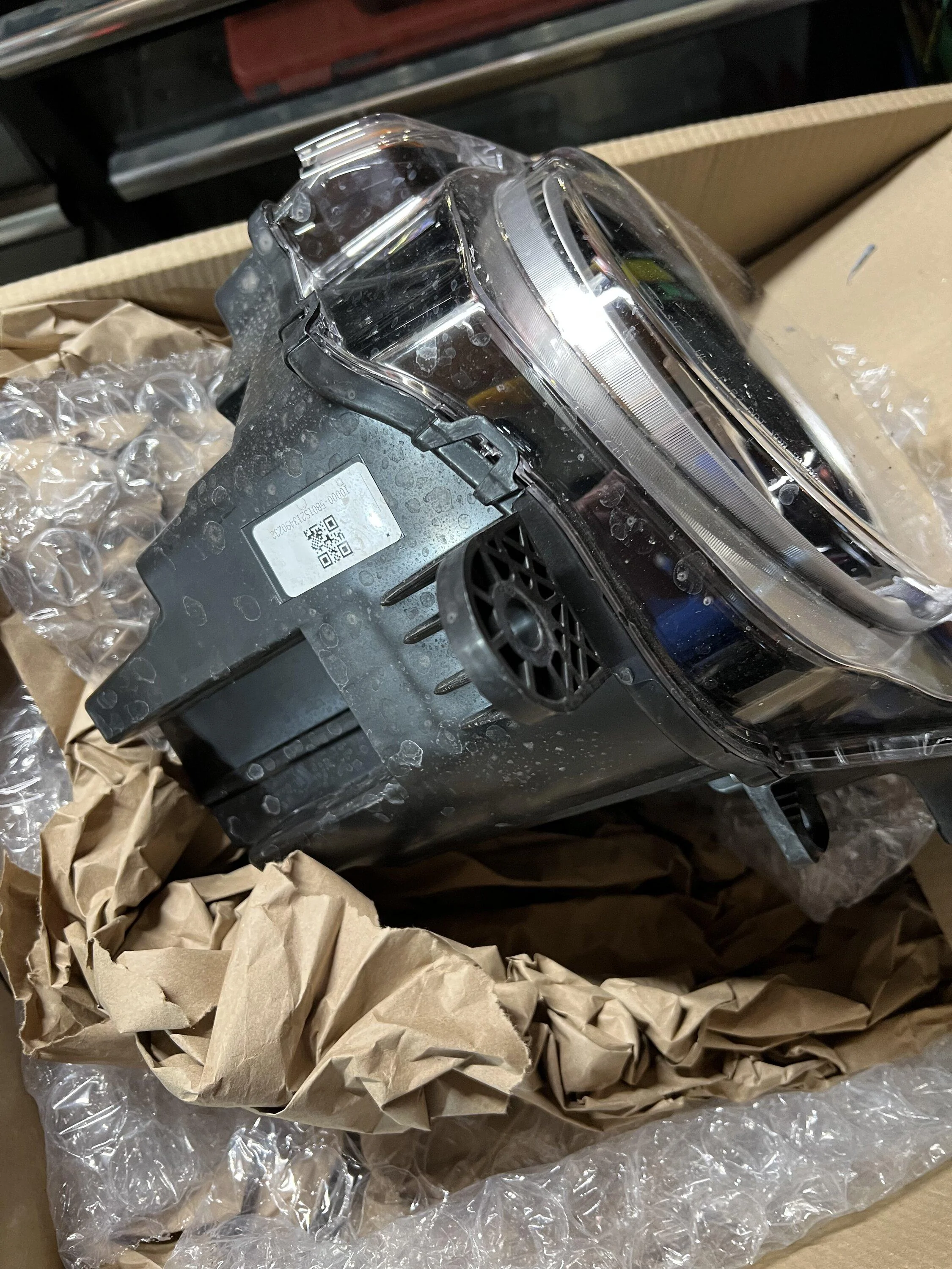

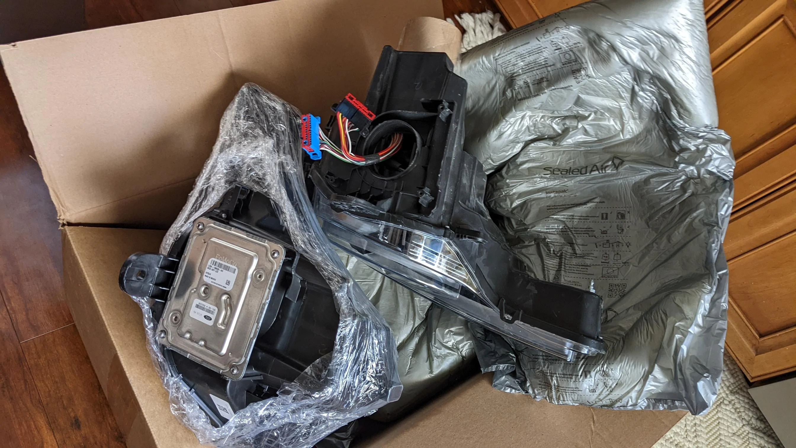

As mentioned in this thread, https://www.bronco6g.com/forum/thre...t-installed-on-big-bend-bronco-w-o-led.28729/ there's a couple of guys who swapped in sig lights to their Big Bend. I decided to do it also, and I bought two used signature headlights from ebay, one with control module and one without. If you look at the pics, the one in the upper part of the pic is missing the silver control module.
Since RDavis was able to just "plug and play", does that mean the factory control module on the standard Big Bend light will be usable as a control module on the missing one? Or do I need to find the same kind of control module that's on the complete sig headlight (in the lower part of the pic)?
I guess I could take out the factory light and see if the part number on the module matches the one on the sig light, but I might be able to avoid taking out a light just to look at a part number. I want to make sure I'm ready to put these in before I start taking my grill, etc off.

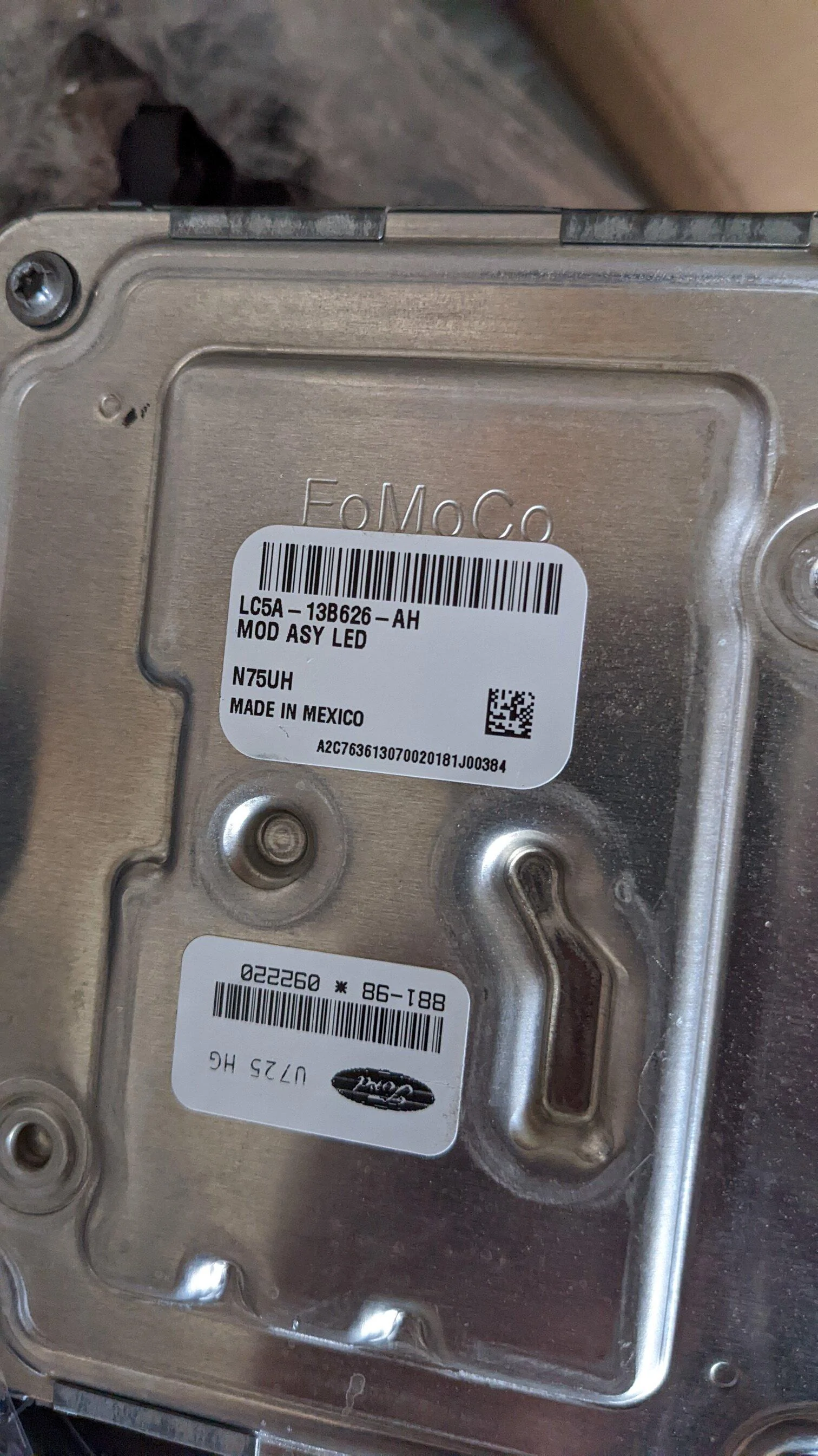

Here's a pic of mine from the first sig headlight I bought. This headlight works
I bought another headlight without the control module so I got one from a Ford parts dealer. That one was unprogrammed and even a Ford service department couldn't get it to work. I think that was mainly because the technician didn't know how to do it, but they say there was a problem with it.
I ended up having to buy a whole other headlight with the module intact. They pop up once in a while on Ebay.
Here's a link to just a module on Ebay, but this has a different part number than mine. Might be worth a shot for only $149. If you get in touch with Lakeland Ford parts, and run the part number by them they should be able to tell you whether or not it's valid. It's possible the part numbers are different between Badlands and Outer Banks (or any other trim level with Sig lights). The guy to talk to there is Kyle who is super-helpful. I won't post his direct email here, but if you private message me I'll give it to you.
https://www.ebay.com/itm/403836518731?hash=item5e0688414b:g:Tb0AAOSwuMRi-84h&amdata=enc:AQAHAAAAsFNneA3SdeeiLsmLduC3ac/pEfT9bGILAOzABSMPrb+XljvKcp7mWkqWLTbk2km4rcINyX0R0fTtuGAhhkgGvTWYO92EGLew/mayJY3iaLVyfxzRf7zejqdnCiTBXHugmjsRyzbaqyzS1SS1RggQcRtSEr4e0nJXeG4XjHqJ31H+Y7kHZXG9QceApftn8IpX61GA4T0nG1W985OttDsmMGuyp1vTaMA3vzFavU2/eN9g|tkp:Bk9SR_Csn-PVYA
My advice to anyone wishing to install sig lights on their Bronco is to get one with a module intact. Without it, the light is useless unless you know how to program a fresh control module. Maybe it can only be done at the factory.
My lights works great now, but it was a little bit of an adventure to get there because I bought one without a module.
