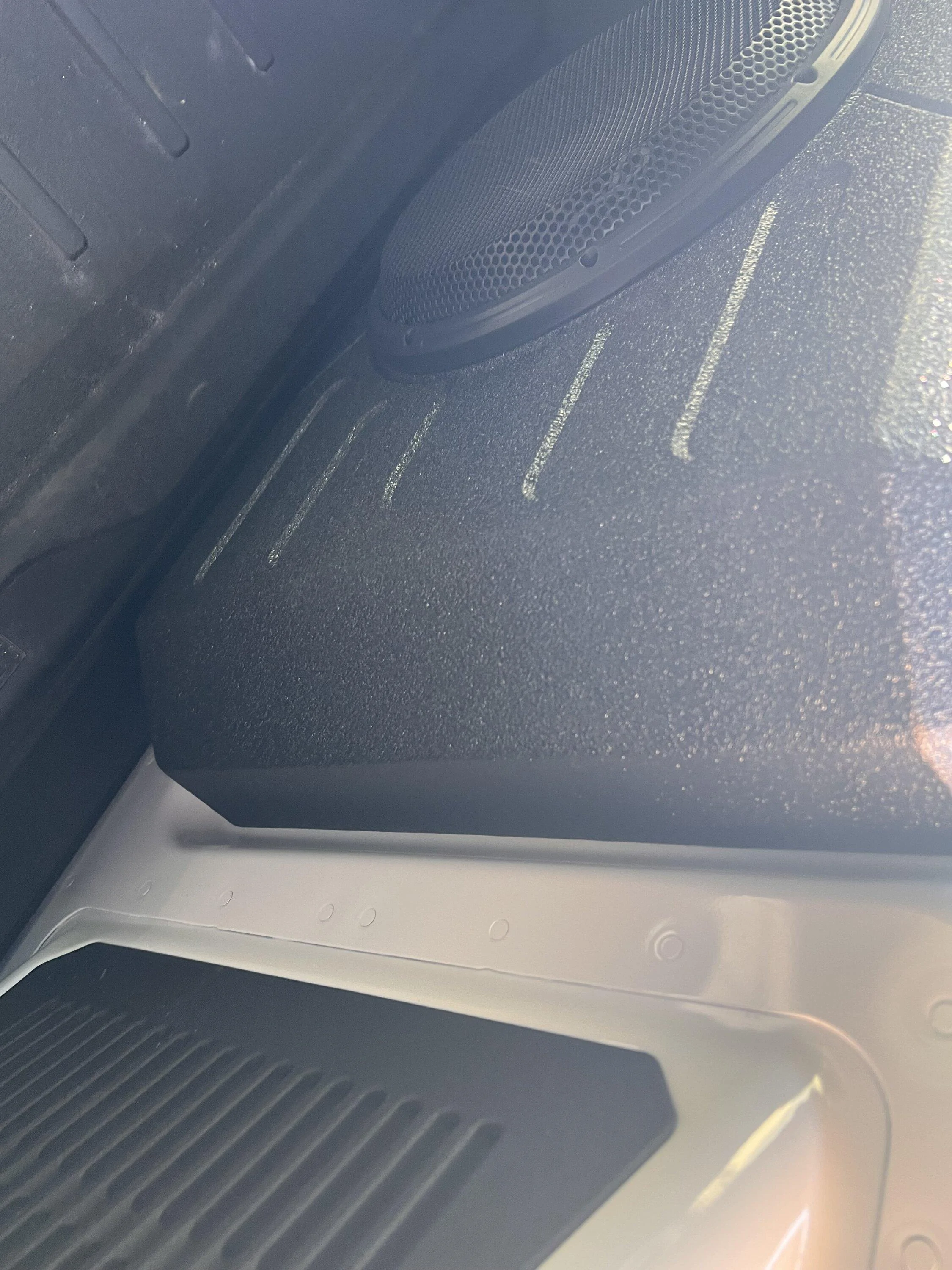

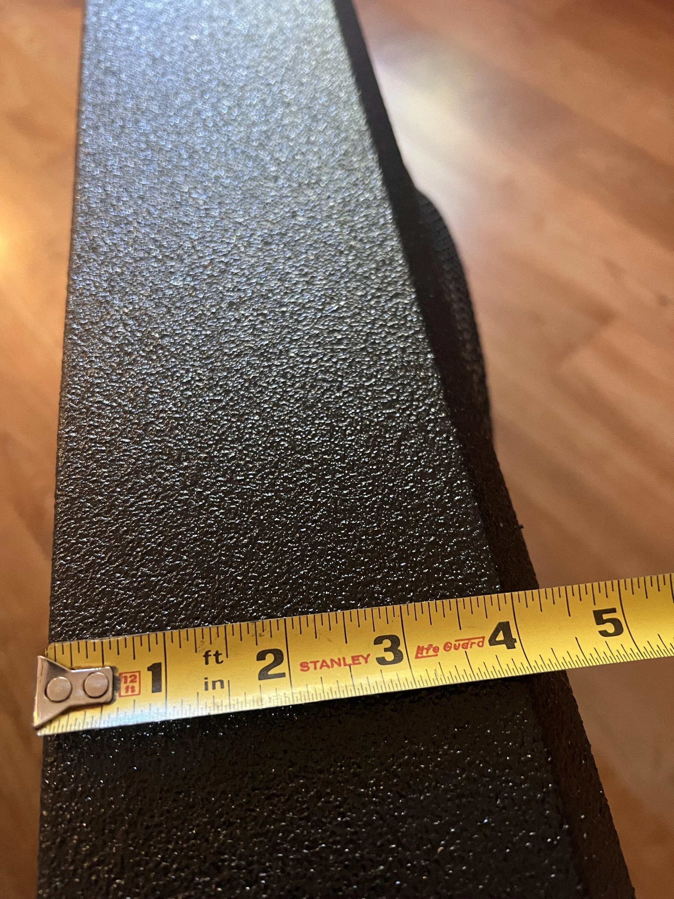

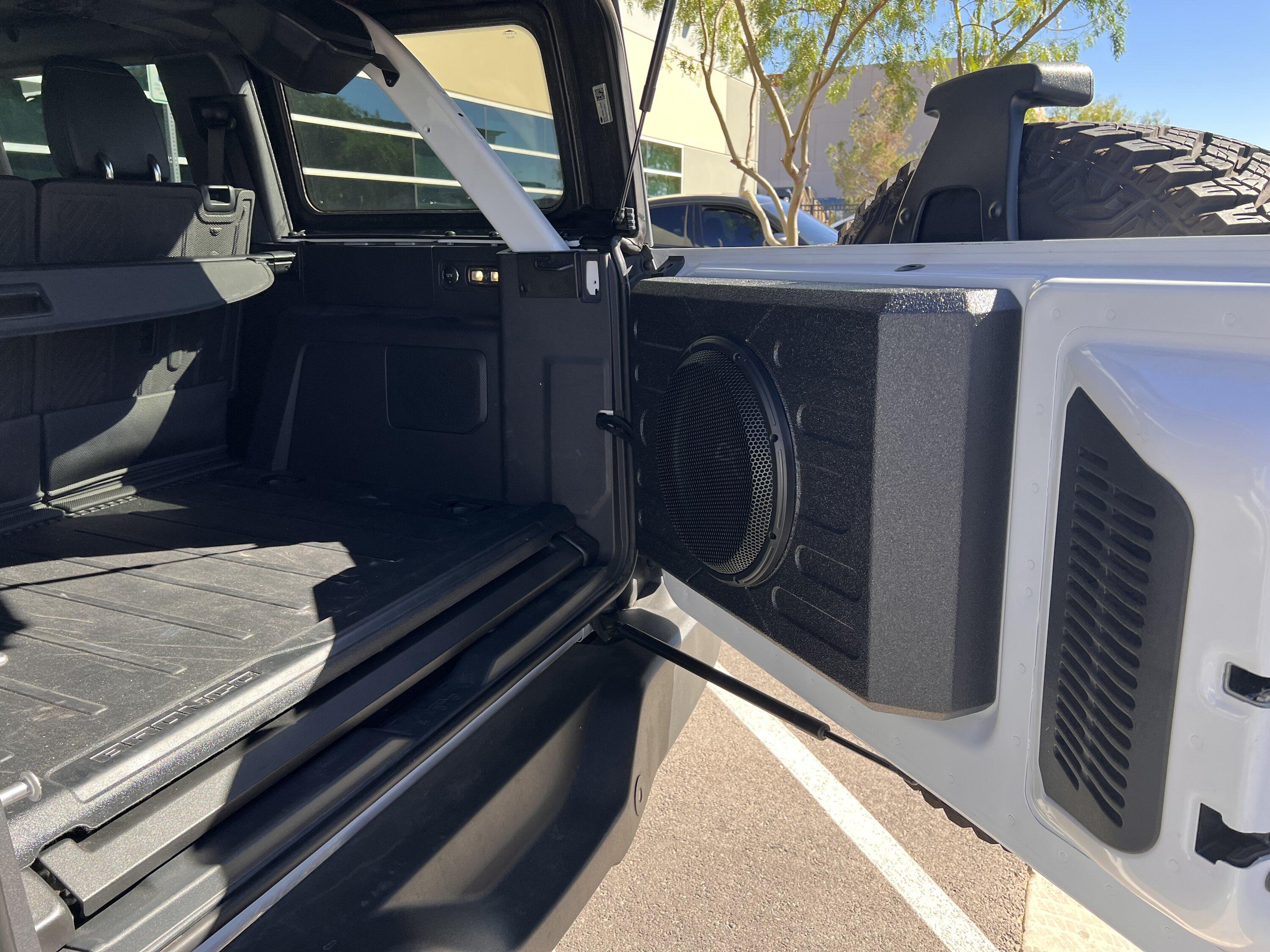

Ford Bronco Stinger 12” tailgate sub and pull-out tailgate IMG_0935
Ford Bronco Stinger 12” tailgate sub and pull-out tailgate IMG_0951
Ford Bronco Stinger 12” tailgate sub and pull-out tailgate IMG_0949
Stinger fits perfect with pull-out tailgate installed. Sounds so much better too!!! So needed this!
