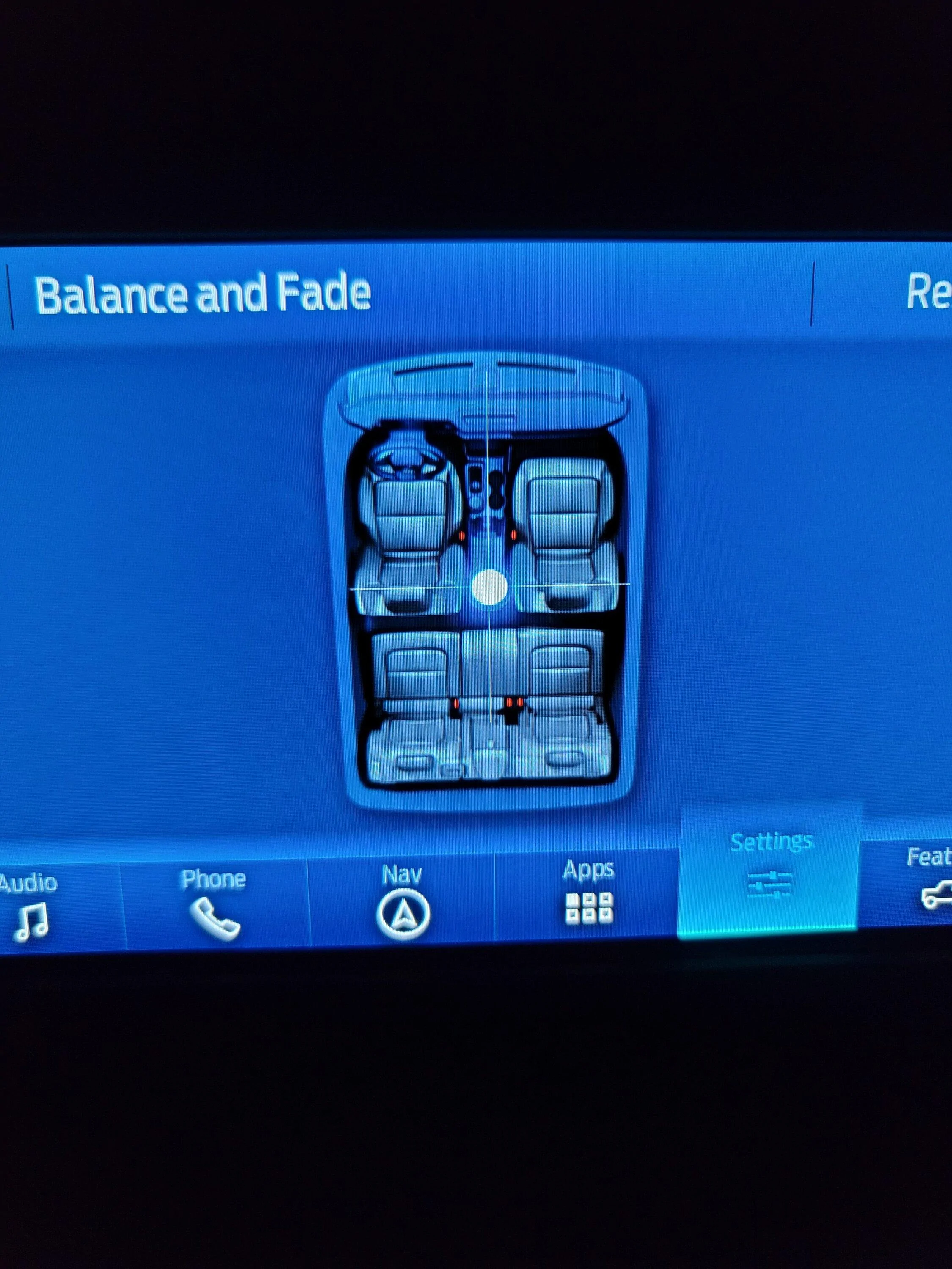

Moved fader up front..stereo sounds better..lol

I went with kicker amp and kicker speakers. 6.5 in the back with the Mabett pods. Used Bass blockers on all. Did some Forscan adjustments, happy with it, didn’t want a sub but all that is a personal preference. The factory set up is junk. I have my fade a litter farther back due to the aforementioned and happy.
