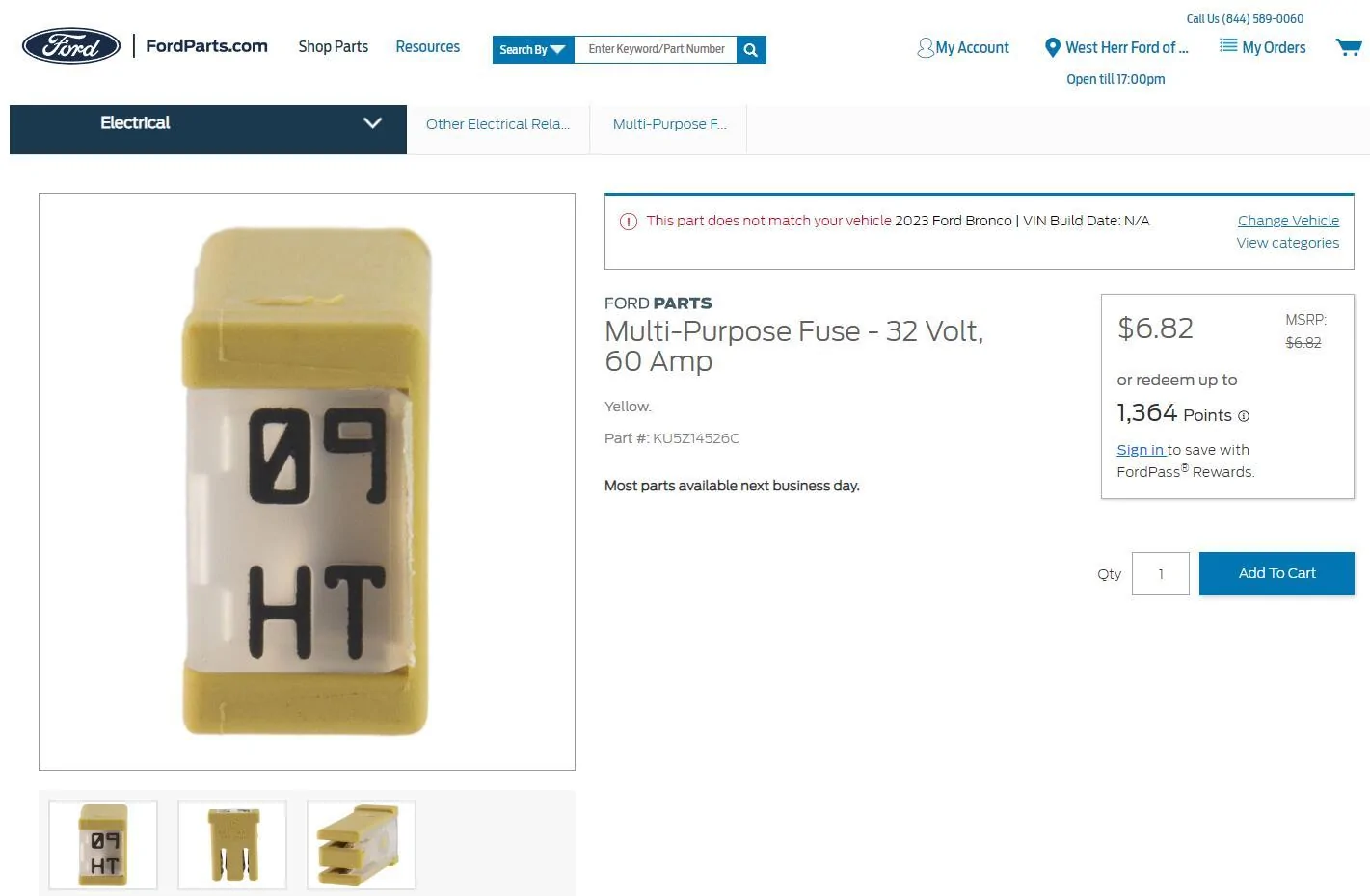

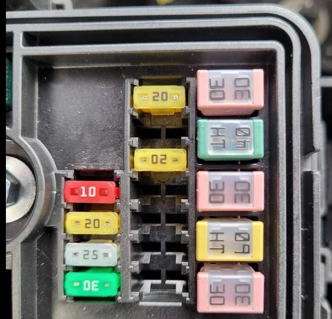

I am looking to purchase some spare fuses. The 40 and 60 amp slotted fuses in my Bronco are labeled as HT (High Temp, I believe). When I look at Fordparts.com it says the HT fuses don't match my vehicle but the non HT fuses do. Any idea why this is and is it ok to use the non HT fuses? Any assistance will be appreciated.

The first photo is my engine compartment fuse box. The 20 amp fuses are micro 2 blade fuses. The 40 and 60 HT fuses are MCase slotted style fuses like in the second photo from FordParts. I am just curious why my fuses show HT and FordParts says those aren't compatible with my Bronco yet the non HT ones are.

Littelfuse makes slotted MCase + fuses in both HT and non HT. This is what they say: MCASE+ High Temperature (HT) have a lower voltage drop and are designed to operate with a lower temperature rise in harsher environmental applications.

That said, I still wouldn't bother over the HT designation - the Littelfuse description you found is plausible, I have no reason to not believe it. But I still can't think of any reason why the Bronco would need those in particular. Amps are all that really matter there. HT fuses sound like a "premium" upsell, and wouldn't be worse, but so long as you are matching the amp rating, I don't think they would necessarily perform any better either.
