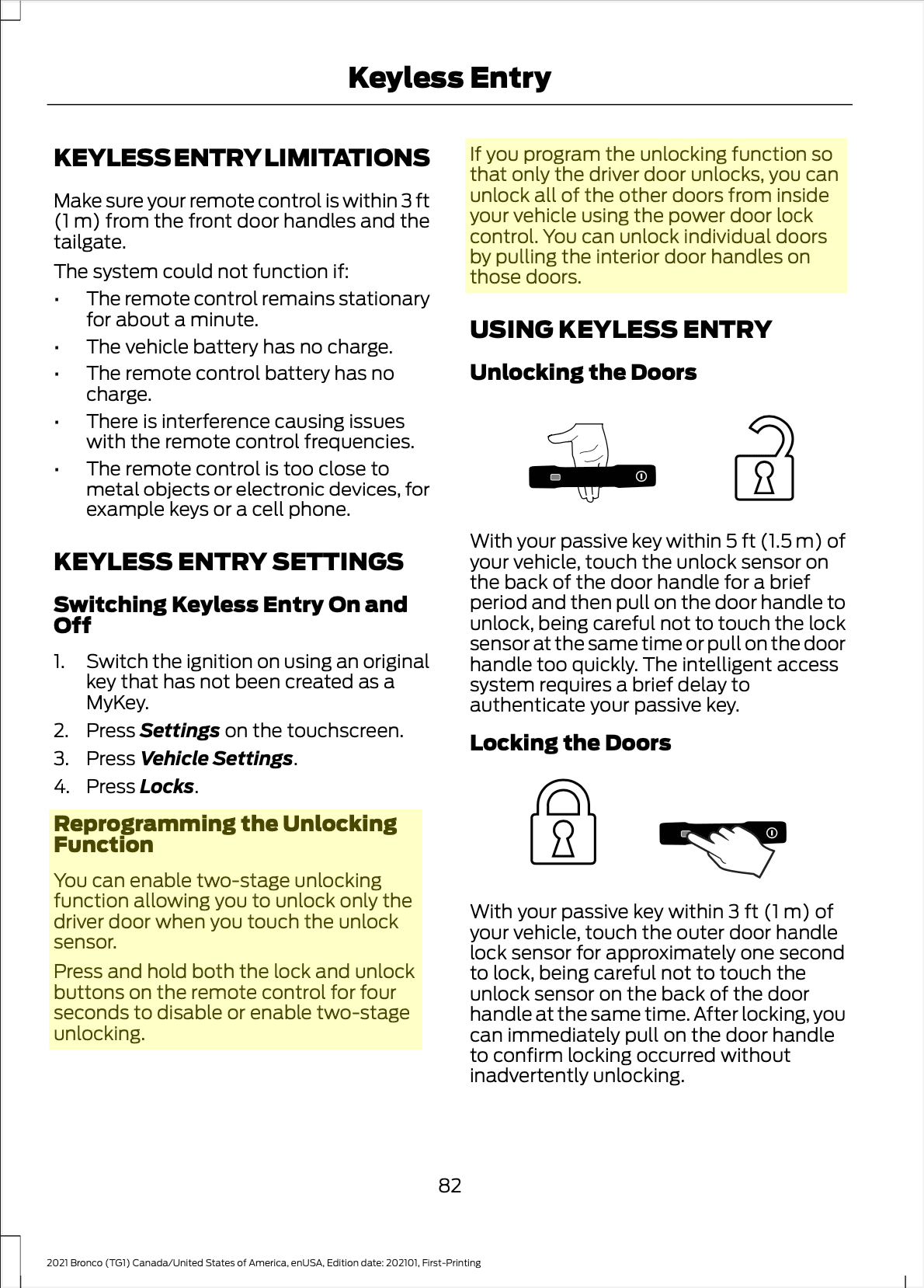

My guess is that you would have to turn the Bronco off, lock all the doors and then open and close each door individually from the inside, before getting out. That should theoretically leave each door unlocked and the rear door locked. Might be a pain in the butt. But also I think if you just did the front 2 doors that would probably enough. I don't see a thief trying only the back door and not the front thus leading to them cutting the top. Also maybe there is a way for Forscan to accomplish what you want.

Just tested that out. It works perfect! Thanks!

So, isn't there a door unlock button in the console? Once in the truck, can't the tailgate (and all doors) be unlocked with the button?
Damn! Thanks for ruining it for me. I didn't figure it would unlock without the key inside or nearby. Safer with the doors off since the unlock button is on the door.

Not sure about the Bronco, but after a certain amount of time on some vehicles, the interior electronic door locks (which are on the doors, not on the console) are deactivated. This prevents someone from snaking in a wire and hitting an unlock button to gain access to the vehicle.
In this case, you could leave the doors unlocked (or the windows down, or some of the doors off), but still lock the vehicle with the fob, securing the cargo storage cage, but allowing someone easy access to the interior of the vehicle.
The other reason why one should lock the vehicle (with the fob) is that it activates the anti-theft system. The system interprets the lock request as a "and don't let the engine start until I come back and unlock/disarm the system first."

OK. Guess I'll have to play with it once I get mine (next week??).
