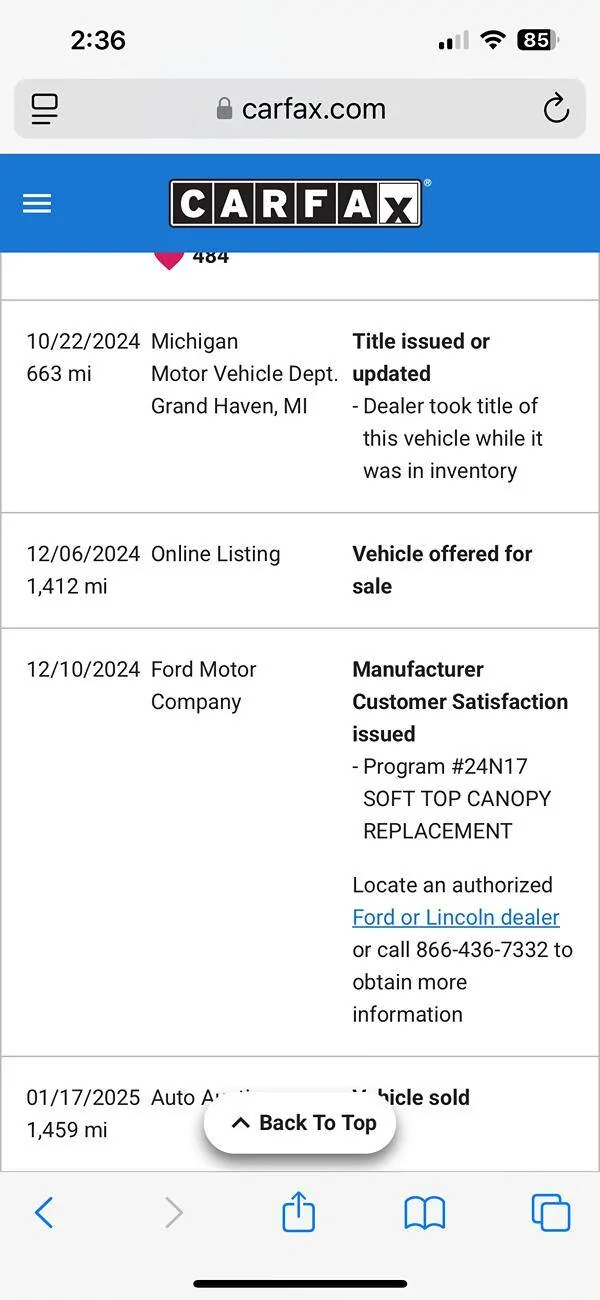

Saw this on a carfax for a 2024…guessing the same thing?
Ford Bronco Soft top liner separating IMG_5367
