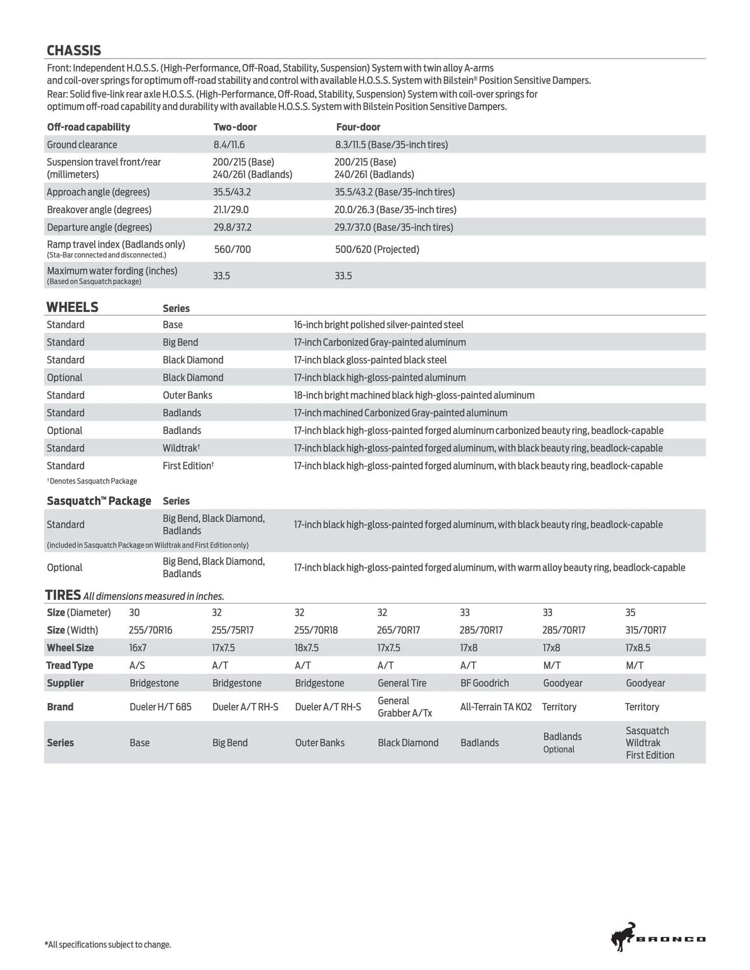

If the 33 ATs are BFG KO2 they will be better for noise.
How can we know that which Trims would come with BFG or Goodyear?
BroncBro
1,658
6,198
2019 Tacoma 4x4
A good guess would be that if it said all terrain, it’s BFG. If it says mud tire, it’s Goodyear. Also the size matters. Only 33s and 35s
