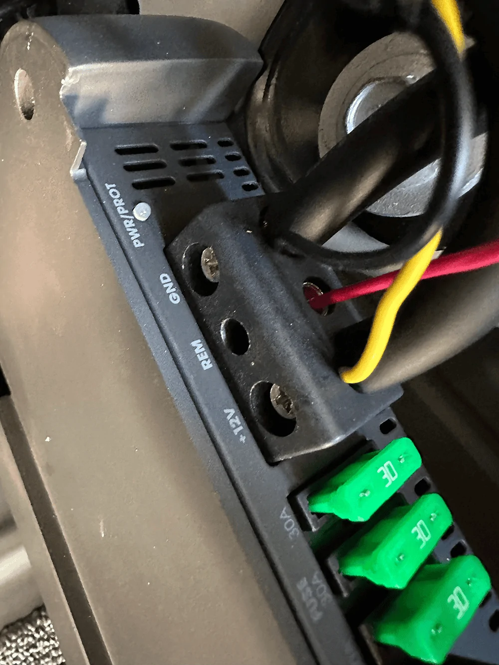

What is that red cable that's plugged into the remote line from???
Same question - what is your red, remote line wire connected to? And is your turn-on mode switch set to DC or REM?
I have the same amp in my Tundra and have had no issues like you describe.
Red wire comes from DSP. DSP power wire comes from somewhere near the head unit. I'm taking that apart tomorrow to find out. Original Installer has since quit so I'm on my own. I screen print and did a lot of trade for this and the system sounds amazing so if I can just get it to shut down completely when it's done it will be awesome.

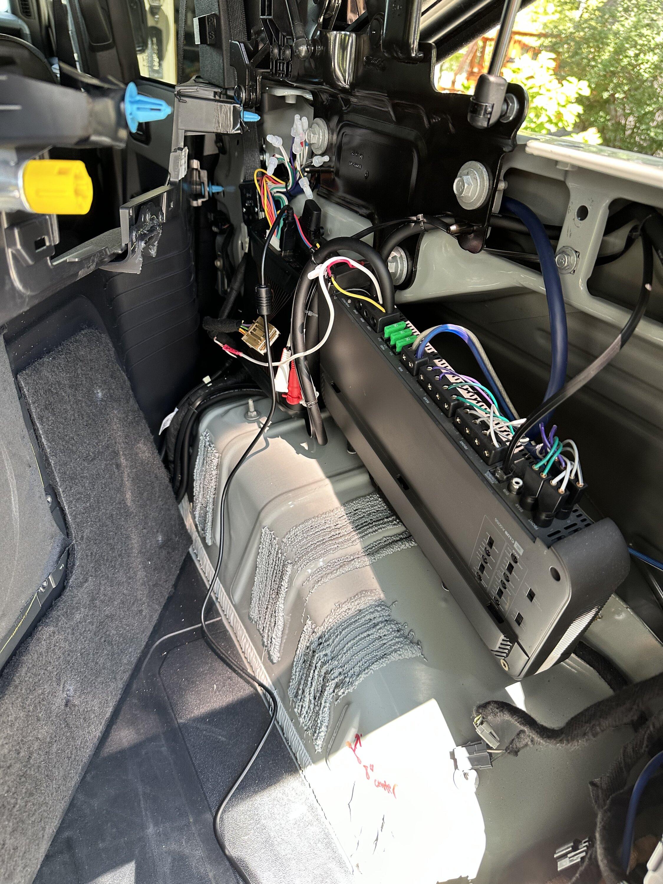

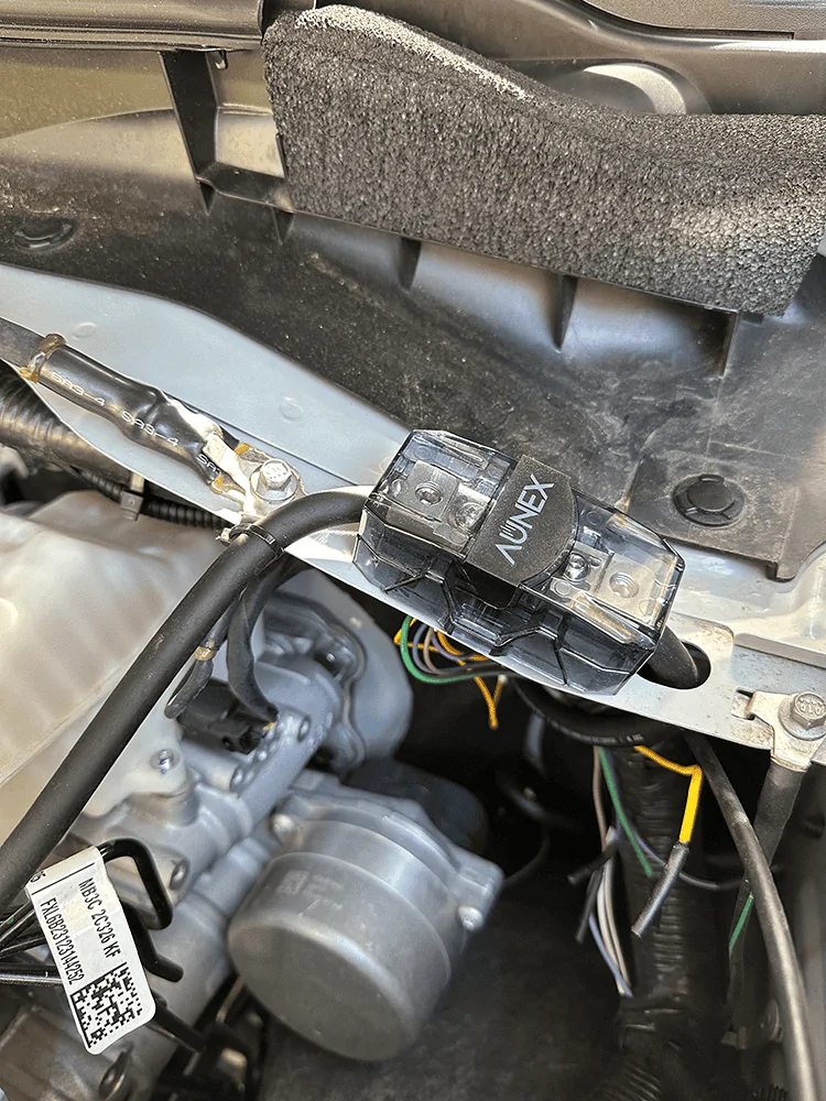

I took everything apart to figure it out. The system is basically completely rewired. The power actually goes straight to the sub and runs out from there to the DSP. If anyone would know if I could find a kill switch that I could hook up to one of the aux switches and put right before this fuse I could shut the power off of the entire system manually.

I ended up using the white/orange wire in the right-hand rear quarter panel and hooked it up to the remote in the amp. Then connected the white/orange behind glove box and ran it to Aux 6. Now I can just shut the amp off with Aux 6 and the thumping is gone.
