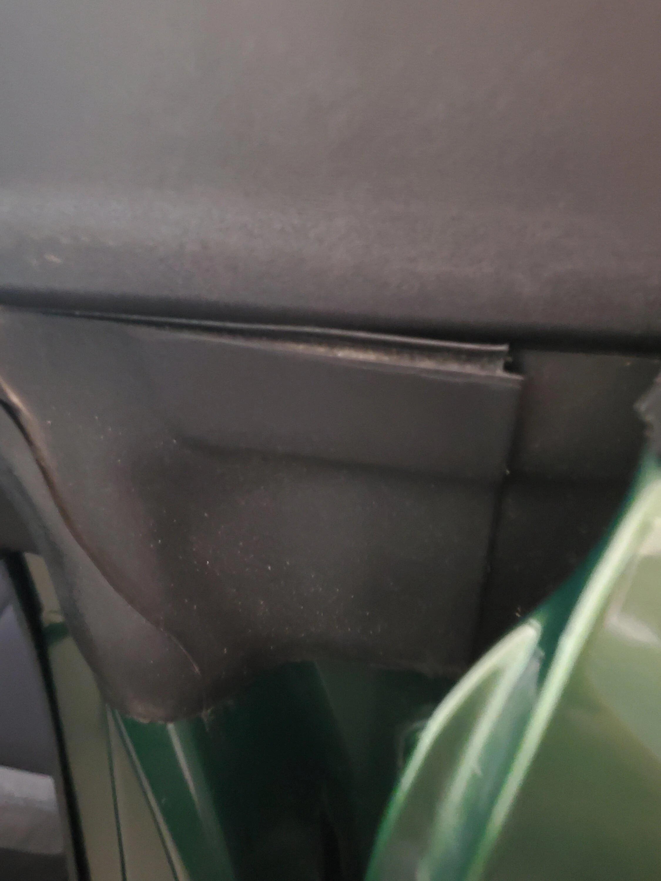

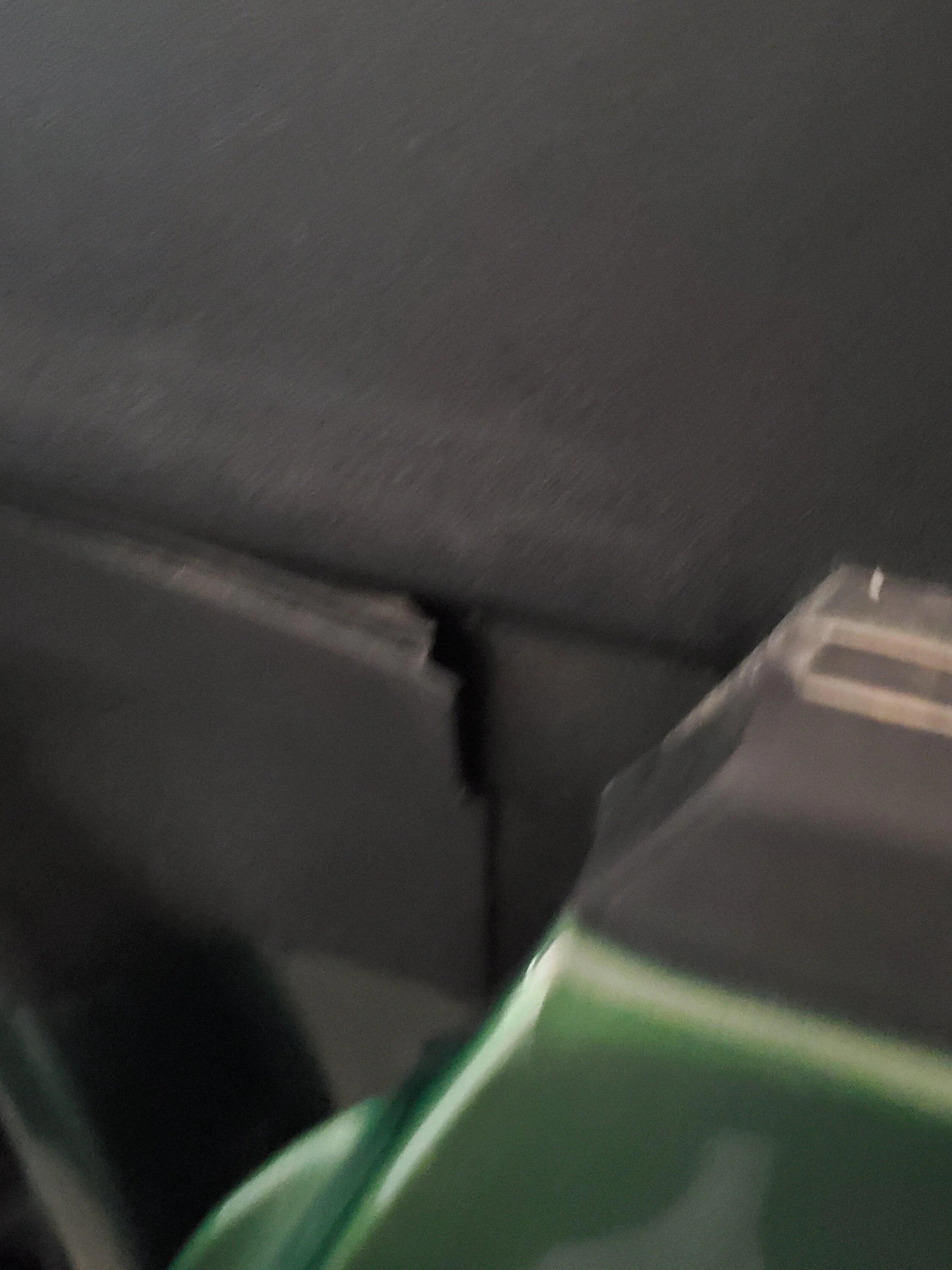

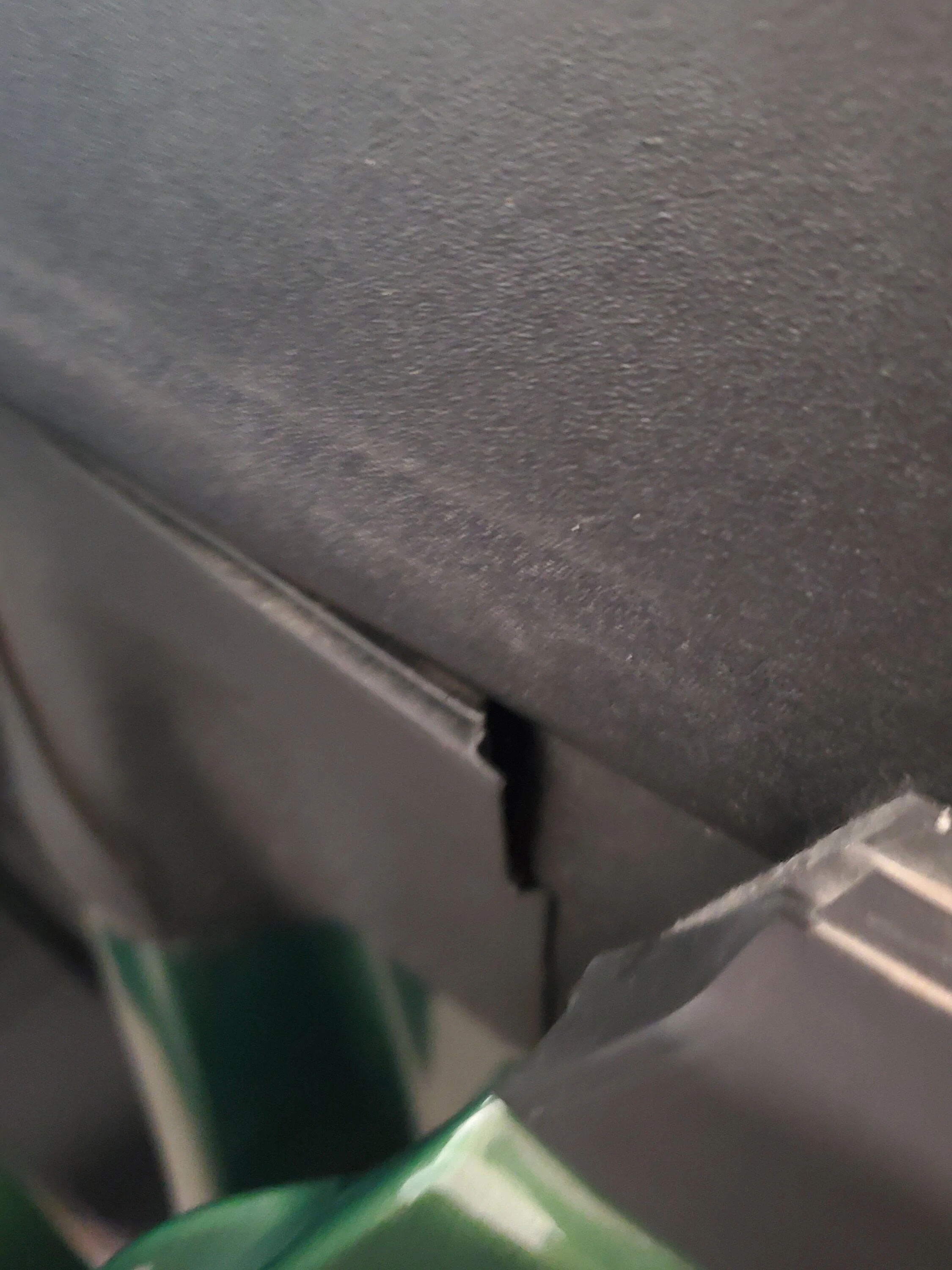

Anyone else have this issue. On passenger front side the rubber sits flush. On driver side this same piece won't stay in. Was thinking of putting some adhesive to hold it down but curious if others ran into this and if there are other non adhesive tricks to getting the rubber to stay flush.

Same issue, different area in rear. any “hi-strength” spray adhesive will fix it, like 3M 94. Wouldn’t spray direct from can tho since that’s close to trim panel, but you could spray a little bit on a burner paint brush or rubber basting brush, paint it on there to ensure it doesn’t get anywhere else.
