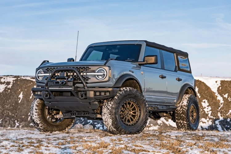

I just did without the front camera for a bit and later installed the jcr off road front camera relocation bracket a few weeks later. This is currently the only picture I have. If you zoom in you can see the camera on the front of the winch. The instructions suggest to do it before you install the winch, but I can tell you from experience that there is just enough room to take the grill off if you don't.
Ford Bronco Rough Country winch installation 20230114_175945
with the JCR cameral relocation and RC winch, did you have to modify the relocation bracket or did it fit directly out of the package?
No modifications needed.
