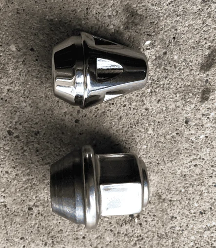

The maximum cone diameter, where the angle ends is .78 The factory lugs are .81. Not an issue because both still exceed the wheel taper diameter.

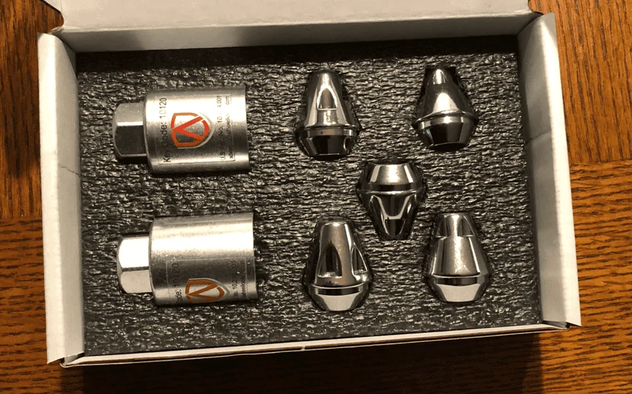

Key engagement seems tight.

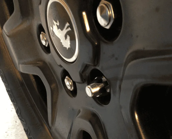

The problem:
Ford Bronco Review: Advanced Wheel Locks 1686946176350
None of them went on more than 2-3 turns. Tried multiple studs. Thread size is correct, but will certainly seize if trying to install. Looks like base plating(nickle/copper??) may be too heavy, or possible HT distorted threads. Chasing the threads now with a tap and will report back on key grip.

Just a quick follow up, got a tap. Chased the threads. Everything looks/works great.
