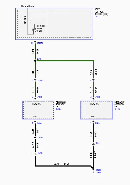

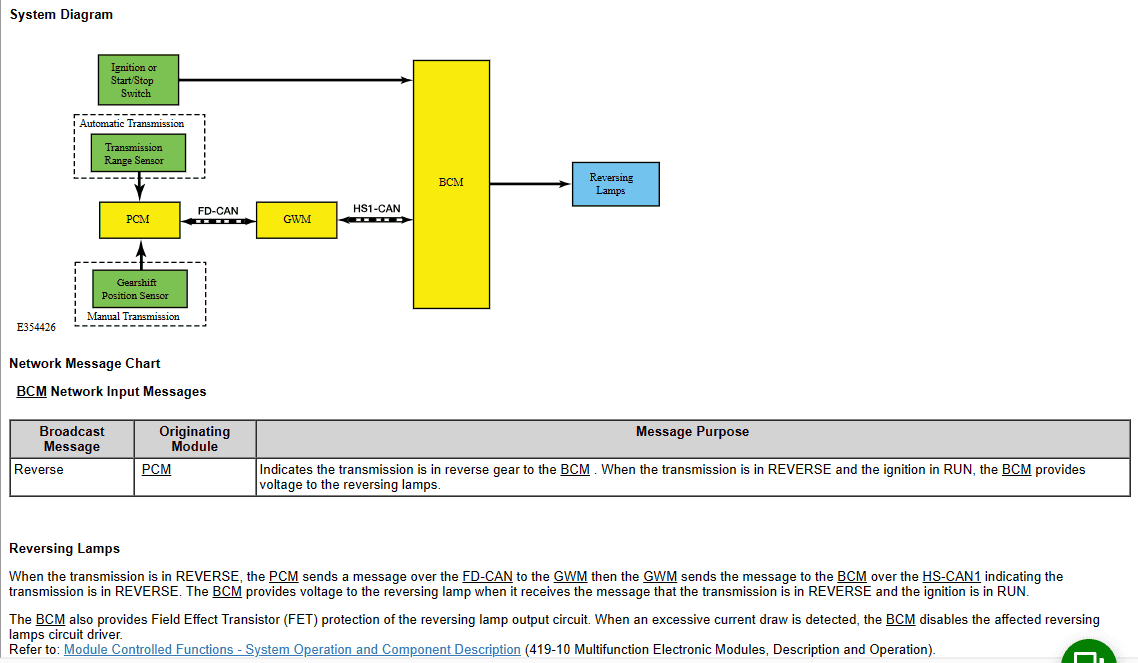

Has anything been done to the vehicle recently? Modifications? The reverse lights are controlled from the transmission range sensor, through the PCM, gateway module, BCM which powers up the lights.
Anything else not working since this happened?
The rear camera occasionally does not come on. I can turn on my aftermarket reverse lights with an aux switch that also come on with the reverse. All else is working fine. The baja reverse lights have been installed for about 8 months. This issue just started.

Did you use diodes with your baja lights? If not, when you turn them on with Aux, it will back feed the stock reverse.
I have had the baja lights for a year and this just started
