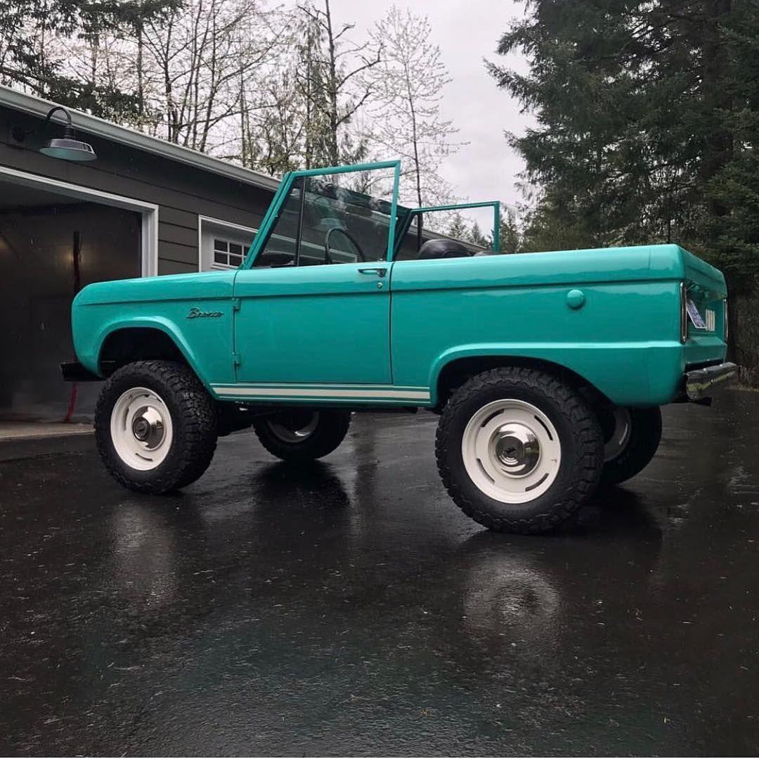

I emailed a guy at Detroit Steel Wheels and they have retro wheels for the Bronco. They are the company that made wheels for Jay Leno’s Bronco build if you have ever seen Leno’s Garage. They even have retro style hub caps for the Bronco.
BTW I was planning on the same type of build however, lately the black has been growing on me.
Below is the pic he sent me.
Ford Bronco Retro Wheels/aluminium and offroading? 9AD6ECFF-99B8-44A1-ADA3-076BFBF361A4
That’s a stunner!!
