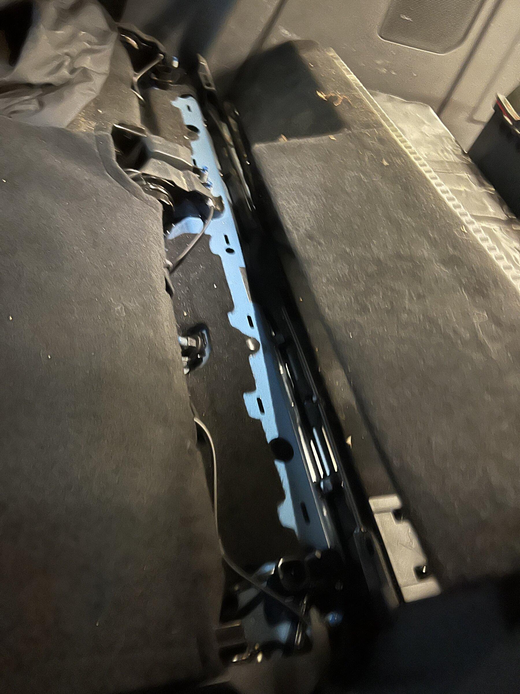

I finally got around to removing the large side of my back seats. If you want to do this, you'll need the following:
-45 min
- 13 & 18 mm sockets
-T60 (I think) torx

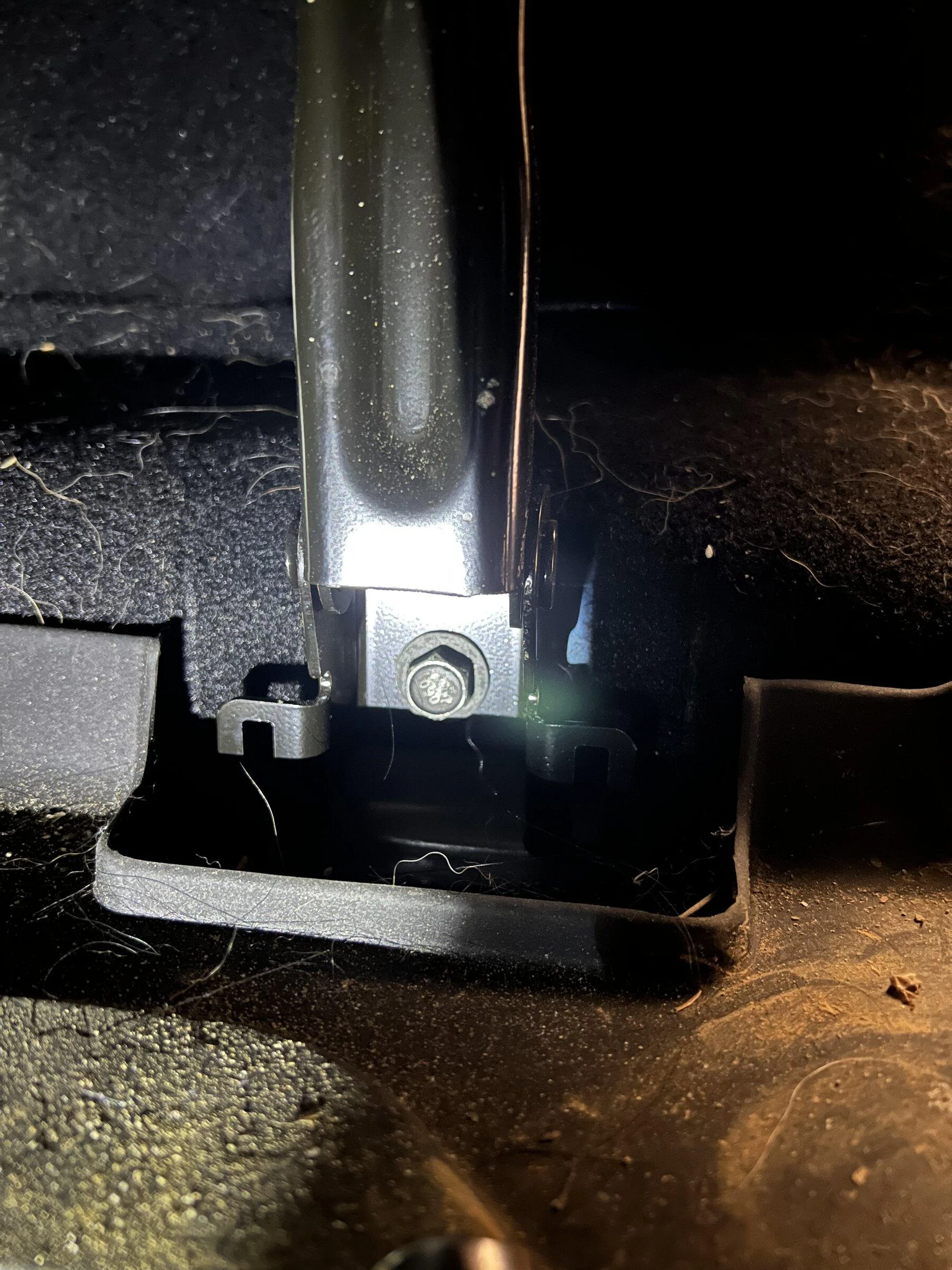

1) Remove this. Lift the flap up and pull, pops right out. Remove the 18mm nuts along the back, the bolts come through the bottom of the truck. You'll have to reach between the seats and unbolt both 18mms that also hold the seat belt receiver in place.
Ford Bronco Removed back seat on 4-dr IMG-0464

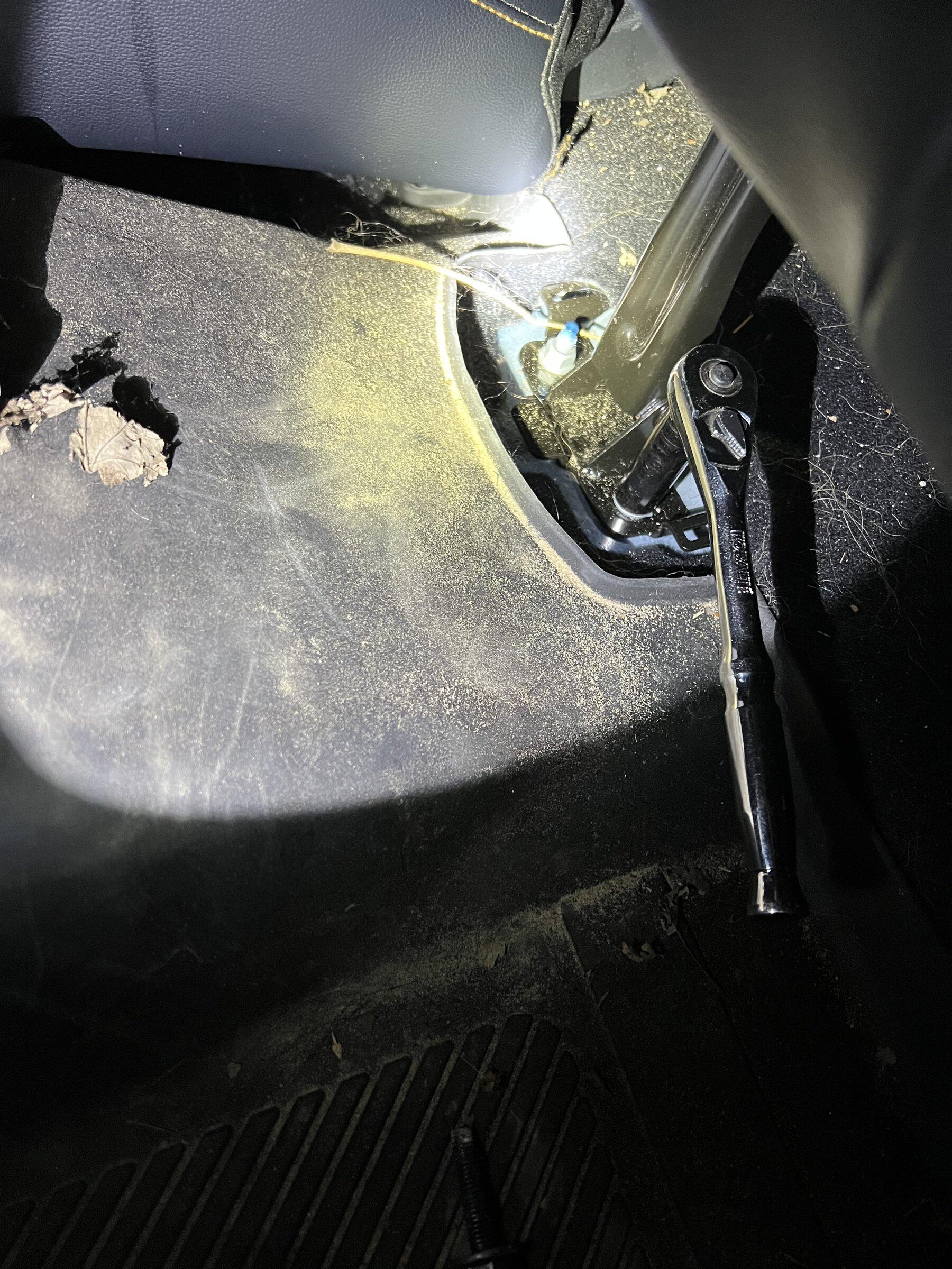

2. Take these 13mms out from the base of the seat on the floor.
Ford Bronco Removed back seat on 4-dr IMG-0484
Ford Bronco Removed back seat on 4-dr IMG-0485

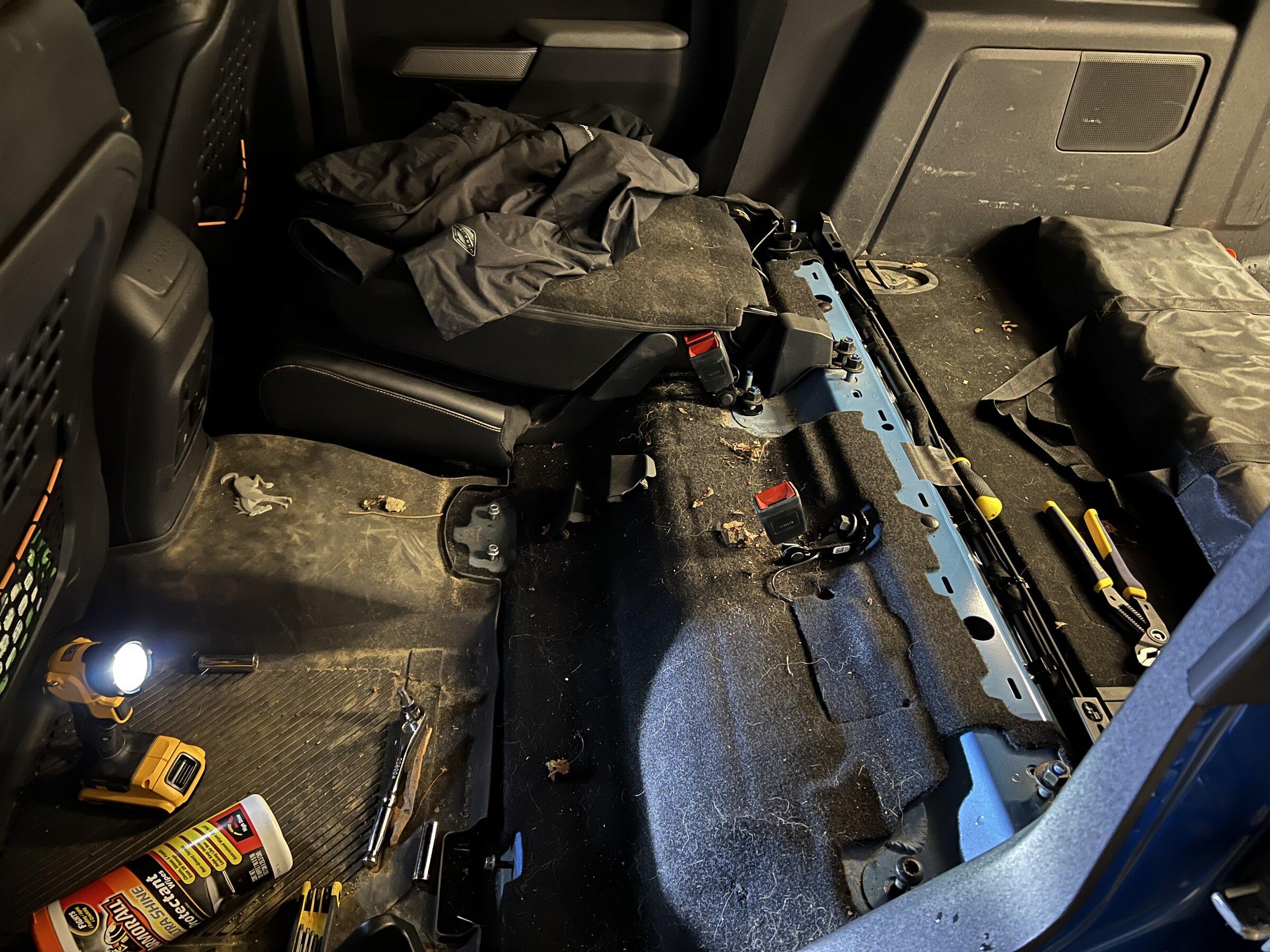

3. You should now have something like this:

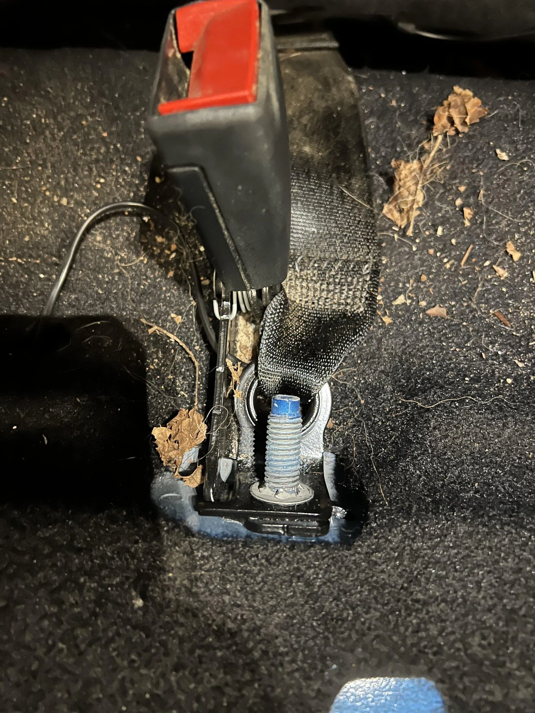

4. And now it's this little shit, located right inside the door and anchoring the seatbelt in.

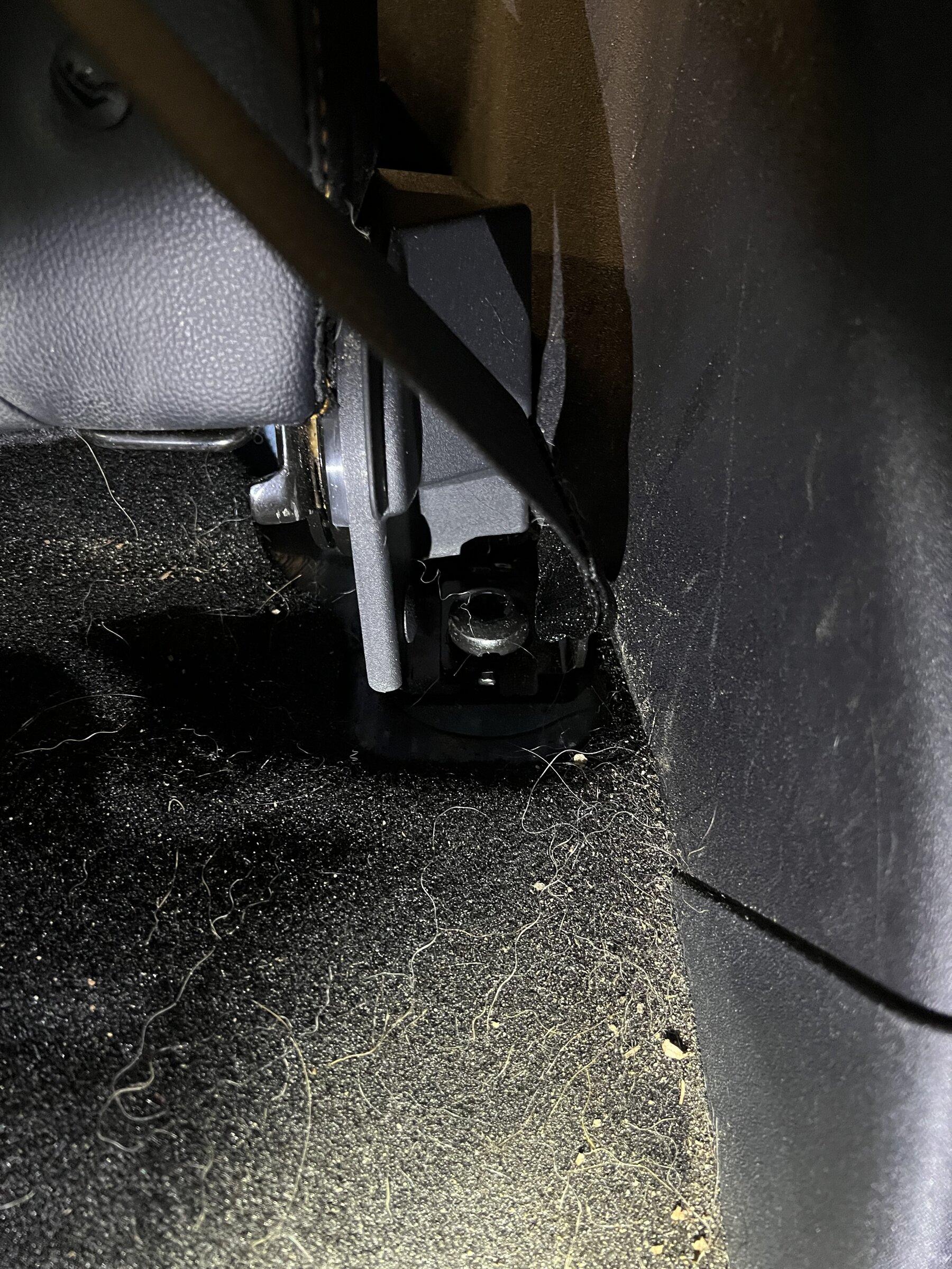

5. This guy is next, 13mm. I pried that metal ring off of the threats and then just cut it.

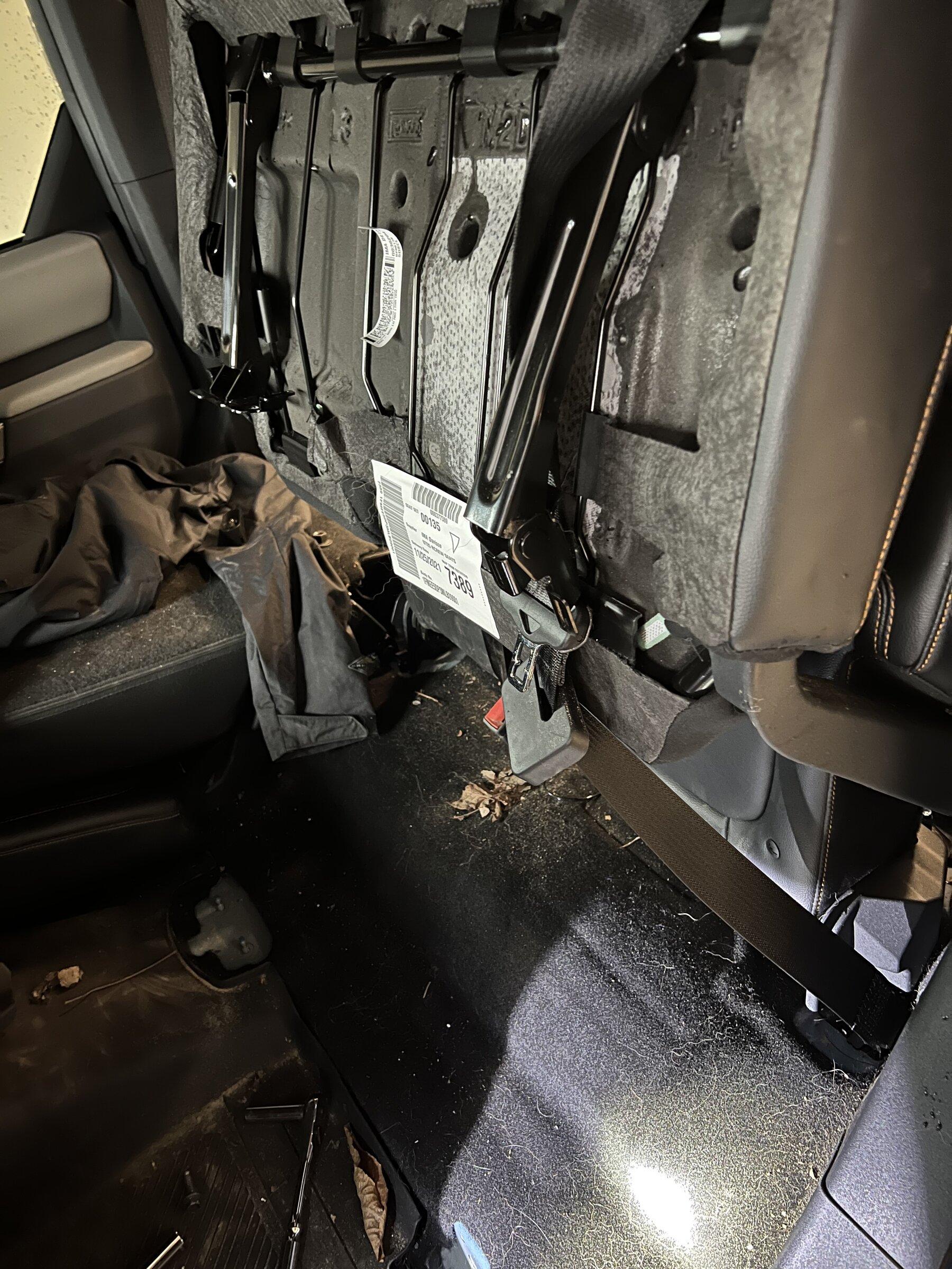

6. And unless I forget a step in there, you should have something that looks like this.

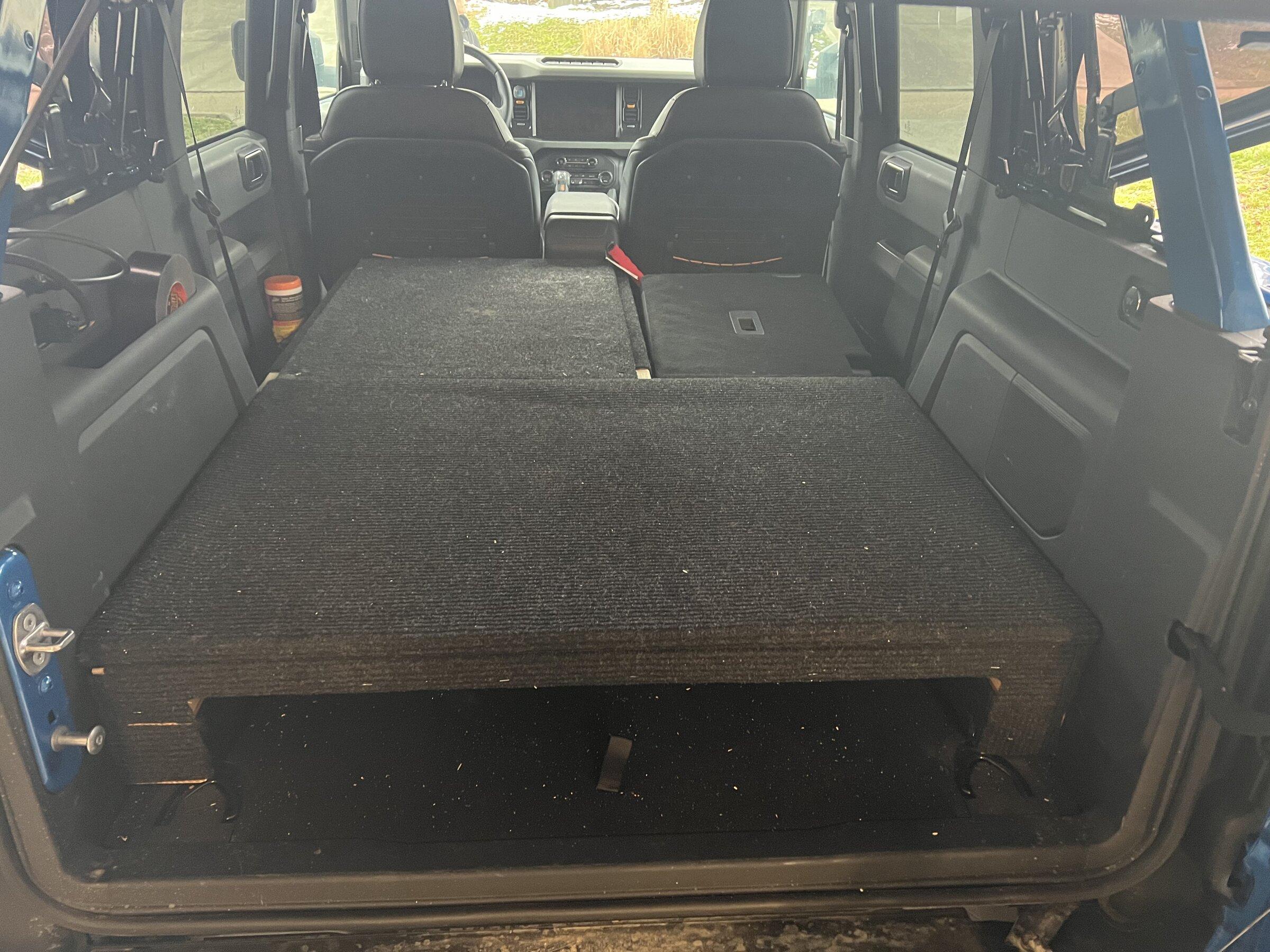

A sleeping platform when I’m camping, but I keep a collapsible ramp under there to get my Newf into the back of the truck. It’s not as pretty as some on here, but it works
