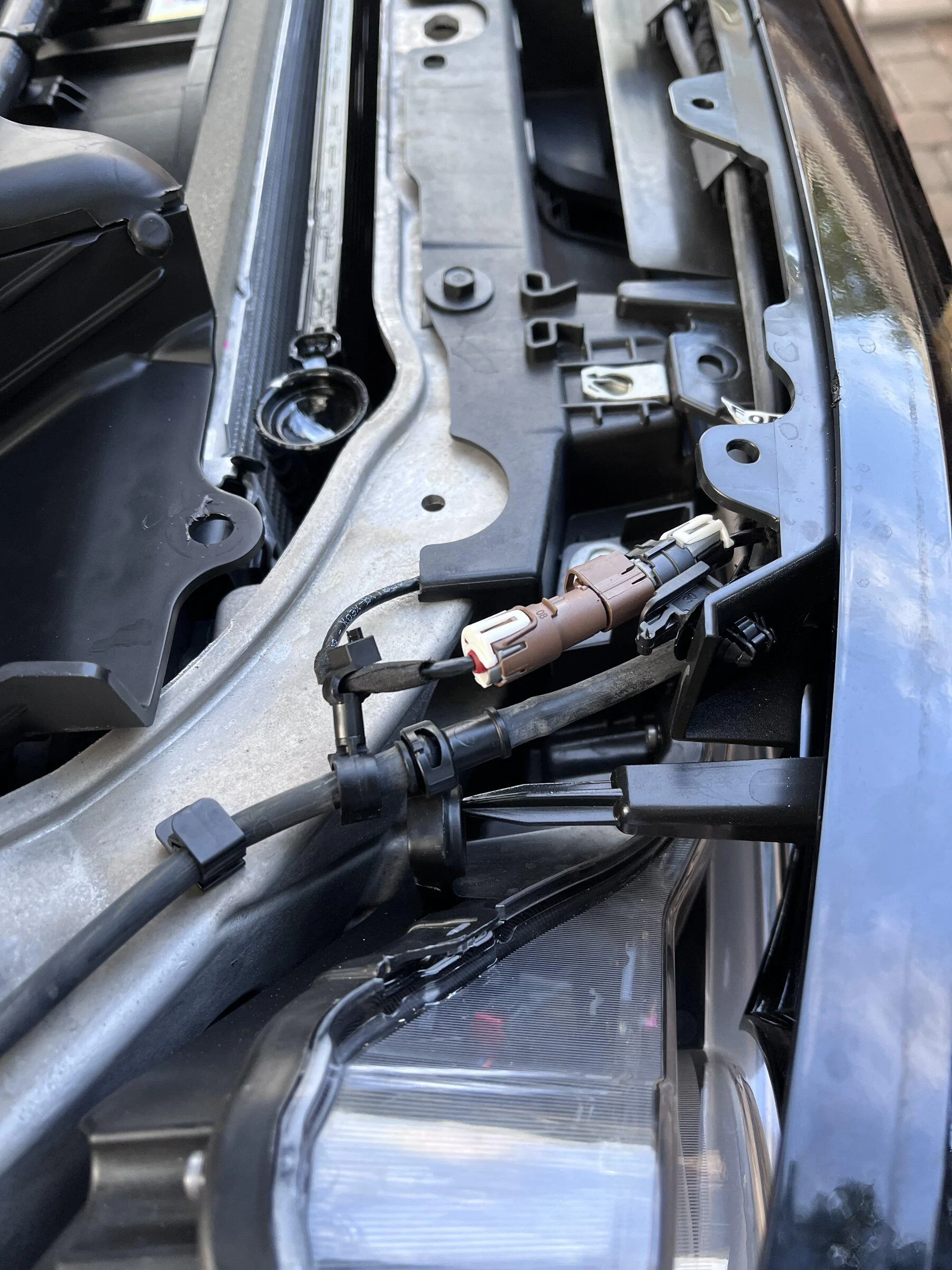

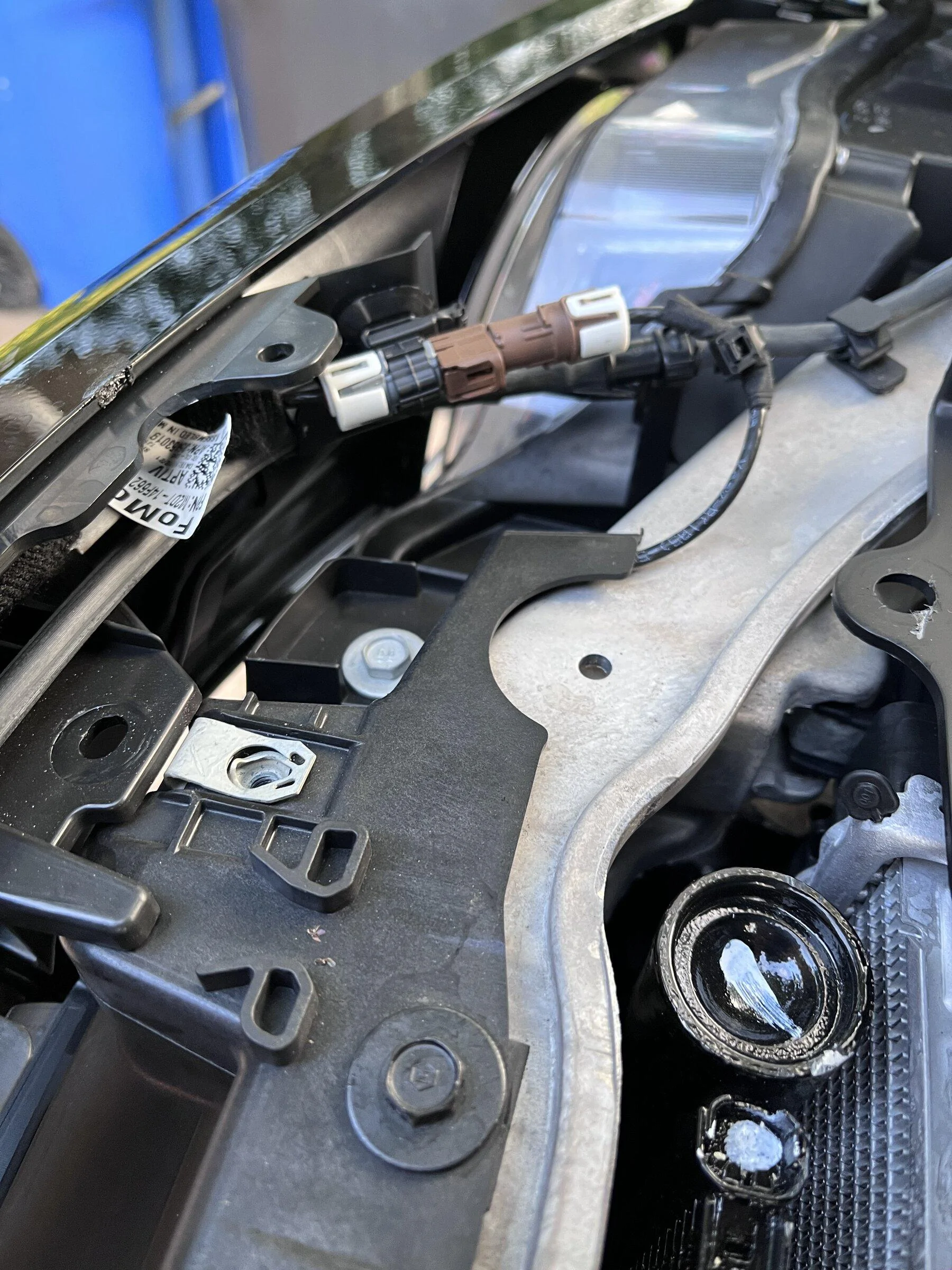

Hello, trying to tackle grill removal to change the white “BRONCO” letters on my outer banks…
Videos online I found only show removal of clips and screws… but there appears to be 2 lines running from the engine bay that are secured to the grill, preventing removal .
Any guidance on disconnecting ??

One is for the camera, the other for the camera sprayer tube. Those are quick disconnects in your pictures, just squeeze the connectors and pull them apart. They have clips that hold them together that need to be pushed in.

the brown one is the front facing camera, and the black one is the washer fluid for the camera.
Both come off with a little squeeze and some effort.

It’s okay to unhook those!

AWESOME- THANK YOU!!!!!!!!!!!!!!!!

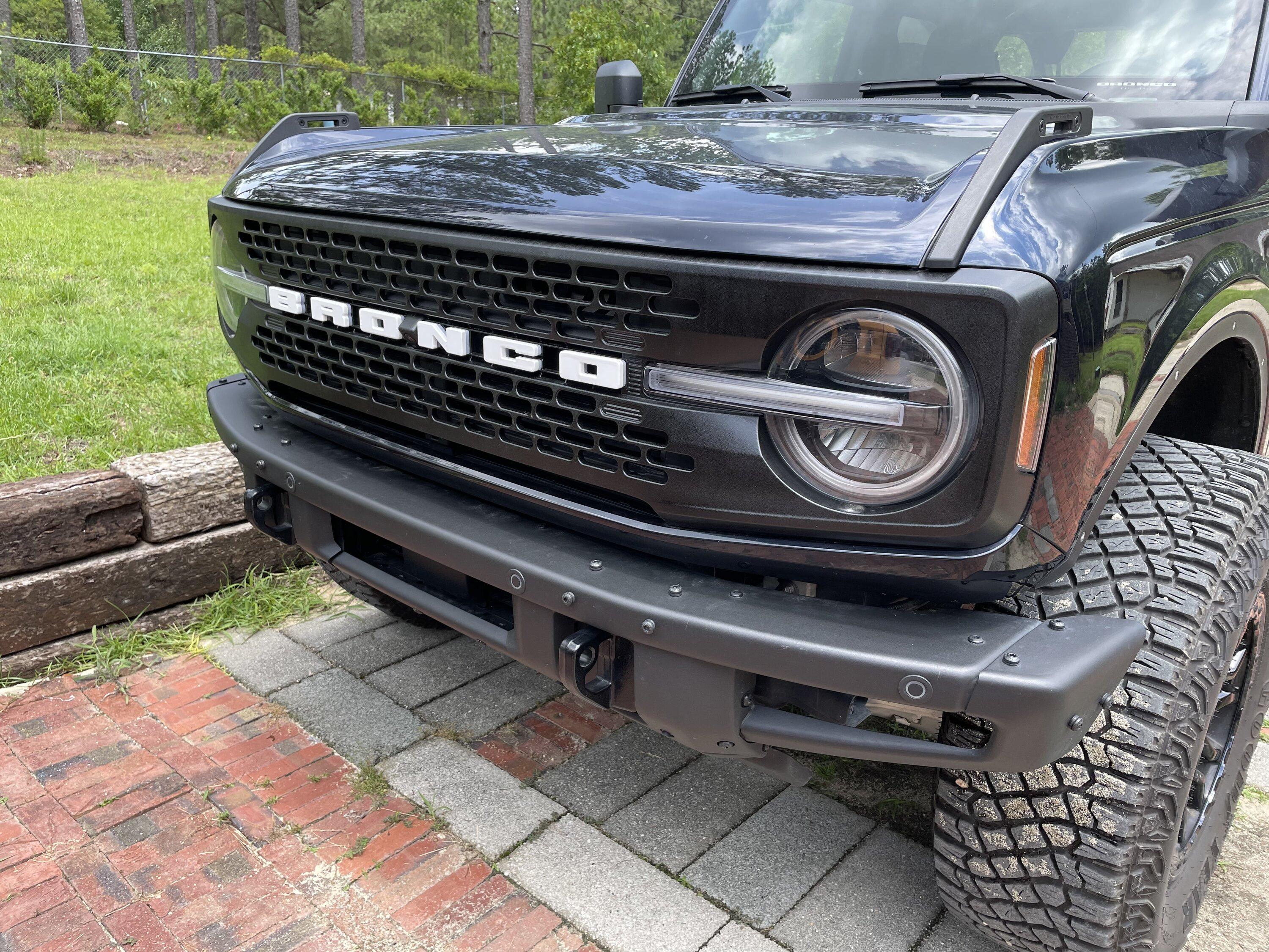

It’s fine to unhook them. Took my grill off to paint to match the bumper.

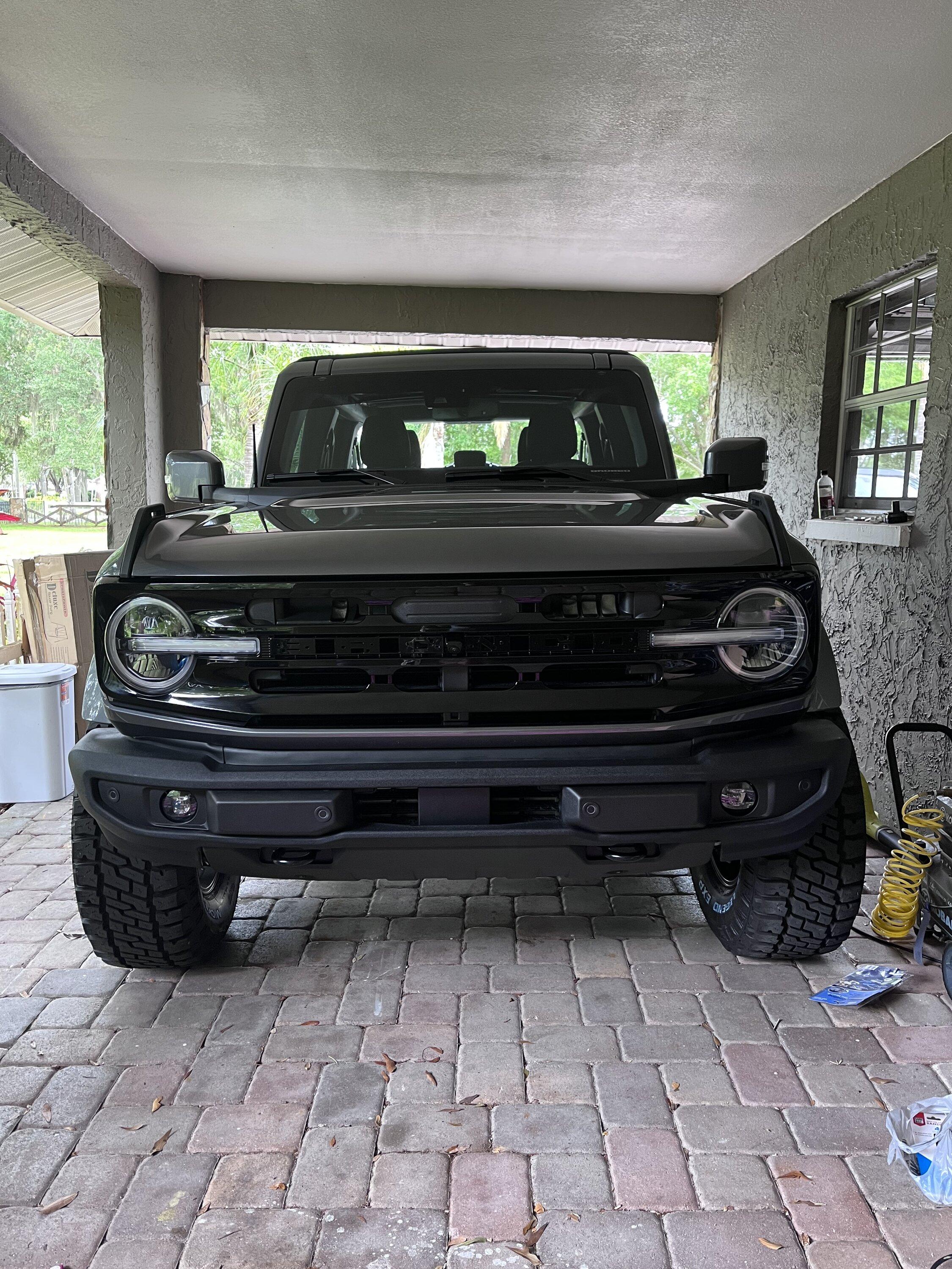

Thank you! I got mine off. I just drilled the white letters out , I haven’t replaced them yet …. But kind of like the look of the all gloss black …. Even with the holes in the letters
