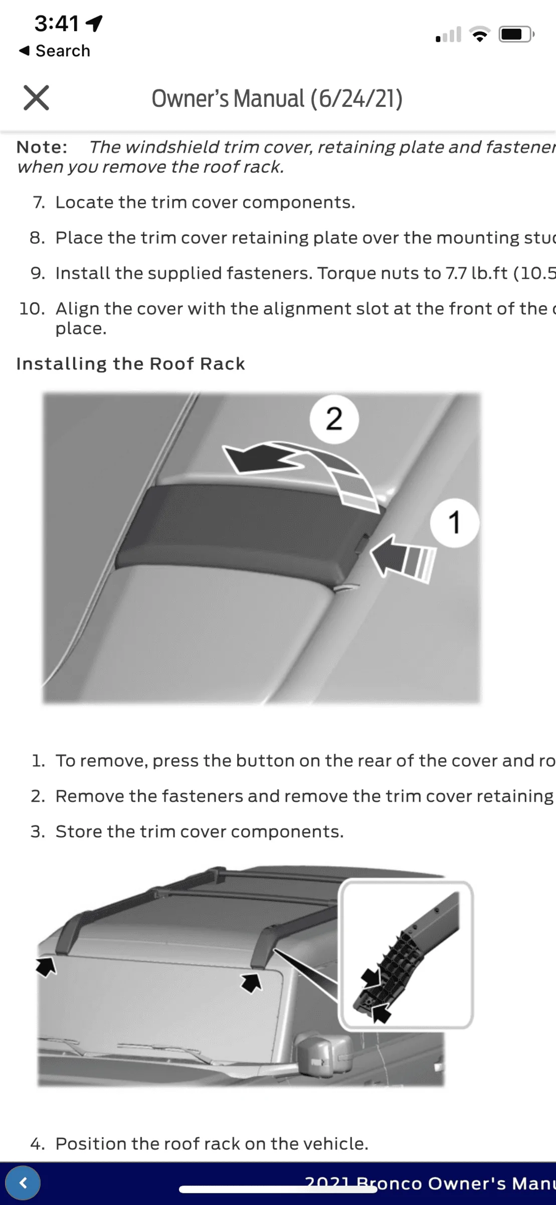

I would like to remove one of my front rooftop accessories panels and do not want to damage it.
Do the front rooftop accessory panels simply pull off? Does it matter top or bottom first?

In the owners manual.
Ford Bronco Remove front roof accessory panel FA45F393-1BF8-4C96-BD4A-A033DD8C2250

Perfect! Thankyou much

Happy to help but I am also pointing out that the manual does have some good info.
