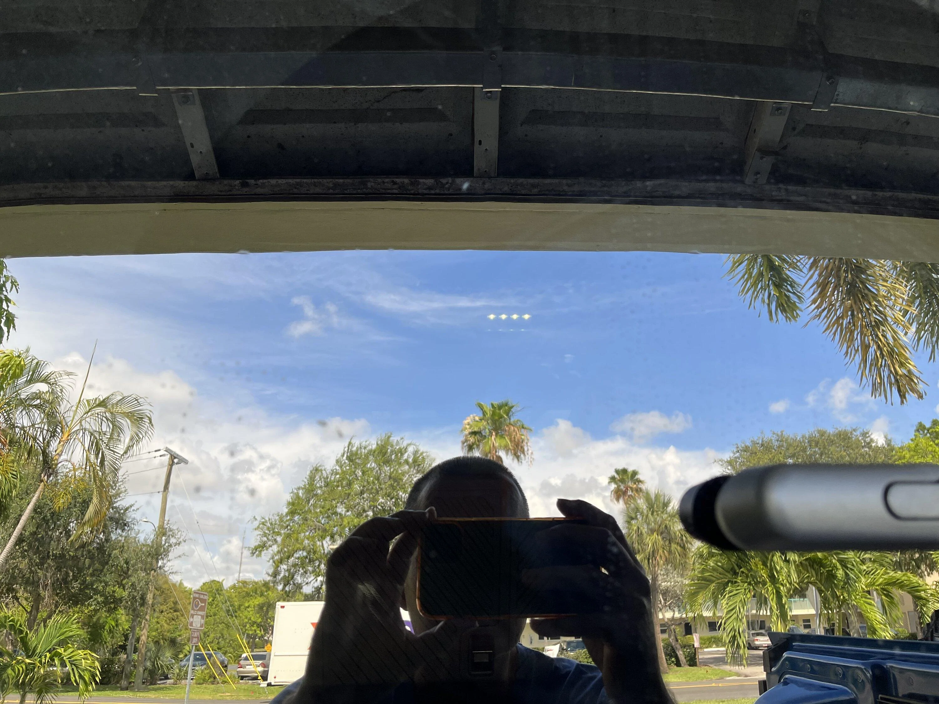

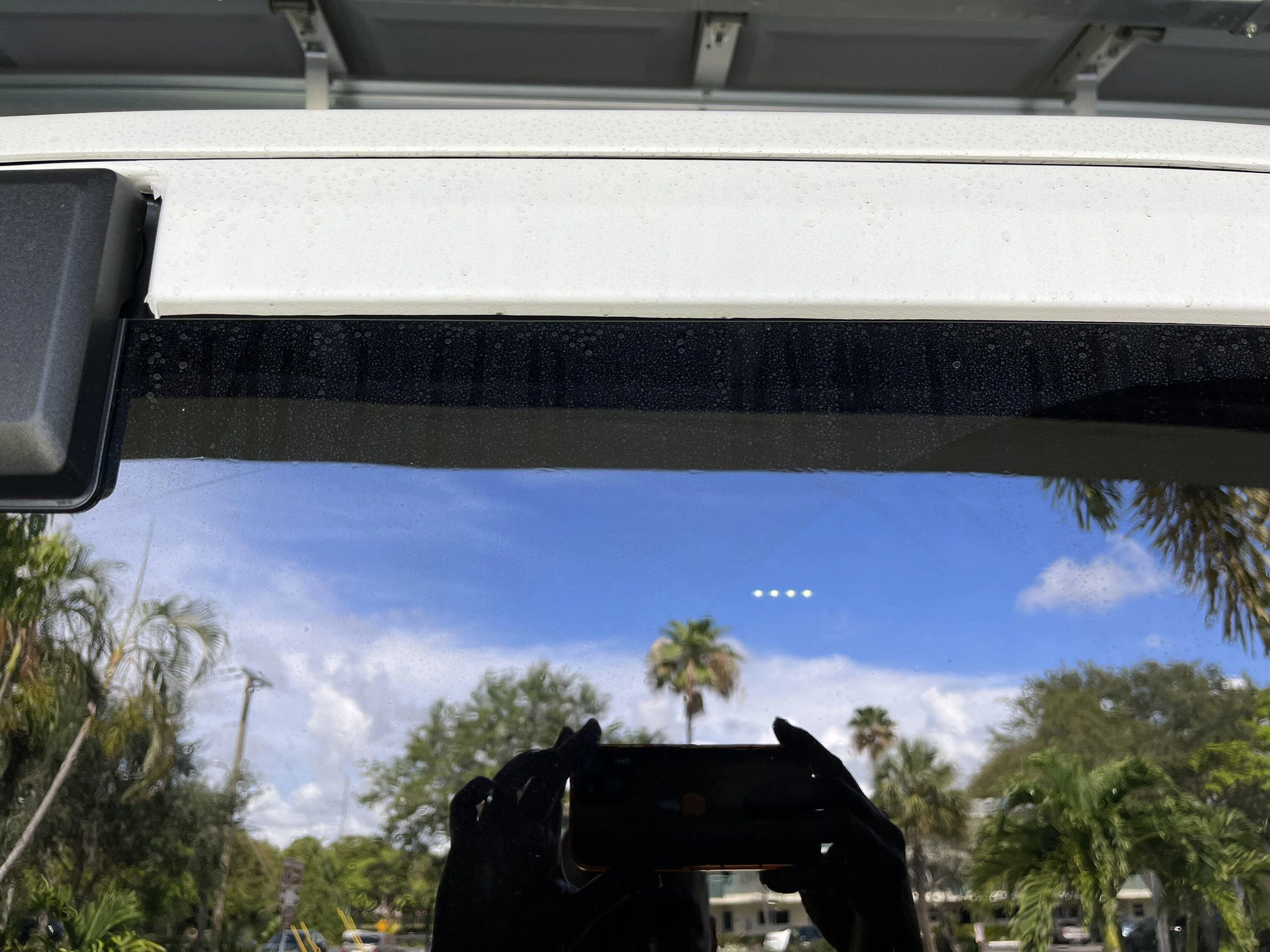

Has anyone else seen any issues with the tint etched in the rear window? The others are fine. I went to the dealership and 4 people saw it but not the main service manager who was out. It’s hard to see it in pictures, but zoom in and look at the line in between the blue sky and yellow house line.
Ford Bronco Rear window tint bubbling IMG_1174
Ford Bronco Rear window tint bubbling IMG_1176

Well first of all the glass is shaded unless you had aftermarket tint installed. If you had aftermarket tint installed open the rear glass and see if the film is bubbling, if so that’s adhesive failure if not and it’s the glass then you may have a defective piece of glass.
Yeah, it’s a laminated piece of glass. The lamination was not done correctly. You’ll need a new back glass. No biggie.

Rear glass is tempered not laminated.
