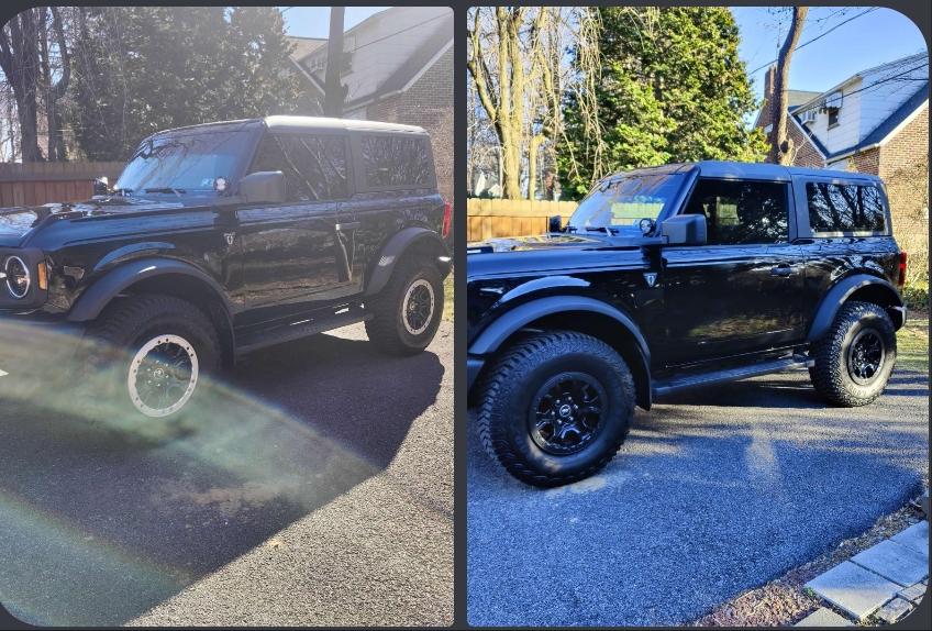

Just responding here incase you're not aware that removing the rings can be a real pita. No clue why but Ford out yellow locktite on the bolts and they can be very tough to break free, I had a torx bit shear off they were so tight, and when it happened the force jumped me forward putting a large gouge in the ring, powder coating fixed that at least. I also lost 3 of the bolts due to stripping and they are $20 each to replace.
Just a heads up. It's still worth doing just be careful and ready.
Also before and after pic just because

Looks amazing. Ford seems to sell the color I want. Maybe it’s worth it to have them deal with sheared off bolts. Did you have to drill any out?

Lucky or unlucky....after shearing a bit and stripping a bolt I gave up for day to come back to it. Next day my alarm kept going off due to bad hood latch sensor and I had to take it to the dealer. While it was in I asked service to break free all the bolts for me and remove the stripped ones lol. They didn't really get why I was asking for this but they did it for free and I didn't have to deal with drilling them out or messing up more bolts.
I think the Ford rings cost $700, powder coating shouldn't be more than $200. It's your money but better to just get the rings you already have powder coated. I've read some people say they have no problem and bolts come right out and some seem like mine. Give it a shot and if it is tough have your dealer deal with loosening them.
