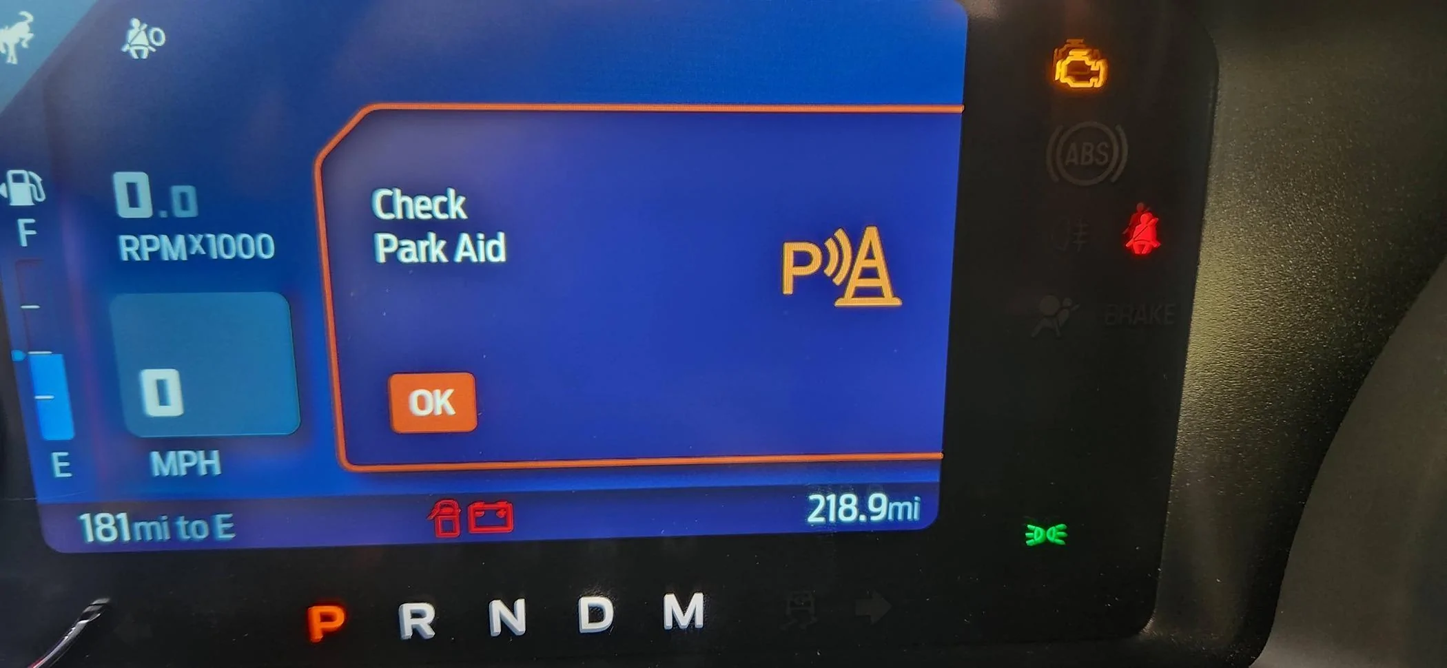

Well, I am a new Bronco owner, only had the truck a week and I am getting a Parking aid fault. 2024 Bronco Wildtrak with 218.9 miles on it.....I came out and started it up one morning and this popped up and hasn't gone away. The button in the center console does nothing, can't turn it off from the features on the screen.

Ford Bronco Parking Aid Manager 20240602_131633

Reset your changes to OEM, then see if it persist. If it does it is an issue and have the dealer fix it. If it goes away then do each of your Forscan changes one at a time, and see if it comes back.

I got that message once. I cleaned all my sensors and it the message has not recurred.

Ok, my dumbass figured it out today with the assistance of RoverDude. I put in a dash cam I used the number 25 as a constant which is a spare to the Bronco and 37 as an ignition hot. That's where the problem was. it was pulling too much from the parking aid and messing it up.
I switched my ignition hot to number 35 which is not used by the Bronco and is a spare.
It seems to be in working order now.
