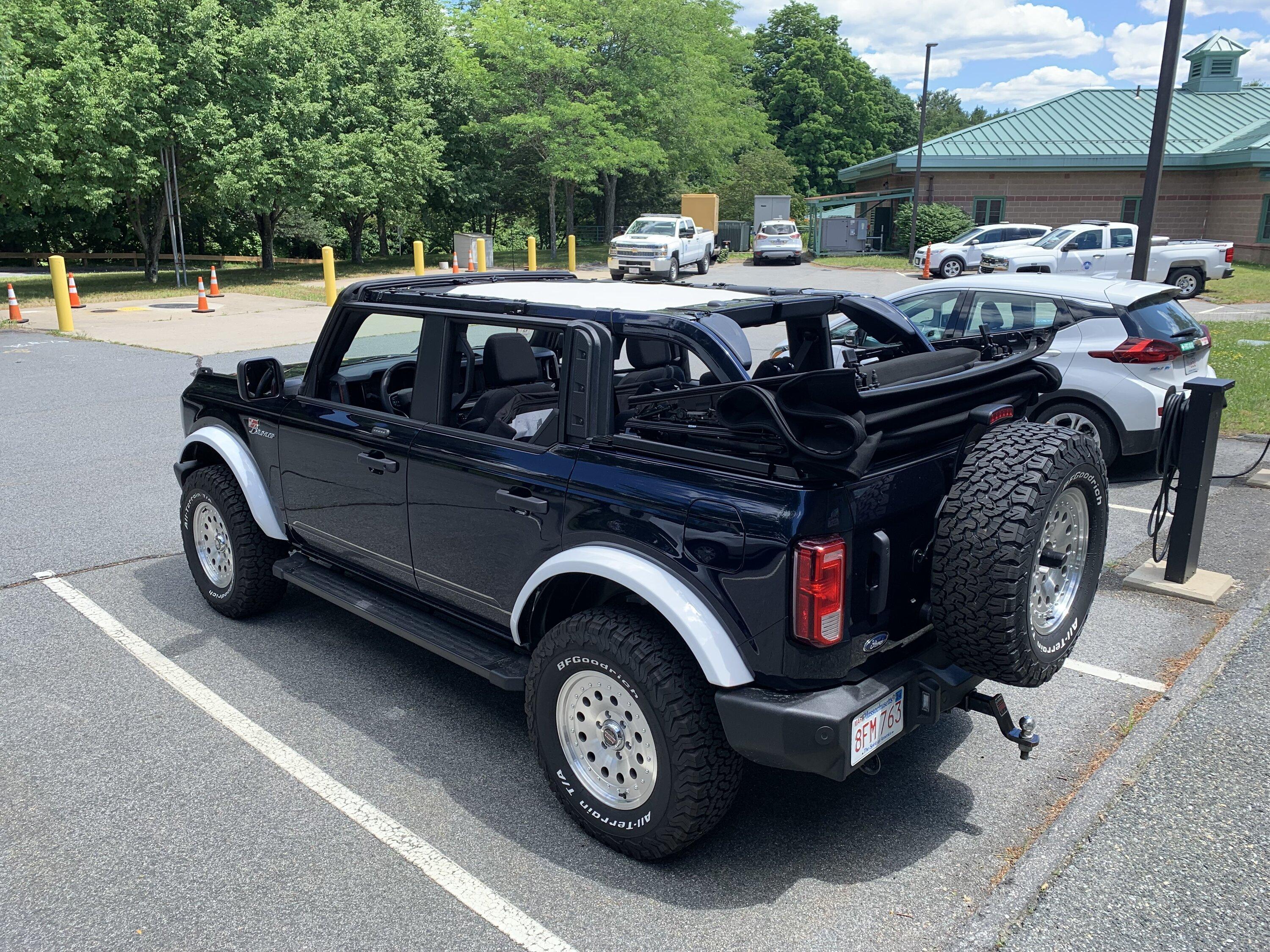

PS: Here's a last pic of the wheels and lift with 35s, which look practically tiny. Need the SAS flares given the offset and the convertible top.
PPS: Yes, for those paying attention, those are "OJ wheels". Brushed metal is the best.
