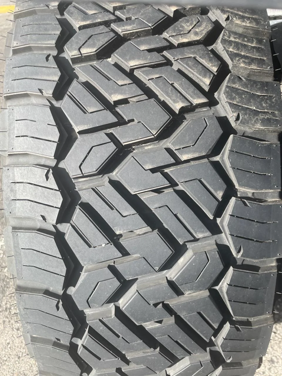

Ford Bronco Nitto Recon 315/70/17 - Load Range SL vs E2? BEF9C819-CB0A-44EC-8029-C1C8EA6711B5

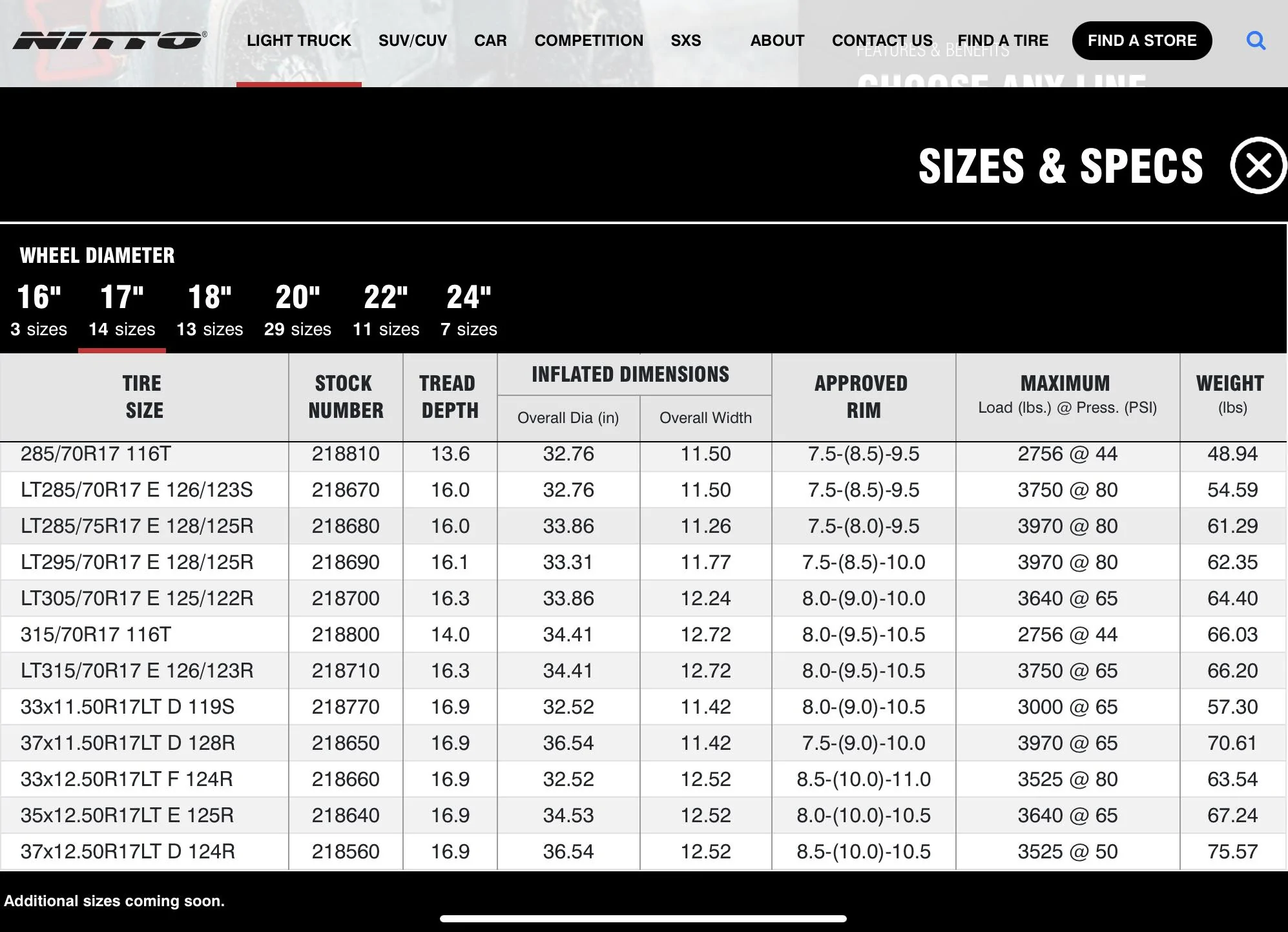

Interesting that the weight is the same between the SL and E. There is a lot less tread depth on the SL (common in other brands, too).
Ford Bronco Nitto Recon 315/70/17 - Load Range SL vs E2? 6730BF82-C017-43E6-BD3B-212D62AF9505
