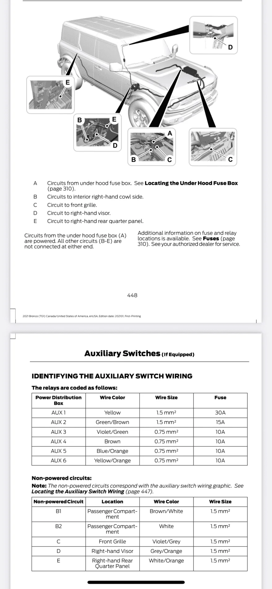

Coming from a Jeep JLU which I just connected my accessories directly to the specific color wire, then black to a ground, the AUX switch then can be use to turn my accessories on & off.
I have a set of Rigid Fog which I tested with the wire directly connected to the battery to make sure they work. Since I am having trouble finding the Non-powered Circuits which I am guess is just a passthrough going from 1 end to another, I just connected the Rigid harness black wired to a ground, then connect the positive wire to the Yellow/Orange wire (AUX 6)(behind the fuse box), but it doesn't look like I cam getting any power. I am not sure what I've done wrong. Suggestions?

Page 448 in the manual
Thanks for the diagram, but yes I already saw it. I was looking for Non-Powered circuits (C) which I couldn't locate. Then figured I can bypassed it just my fog light harness directly connected to the Yellow/Orange wire (AUX6). So, is the Yellow/Orange wire is supposed to be a proving 12V when the AUX6 switch is turned on? In my case, when I flipped the AUX6 switch on, I don't think I can getting any power, and nothing was register with my V Meter.

Finally have time to work on the wiring with proper tools, and yet I was stupid.
Turned out there were 2 issues.
1> the connector I was using was poorly made, we connect everything using proper wire cutter and connector.
2> the Aux switches came from the dealership were all in the On position. So, when I was doing my test I was actually flipping it off.
To answer my own question, the wires are hot, and can be used to connect your 12V accessories to them directly.
