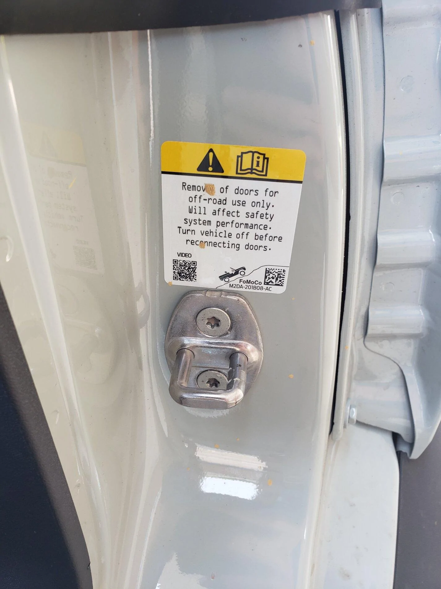

This was brought up on some other threads. apparently there's a disclaimer that says the doors should only be removed off-road. So in the vehicle is in a on-road mode, it can complain.

Yeah that's the one. So stupid question, but have we confirmed that we are allowed to remove the doors for normal driving?
I mean that sticker literally suggest that the Bronco was not designed to have the doors removed unless you're off-roading. I mean we all know Jeep people do it, I do it, and Broncos supposed to compete with Jeep...so WTF Ford?
