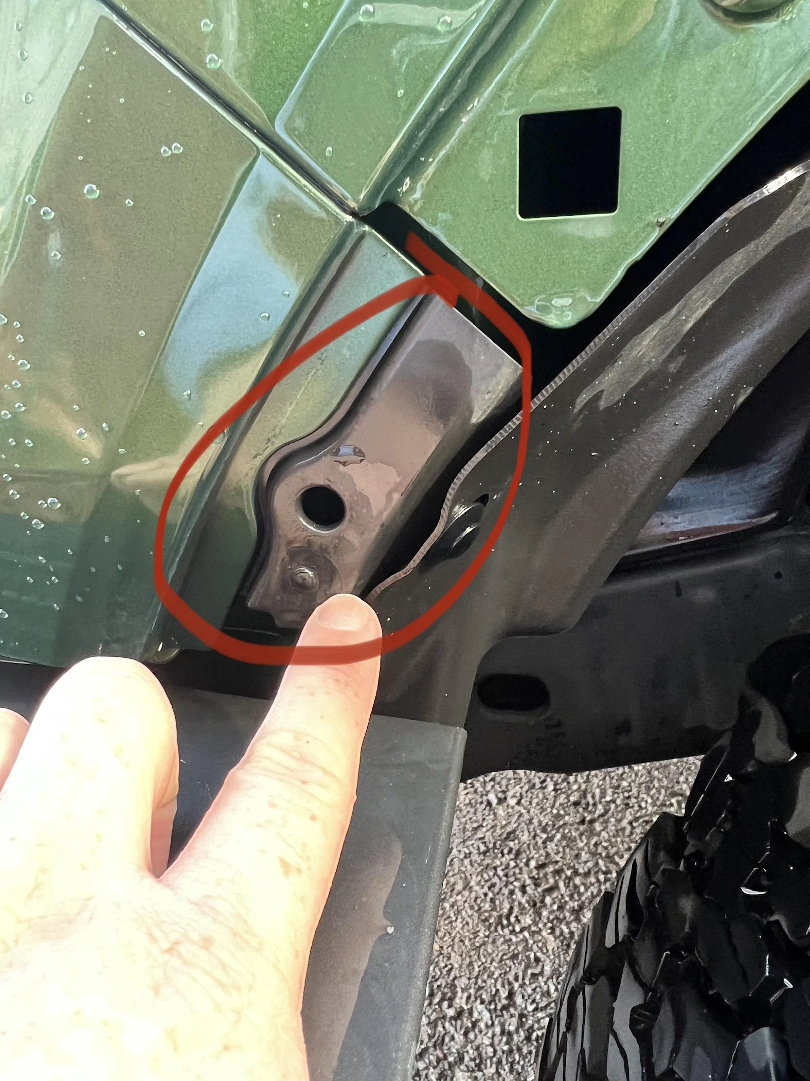

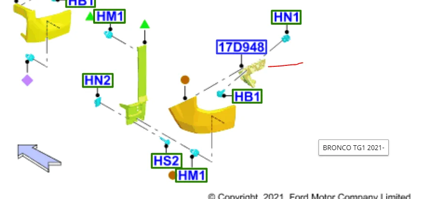

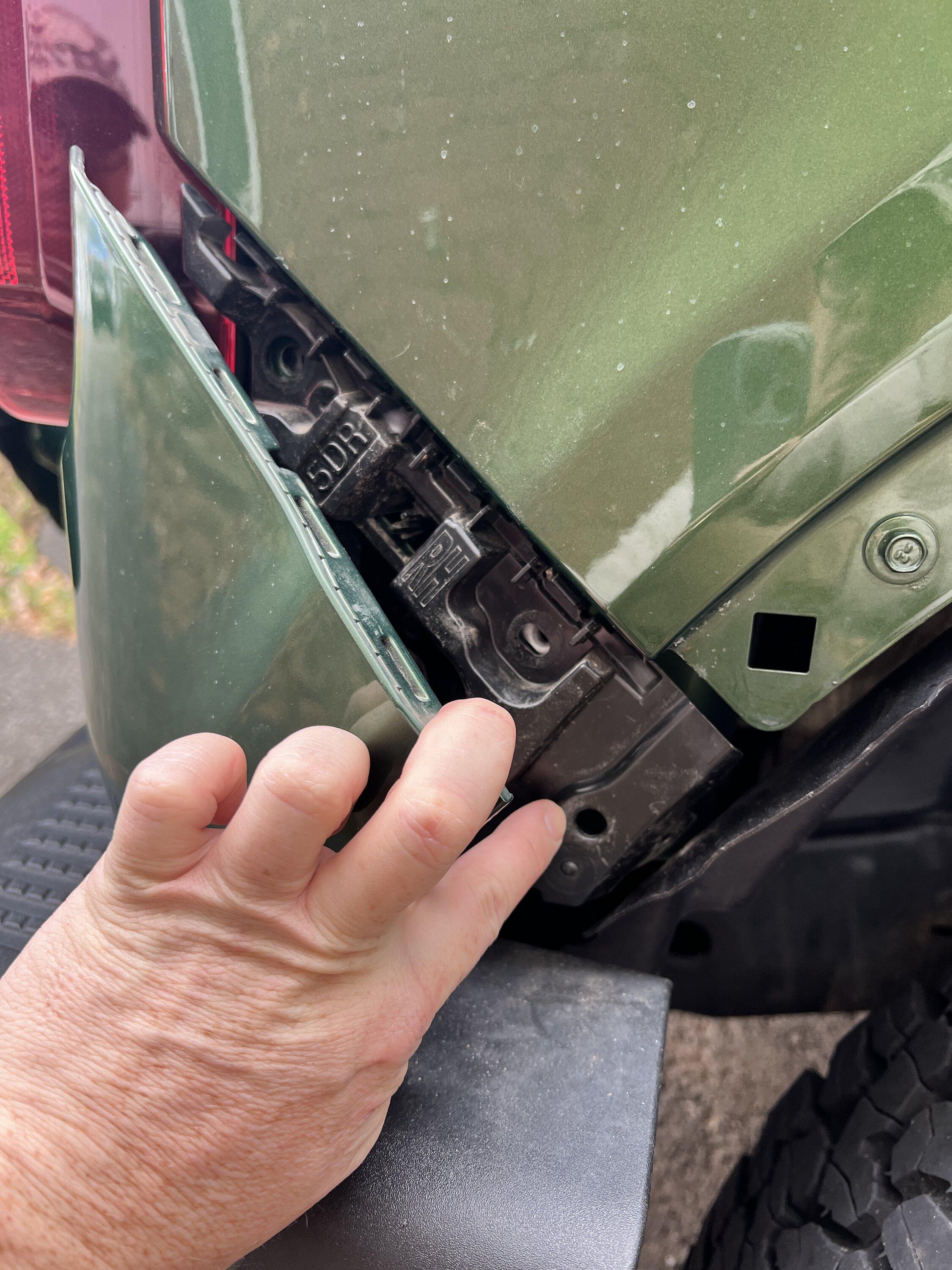

It’s really more the bracket that holds this body panel piece in:

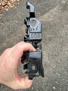

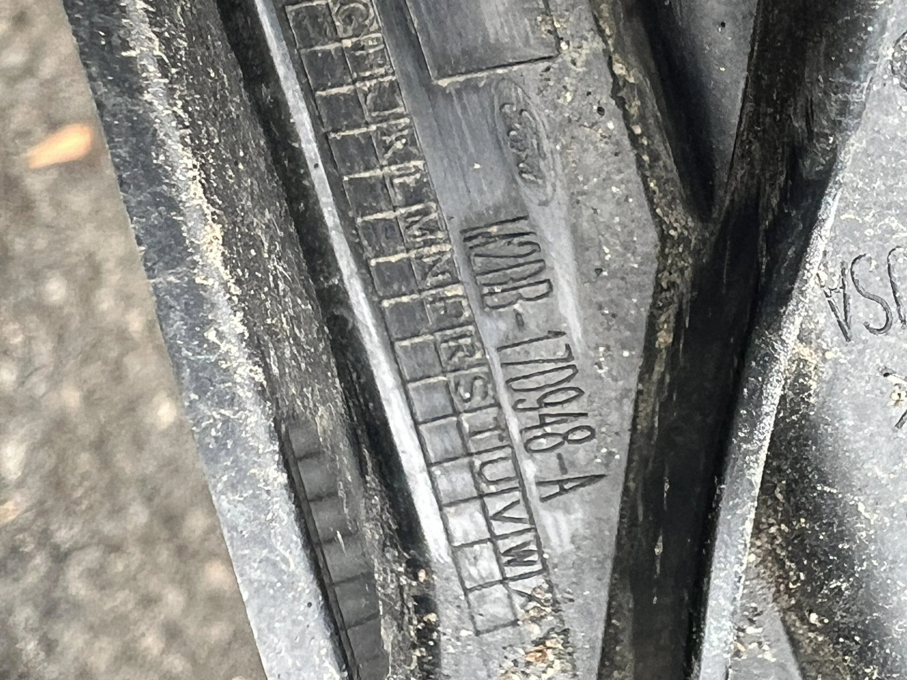

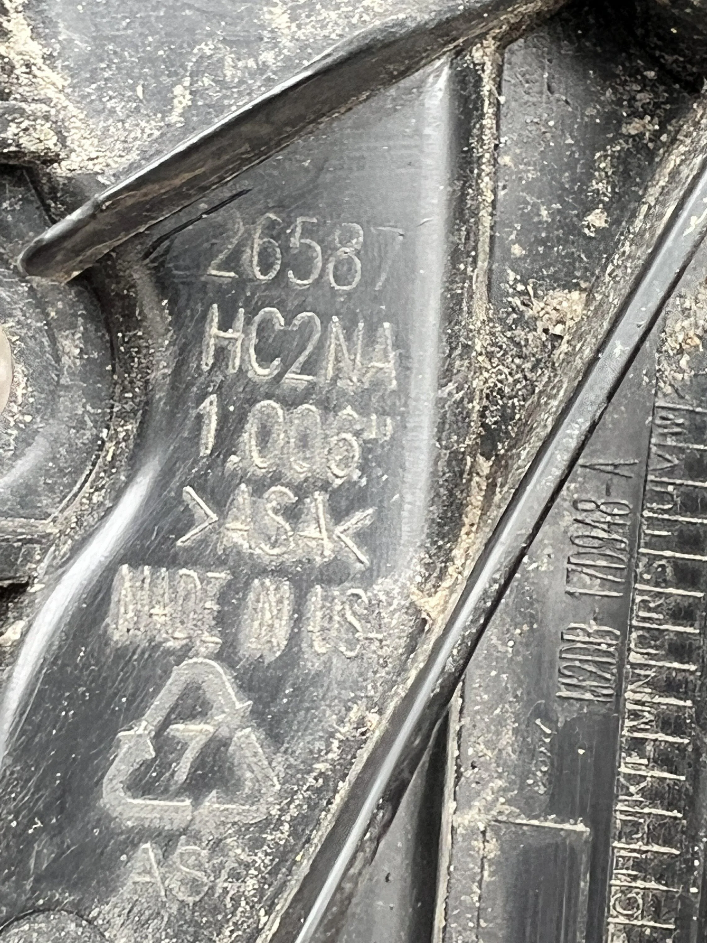

Here we go:
it was stamped on the part that broke off.
Here’s the pax side.
It’s the “-A”
so, drivers side is “-C”?
well, @flip this is the engineering number
it’s not giving me the part number

I'm going to go with M2DZ-17D943-C as the one you need.
The right side engineering number is pretty close.

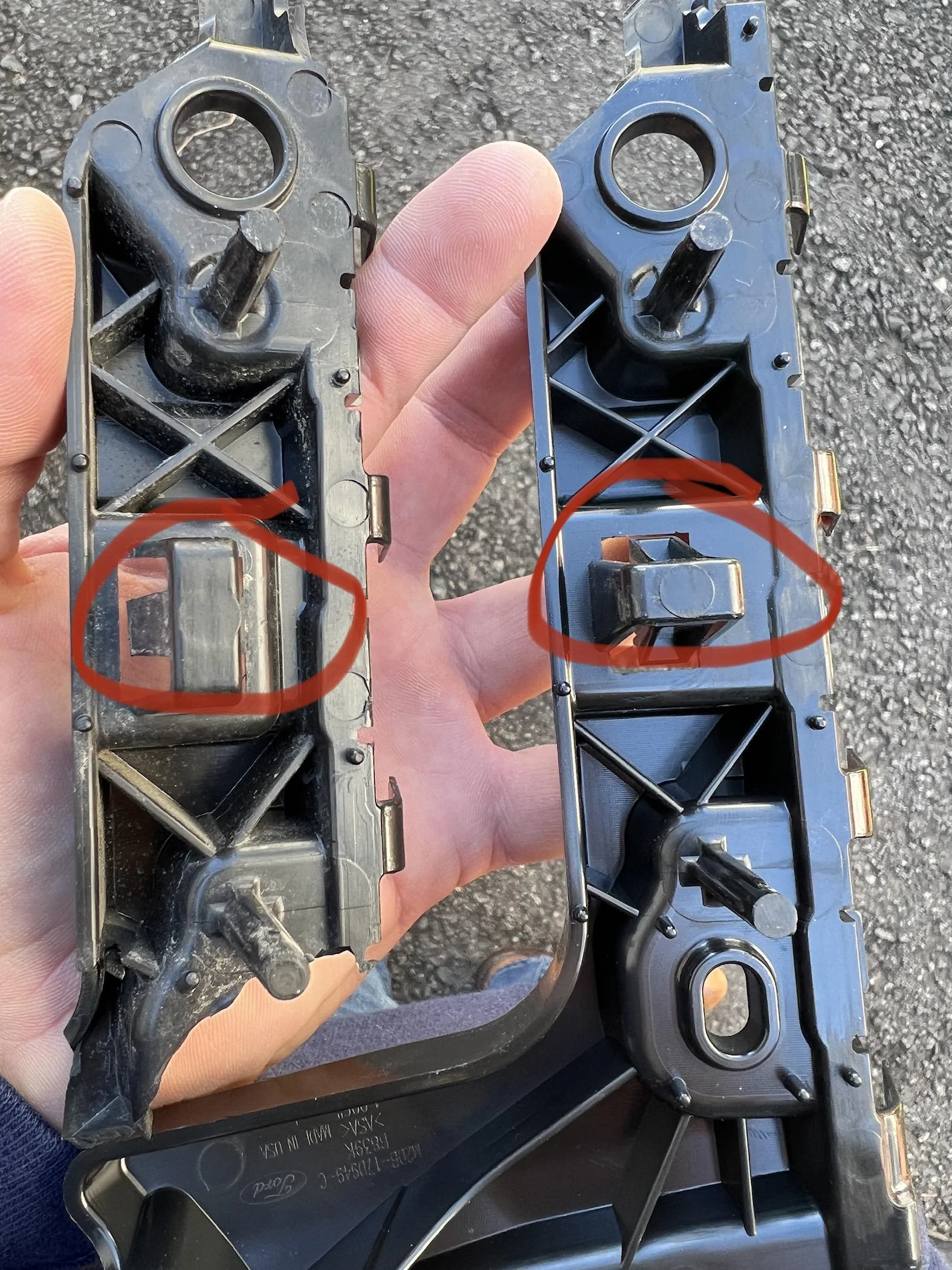

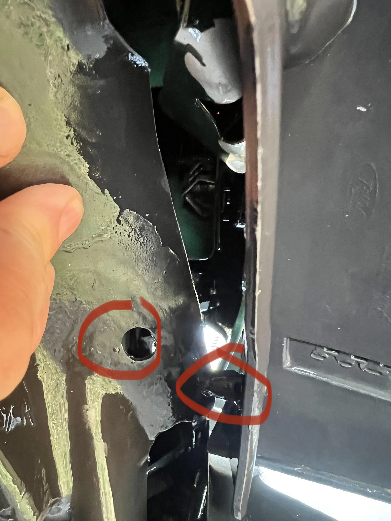

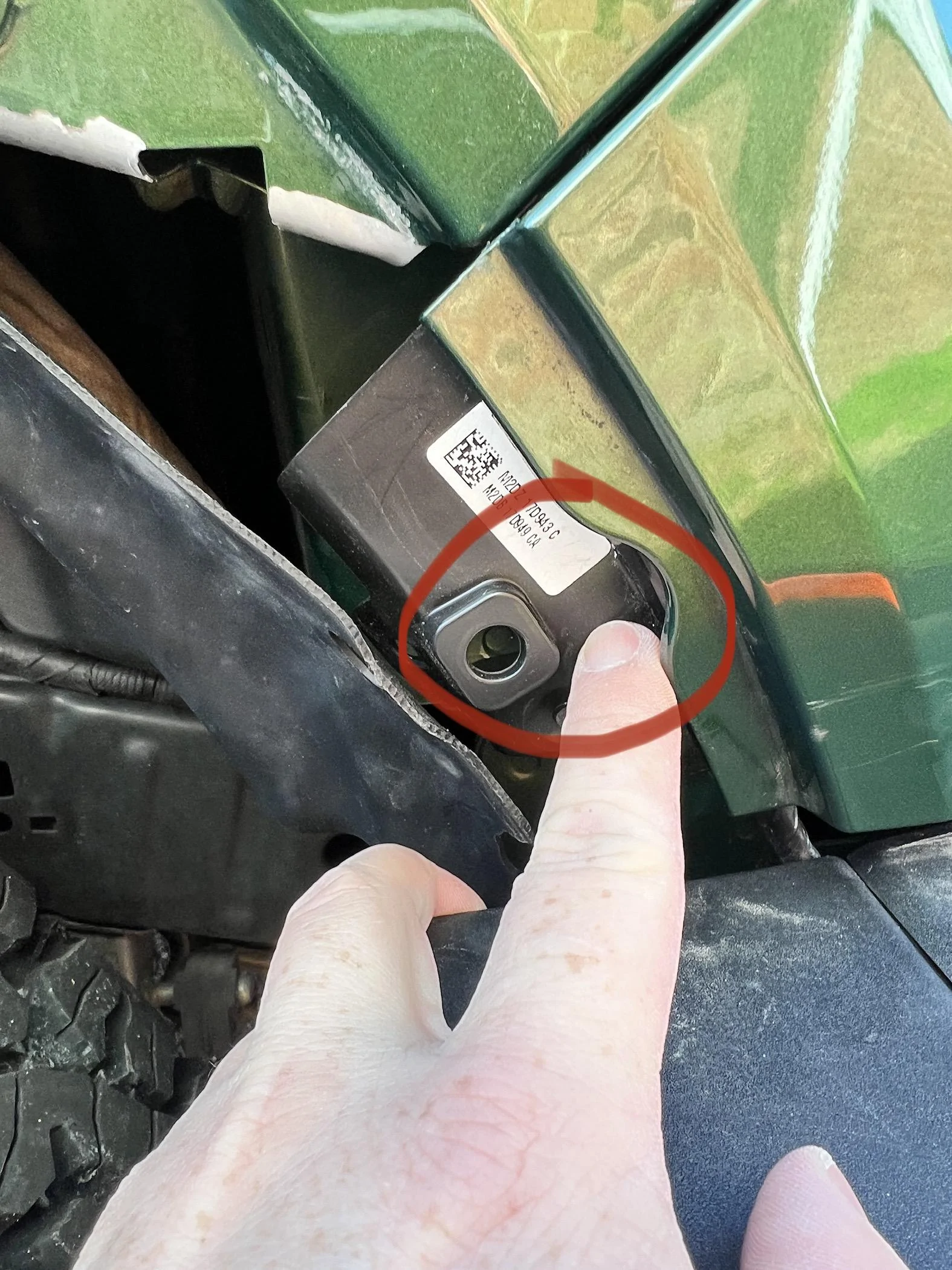

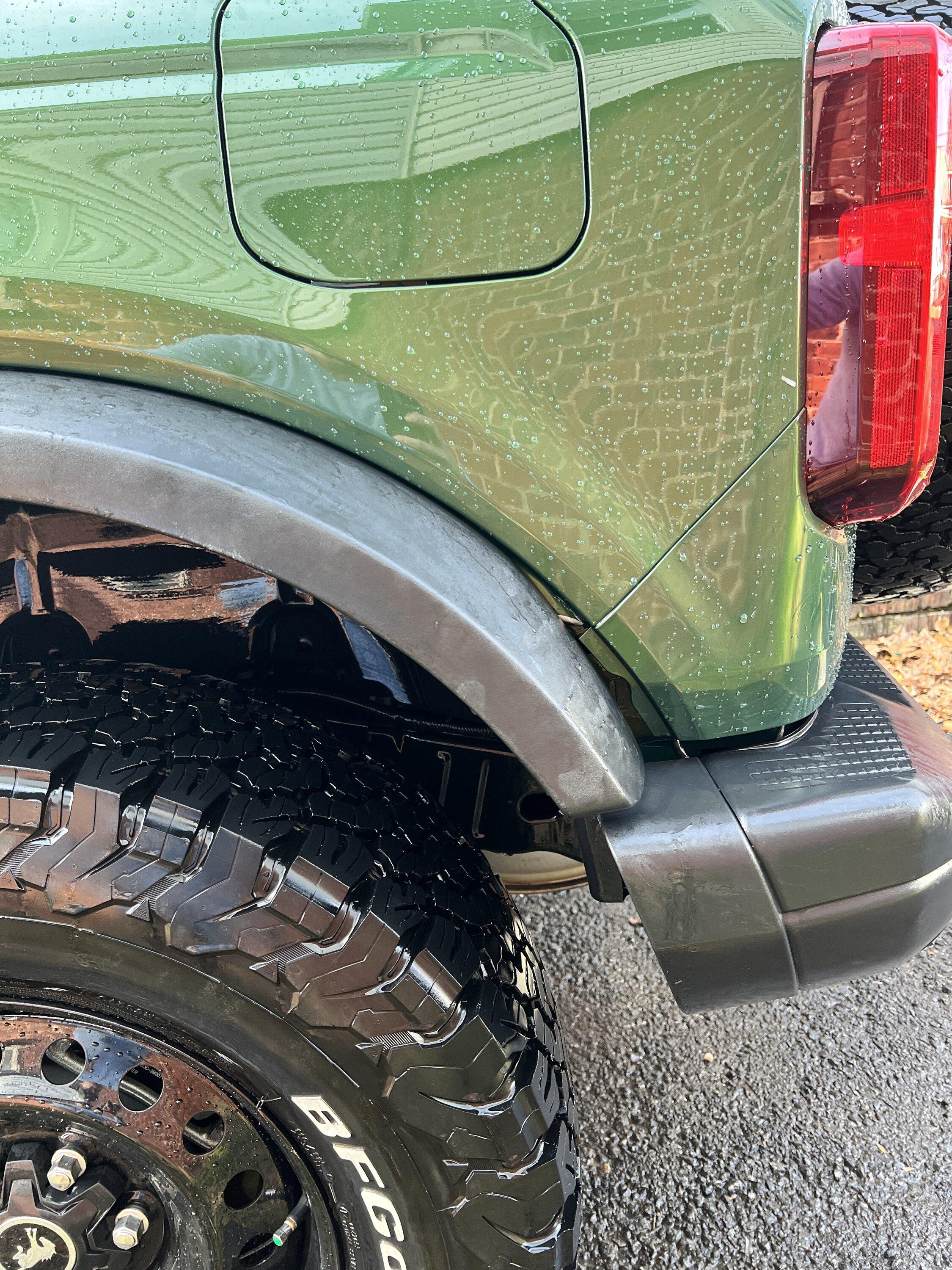

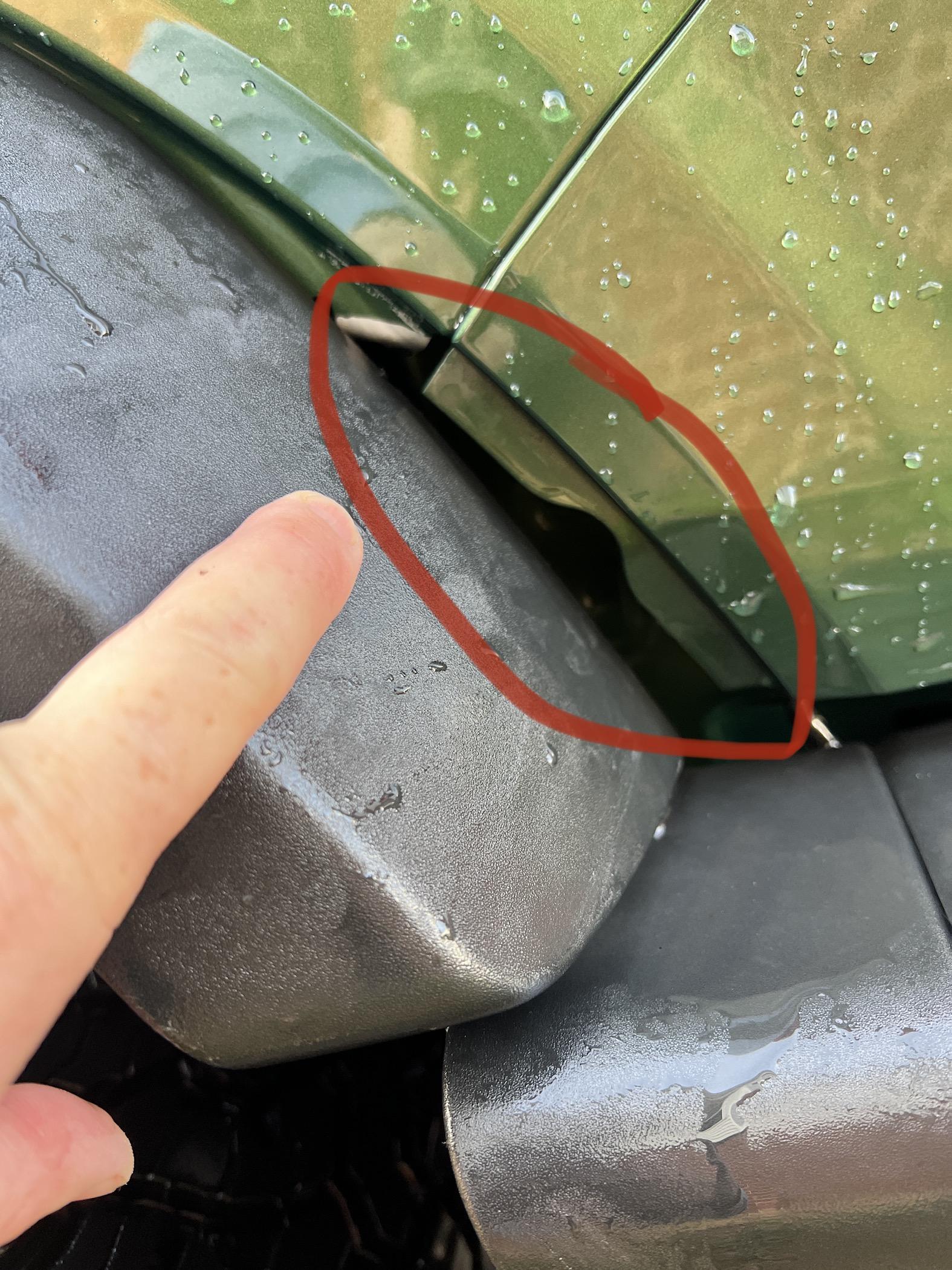

Well, @flip, the part came in, but something isn't right. You'll notice the orientation of the center "hold" tab on the new part runs "north south" while the original ran "east west." Had to trim a little off each side to make it fit on my bronco...Figured no big deal...
But after mounting the part, the hole where the last tab on the removable fender goes sits outside that little curved area, whereas on the original the hole was more inside that curve....so the Fender isn't snapping in right.
I don't think this is the right part.
Any ideas?
Ford Bronco Minor Fender Damage....Help with part(s) IMG_1487
Ford Bronco Minor Fender Damage....Help with part(s) IMG_1489
Any ideas?
Well this certainly bites. DM me you VIN and I'll try again.
