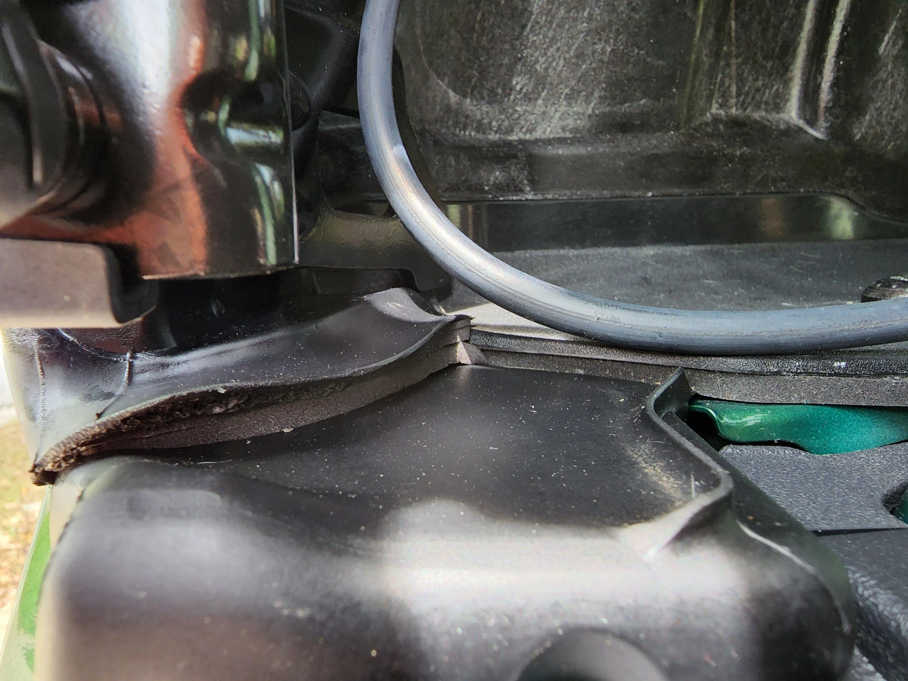

That’s bizarre. Can you find any wet areas around the seals?
Kludge
91
101
Greensboro NC
Subaru Outback
Mine had a leak that was repaired under warranty. Unfortunately I was unable to get a great explanation of what weather stripping they replaced since the dealer outsourced to a third party "water doctor".
I think the issue on mine were the corners of the rear window were channeling the water incorrectly causing it all to drain into the rear of the bronco. I found leftover weather stripping similar to what's in the picture below. Just my best guess though.
Either way take it the dealer and let them figure it out.

thanks for the info, thats where i am guessing it is coming from
