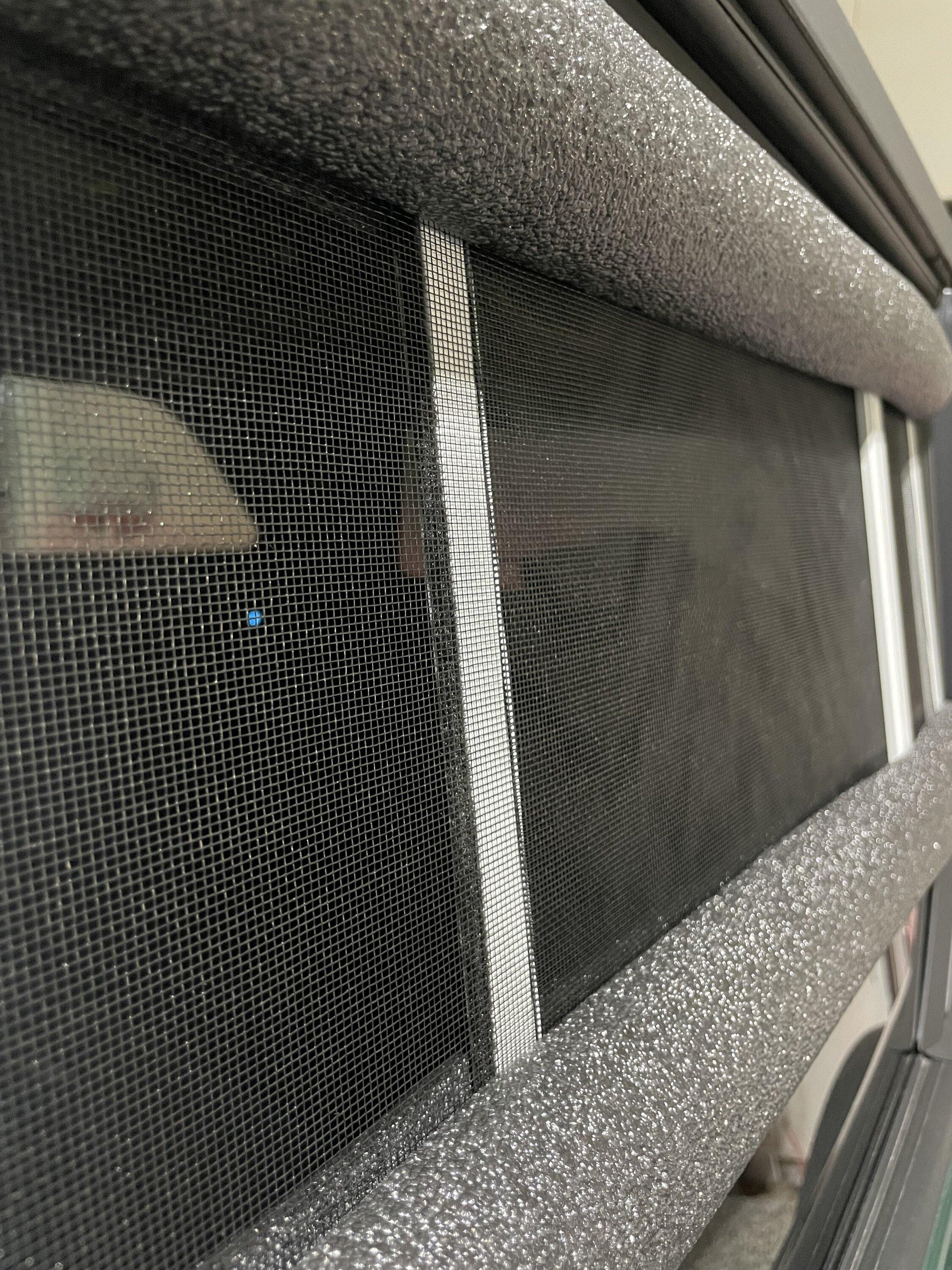

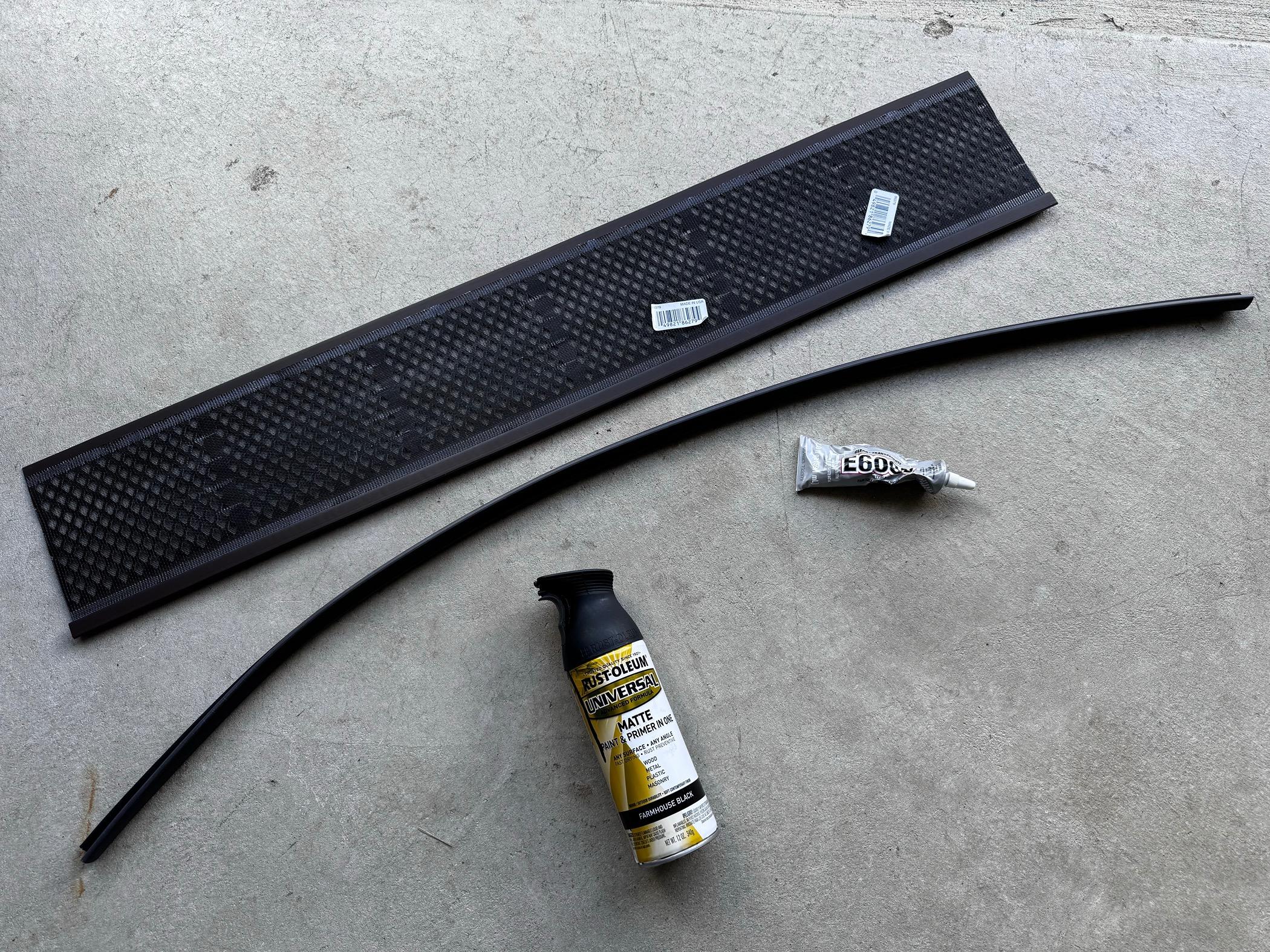

Many of the window screen / vent options out there do not work in the Bronco because they are designed to go around the window frame (which the Bronco does not have).
I have seen several Bronco options available for purchase (one is nearly $200!!), and I have seen several do-it-yourself options, but they do require some cutting / gluing, etc. .

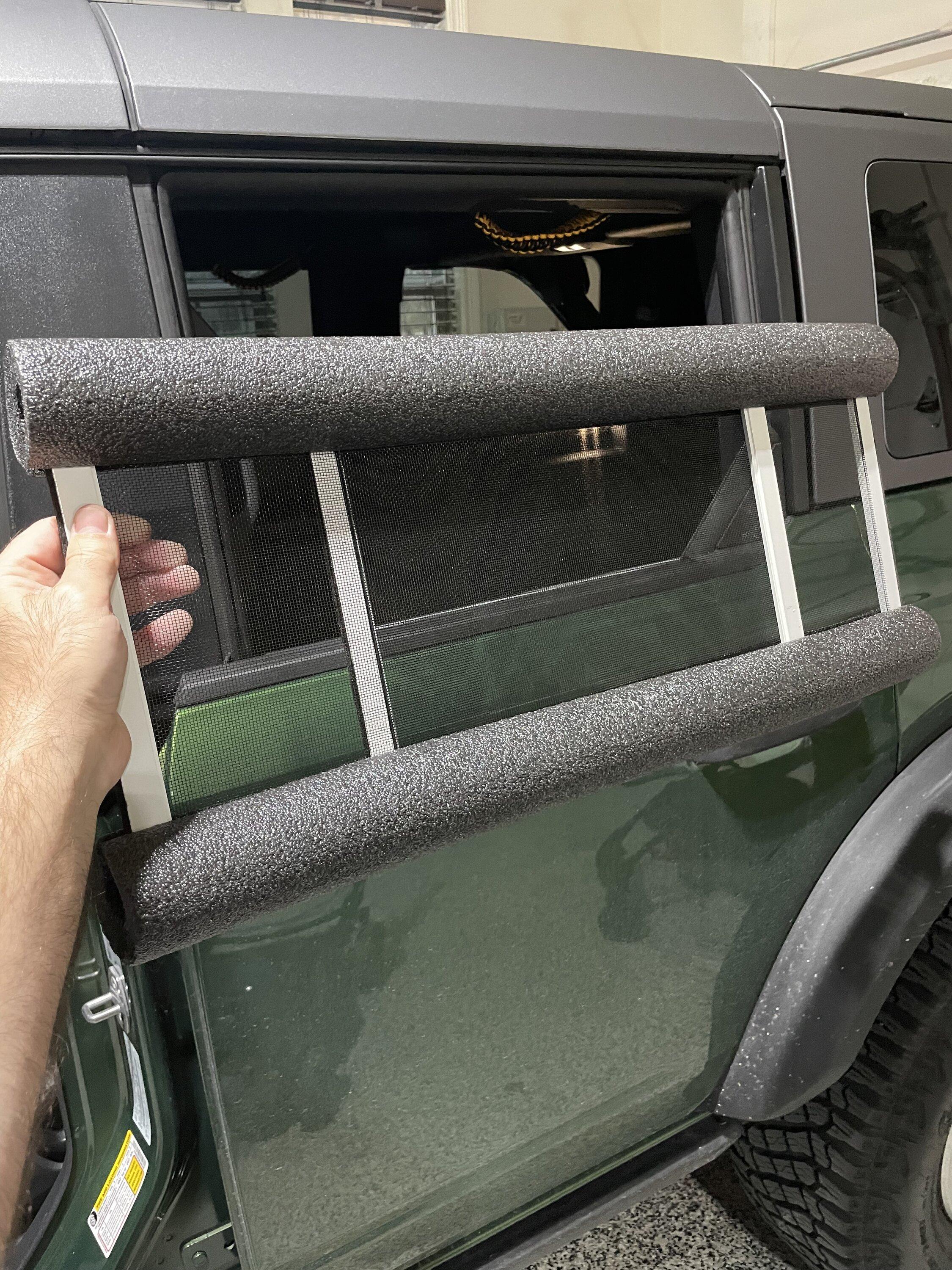

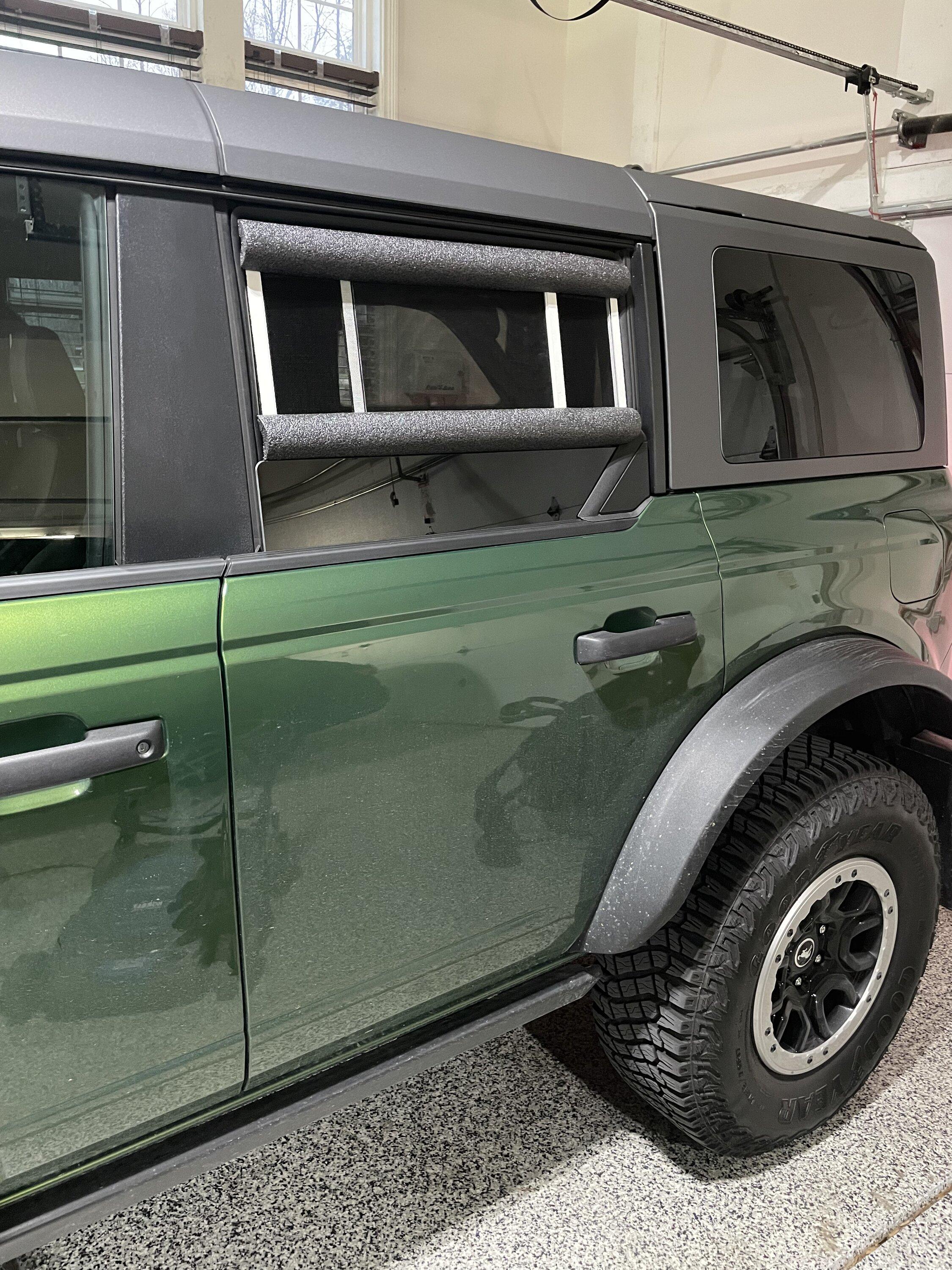

So I went to Lowe's and I found this adjustable window screen that was like $9. I adjusted the width, I put some pool noodle foam on it, and it fits quite snuggly in the rear window. There is a tiny 1 mm gap on one of the margins that I will fill or cover with something - maybe a strip of painter's tape.
I think this will work very well for my needs. Total cost was about $15. The work and time involved is almost nothing. Takes less than 30 seconds to put in or take out. Definitely easier than some of the other DIY options I have seen.
