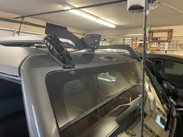

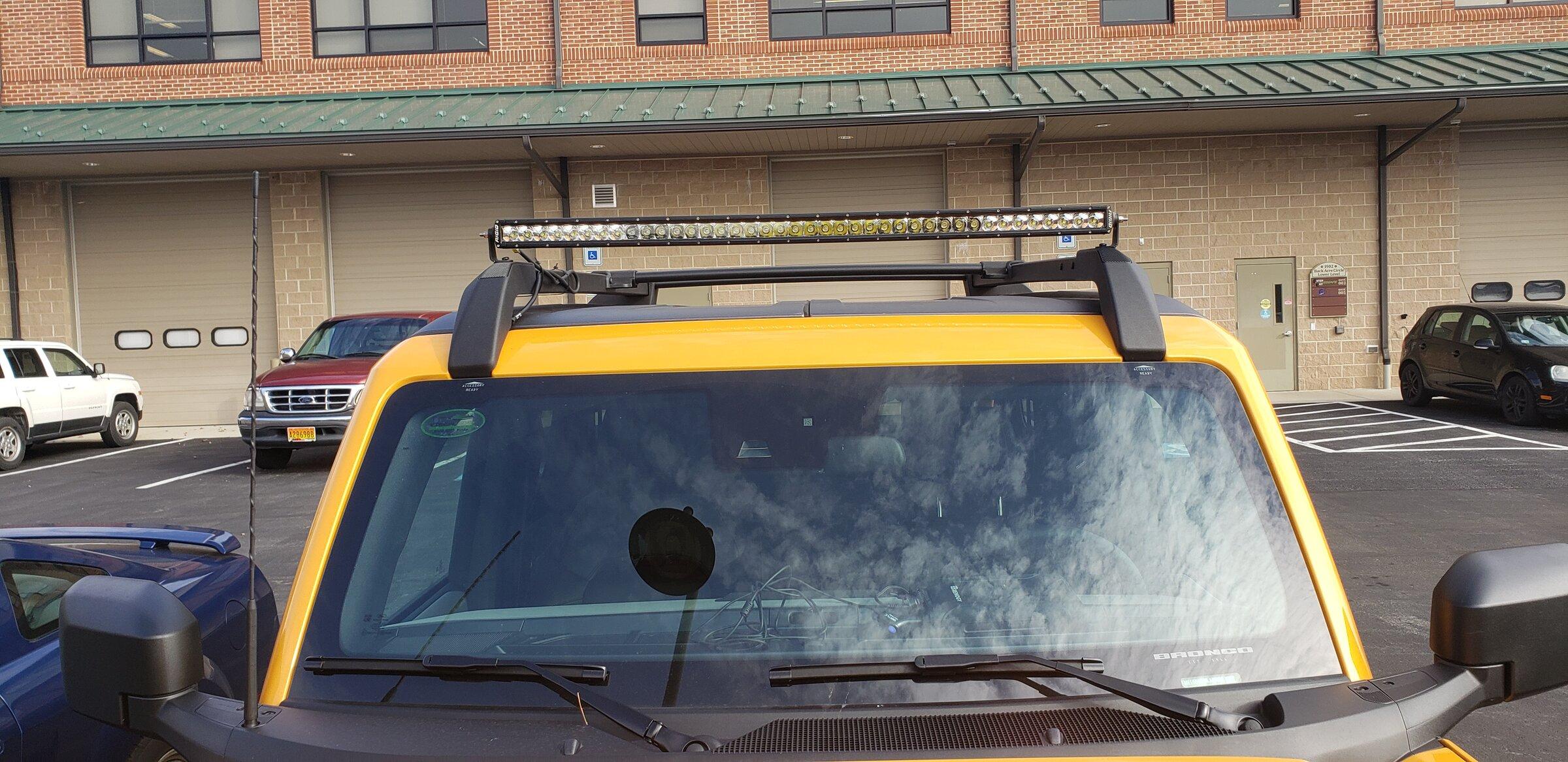

Here's a better pic of the rigid bar with rigid roof rack bracket

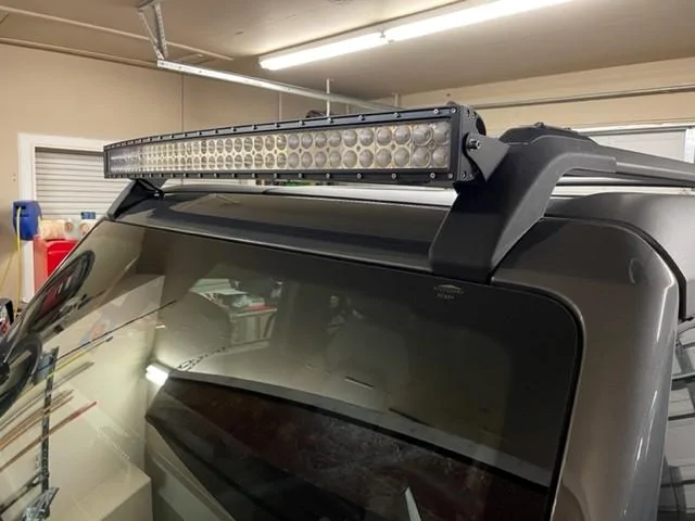

Ford Bronco Light Bar With Roof Rack? 20220213_120717

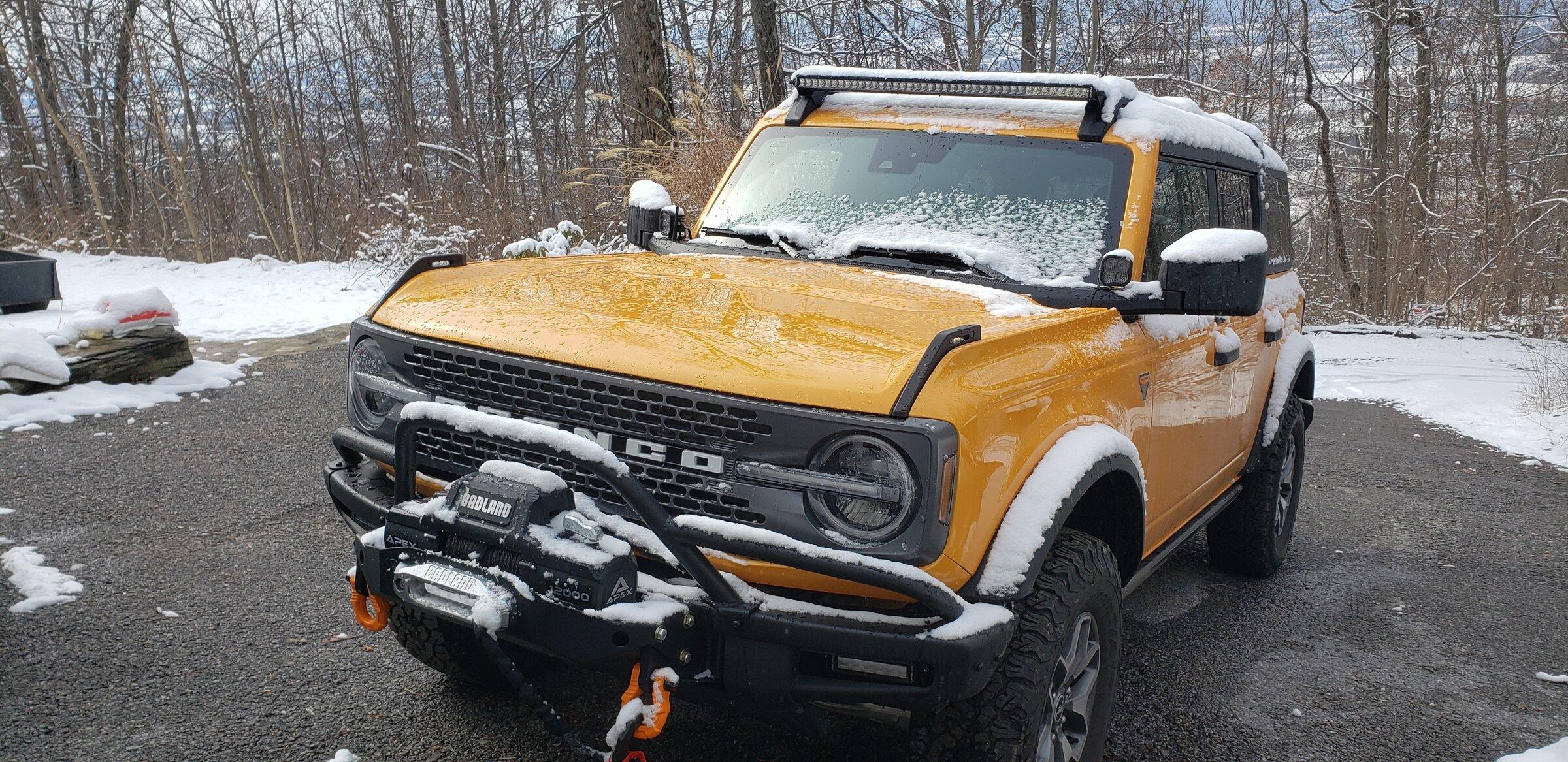

After about a 3 month backorder - mine finally came in.
Oooh really like the size and look of yours! What brand/model? Using brackets that came with it or sourced elsewhere??
wcmaness
Wesly
May 4, 2021
66
199
Arlington, TX
'21 Bronco OBX; '11 Armada; '02 Tahoe Z71; '91 XJ6
The mounts are made by Rigid: Part # 46725 - made specifically for the roof rack mount on the Bronco. The light bar is an old Shanren 42" curved 240w LED which I bought in 2016 for my Tahoe.
Gary, 99% sure this is what I want but how hard is it to take the rack and lights off? Does it disconnect in some way, shape or form? We will most likely live the rack on most of the time but I know the wife will want to remove the top when summer rolls around and that could be problematic.
Thanks!
So From rigid their is no disconnect. meaning that its impossible to take off unless you cut the wires. But I was looking into just cutting the wiring and adding my own waterproof disconnect. If you did that it would be super easy to take of the lights off because the first 4 screws you need to take off to remove the roof rack are the same screws that hold the rigid mounting bracket in. after you take those screws off you could use the disconnect to unplug the light bar and take whole light bar and brackets off the roof rack and then ether put the screws back on or then remove the plastic shrouds and continue your removal of the roof rack. The only issue I could see is you have the one end of the connector just dangling from your roof that you would have to hide behind something (not sure if it would fit behind those little plastic caps they give you in the glove box). So if you are just removing your roof rack temporarily to get your middle piece off for a more open air experience it would be a snap once wiring a quick disconnect in then attaching your other end to the roof rack with some Velcro or something, however if you wanted to take the rack off and keep the whole thing off you might have a hard time finding a place to attach your other connector end that doesn't look nice unless you can sneak it underneath those plastic shrouds.
another note if you do drill a hole into your car to feed the factory wire through make sure you back fill the hole with some silicone sealant.
I will say that with the roof rack still on I have removed the front panels with little to no issue and that really is enough sun and wind for me and my fiance. there is a little learning curve with how you have to angle the roof pieces when removing and installing that I imagine would be a thousand times easier if it was removed but it can be done relatively quickly once mastered.
TLDR:
No quick connect from the factory making removal not easy. you could install one relatively cheaply to then make removal very simple.

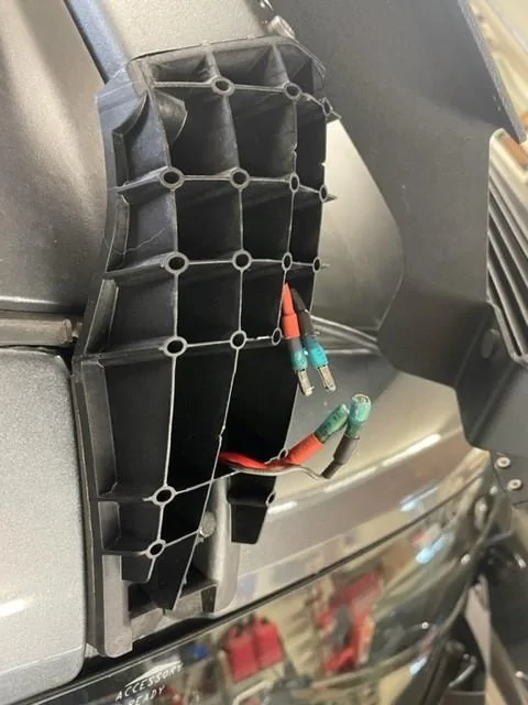

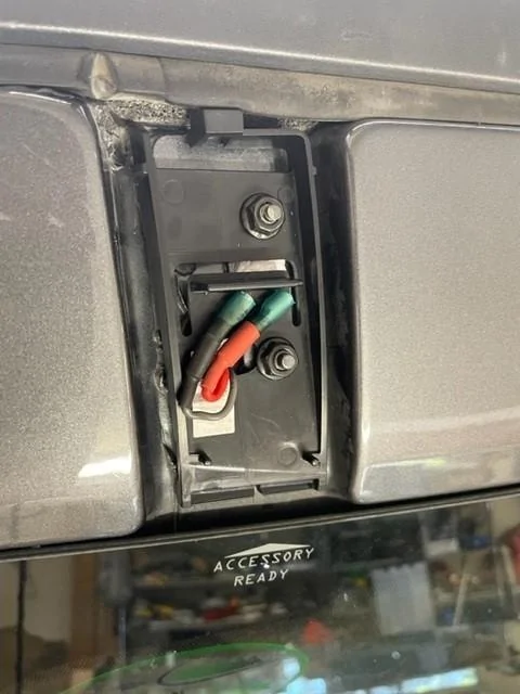

I have the roof rack with light bar combo. I wanted to be able to go "all open" and take the rack and roof panels and doors off, so I made my own quick disconnect with bullet connectors. Easy on & off now (see pics).
Ford Bronco Light Bar With Roof Rack? QD2
Ford Bronco Light Bar With Roof Rack? QD3
Ford Bronco Light Bar With Roof Rack? QD4
Ford Bronco Light Bar With Roof Rack? QD6
Ford Bronco Light Bar With Roof Rack? QD7

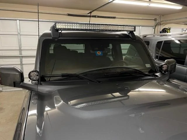

What brand is that?

I'm surprised your 42" light bar worked. I think a 40" comes with the rigid kit. Do you have to modify the brackets or anything to make the 42" work?

It is a snug fit for sure, but I think the 42 inch has a almost 2 inches taken up by the curve. So it may be a 42 inch curved bar, but straight across it’s more like 40 1/2.

That curved light bar looks great. Who makes it please?
It is a: SHANREN 42" Curved 240W LED light bar.
I've had it for a while before I bought the Bronco (lucky fit), so I'm not sure of its current availability.
