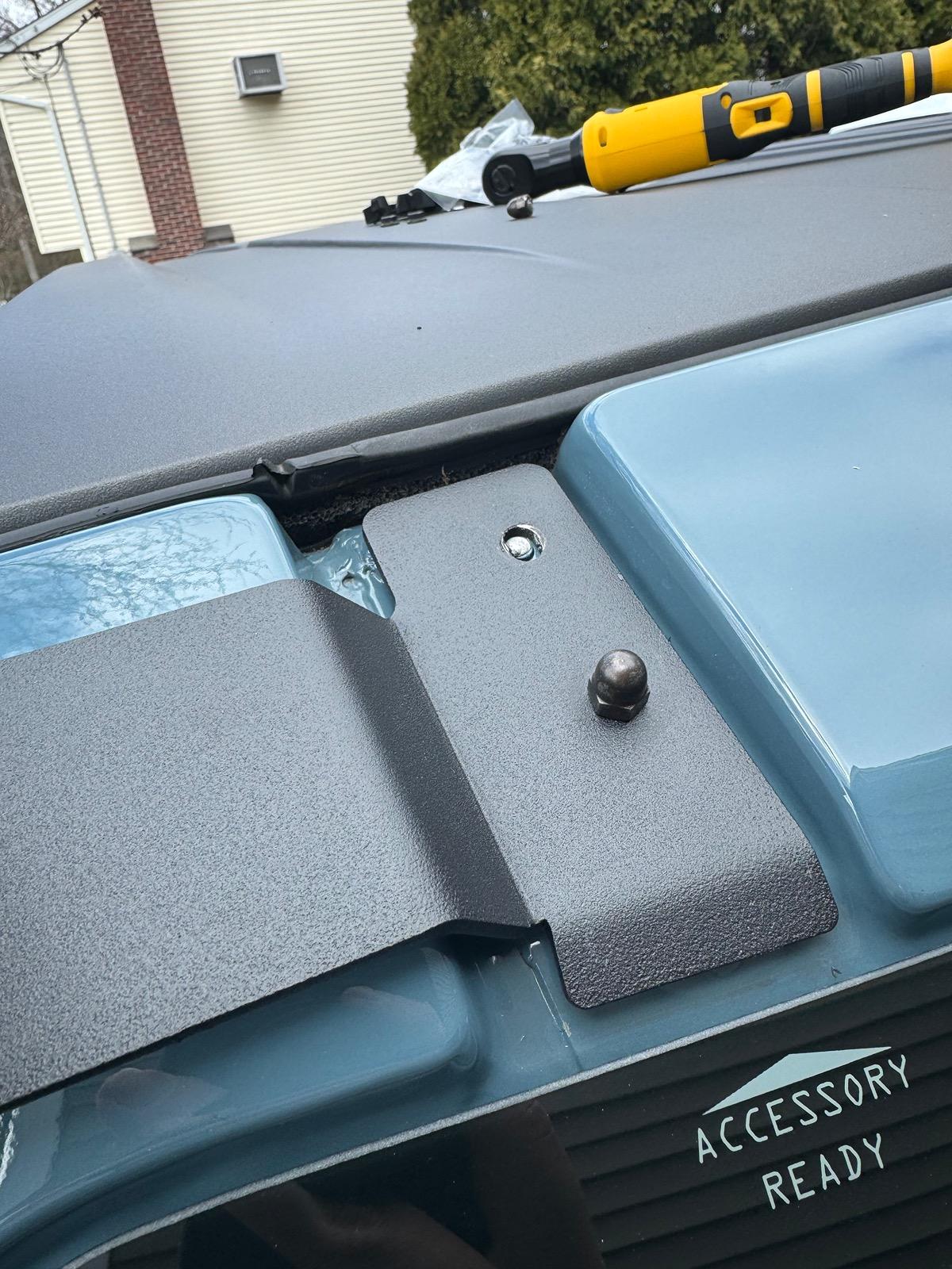

Anyone have the screw snap off when installing the mounting bracket for a light bar?
Also, is the screw accessible and is it able to be removed and replaced?

Looks like you get to play with some ez-outs. Have fun.
The screw is a stud that bolts in from the inside so that wouldn’t work. Would have to access it from the inside if possible and just unscrew it.

This has happened before. I know the search function is flawed but give it a shot using google instead if you haven’t already. If I recall it’s a case of using two ugga Dugga’s when only one is required. Unfortunately, I think it’s not as easy as just unscrewing from the inside.

Thanks! I found another thread and it seems like at least one person had it warrantied
