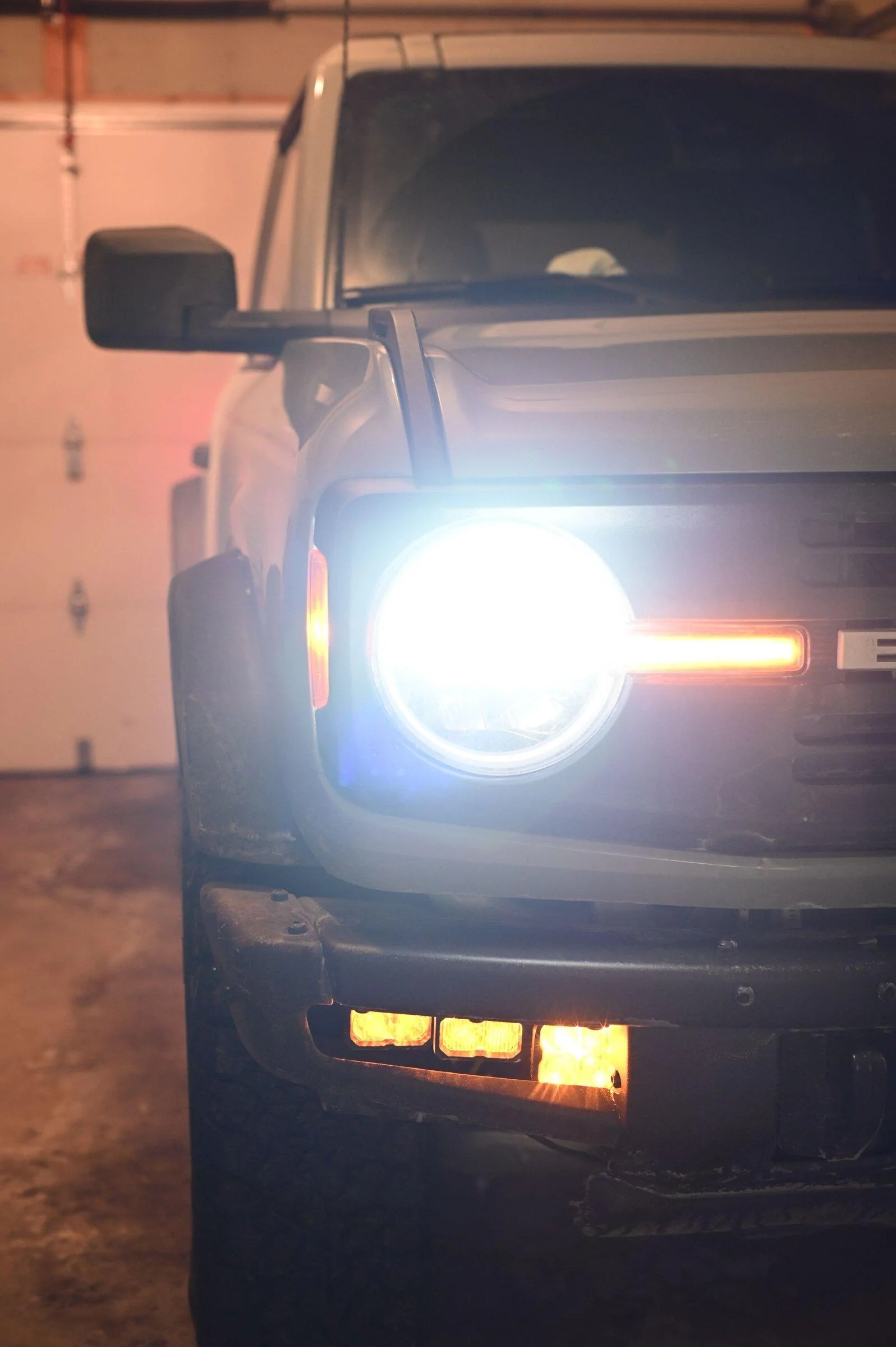

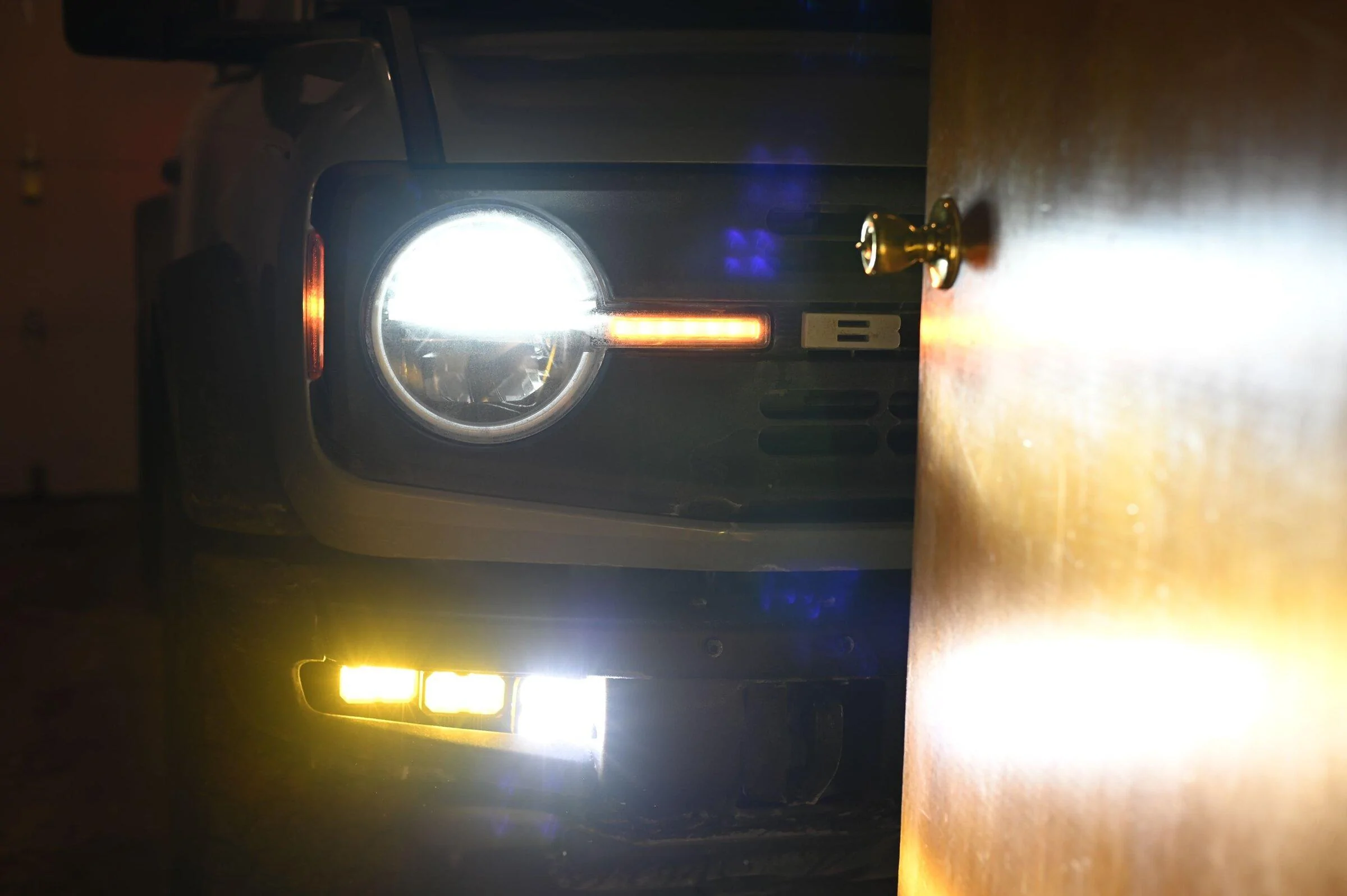

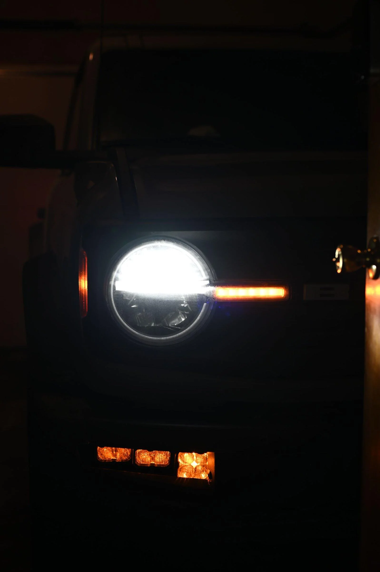

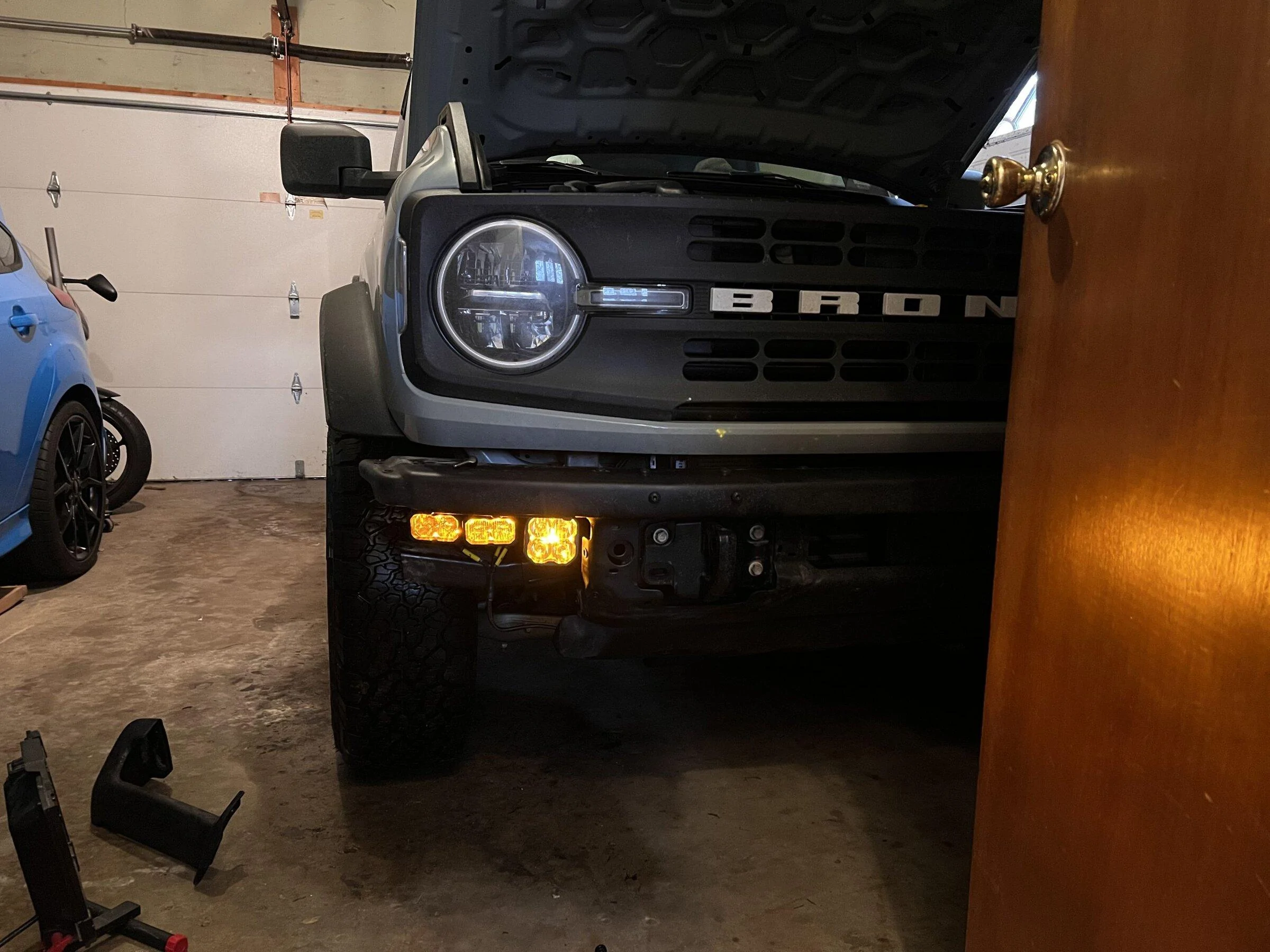

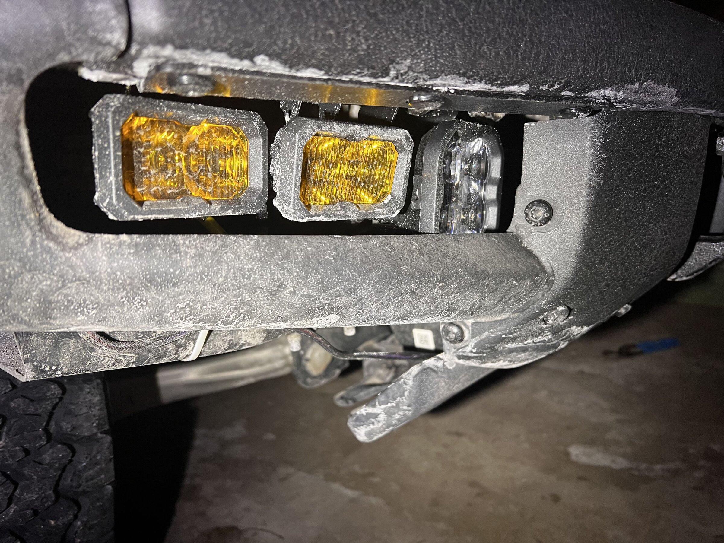

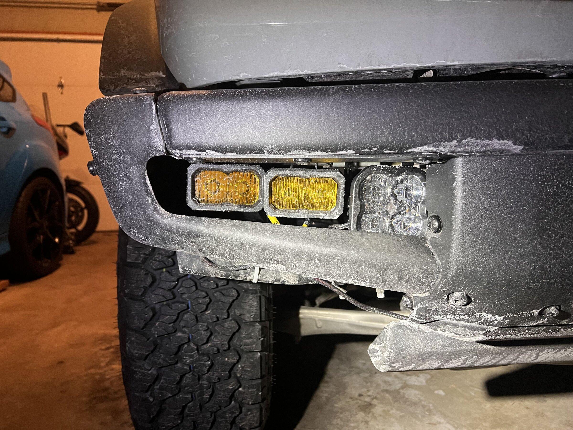

You can see roughly where I tucked the lights. The middle one that is pointed way down is the fog lamp. I've driven around with it for a little bit and so far haven't gotten any high beam flashes from it.
The aiming instructions for the driving lamps is pretty good. Get about 25' from a wall and line them up with the low-beams. Haven't been out on a really dark country road to try them out, but around the neighbor hood I can light up a house from like a block and a half away. They complete blow the factory high beams out of the water.

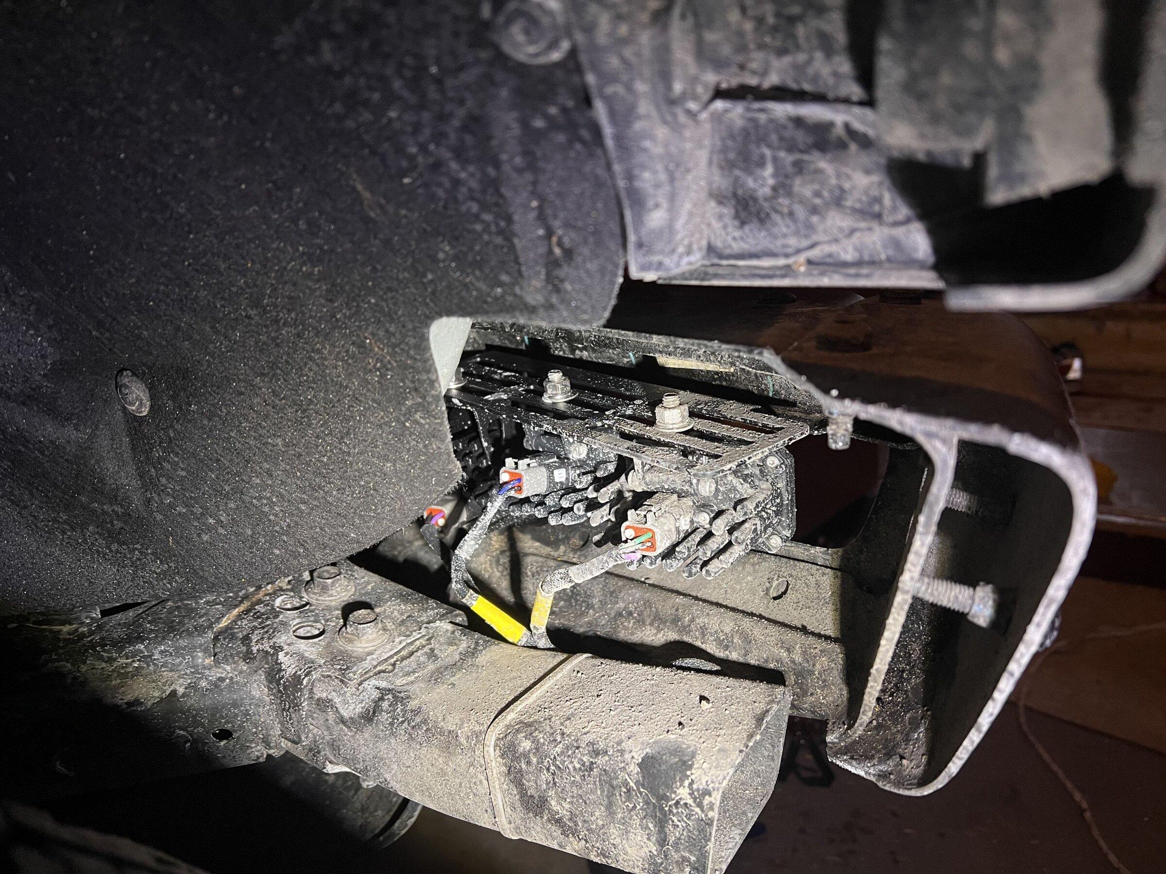

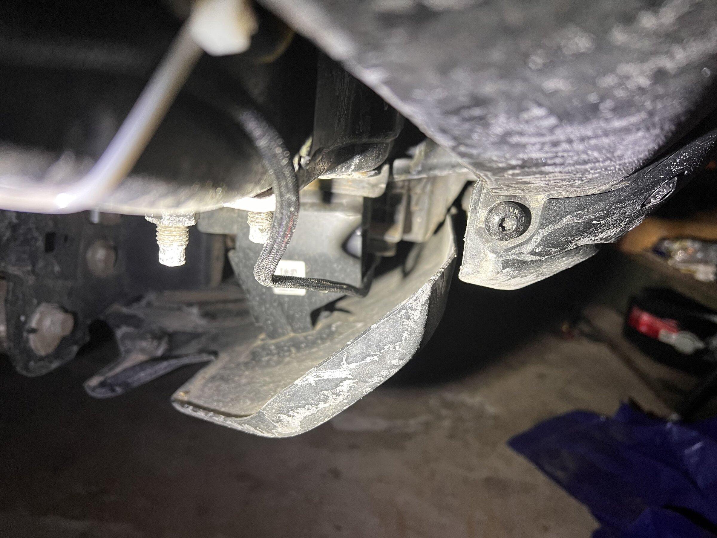

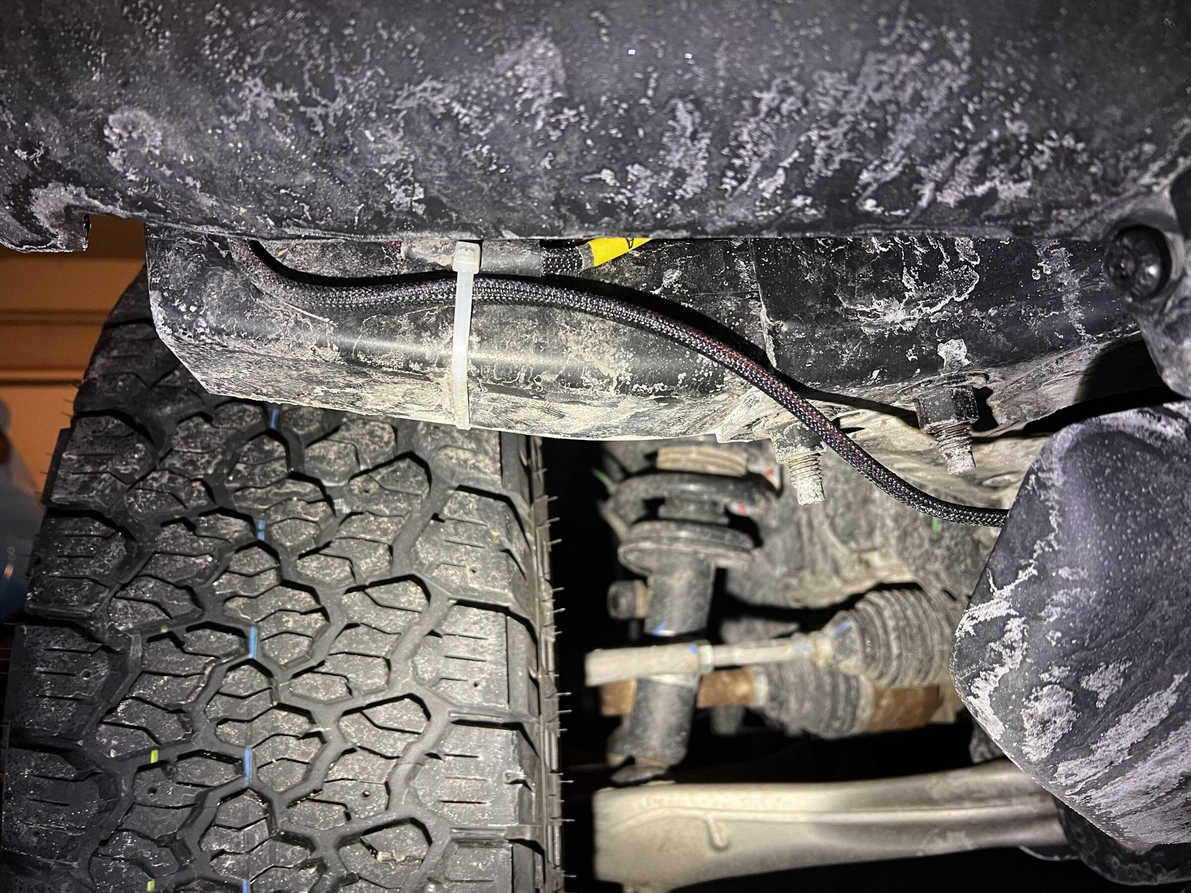

I ended up zip tie-ing the harness to the crash bars on both sides. I don't know what you would do if you had a Sasquatch. Maybe zip them to the bumper itself?
You can also see how much salt gets sprayed on the back of the lights from the open wheel well. Make sure you get the connector clicked all the way in, or else your lights will suffer a quick death from all the moisture and contamination. I'm debating opening them back up and shooting some dielectric grease in there to be honest.
You can also see I have the 4 bulb lamp in the rear-most slot, and the smaller ones in the middle.
In the number 1 position (most central to vehicle), I was able to get a ratcheting wrench over the nut in the 3rd slot, but if I were to try to install in the second slot the wrench would have been trapped. That might be a bad verbal description, but if you end up with this kit I think you'll get what I'm saying.
