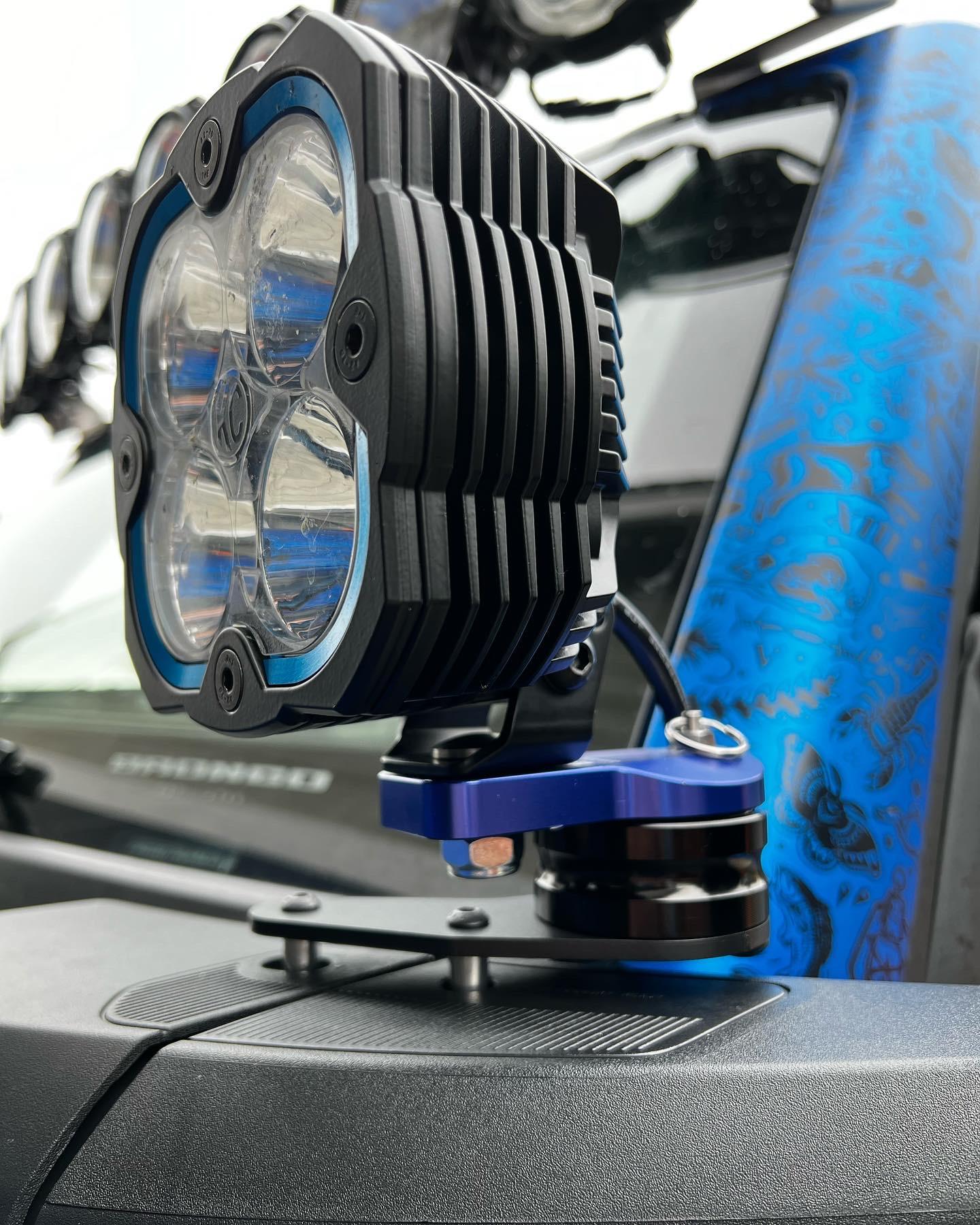

thank you for this post. my Flex Era 4's are coming in soon. originally was told they mounted directly to the accessory point, but that bracket/mount combo looks perfect.
They can mount directly if you change the bolt hardware -then you give up the lock no turn bolt- I recommend using a bracket keeping the lock no turn bolt .

Awesome, thanks! I just ordered the Body Guard mounts.

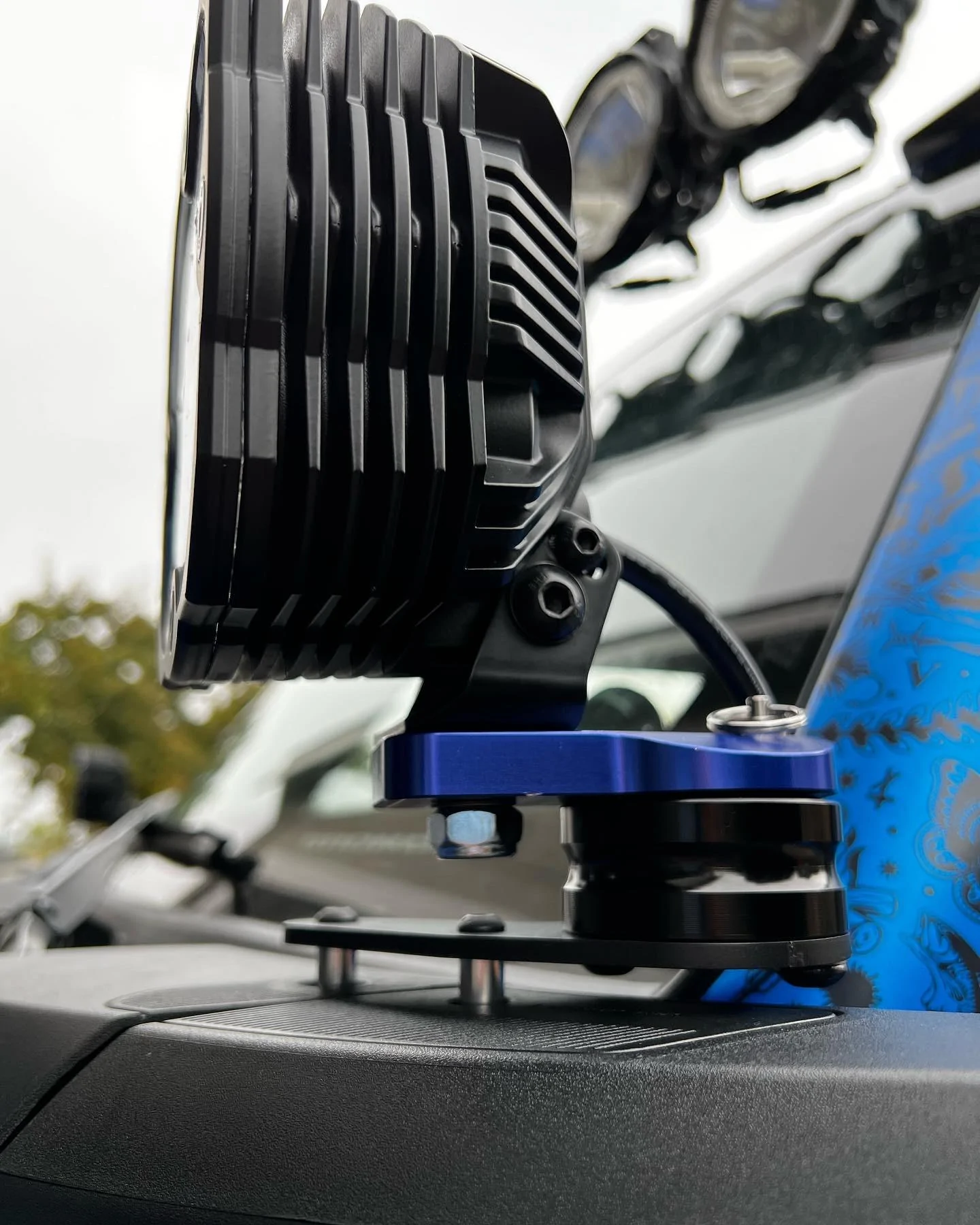

Hey there! Finally installed my lights using Body Guard mounts. I didn't think the Body Guard solution would be my ideal, but I think I like them overall and the look. I definitely like the multiple mounting point options, I went with the outside option on each side and slid them to the inside most point. I used 1/16" neoprene fender washers (about 1.5" inch wide) under the mounting bracket so nice soft mount to plastic cowl part. I like the KC Flex Era 4s overall, but the wiring connection attached to each light is a little shorter than you would like as you can't unplug at light housing and then is in a difficult connection place under the hood at upper most edge.

on my set up i did remove the antenna to place lights where i wanted just personal preference . you do not have to remove antenna at all there is plenty of mounting options with mount flip it or have right or left positions that place the light in different locations and also the turn bracket have the option mounting light close to window or further away on hood - really countless ways you can mount it -play around and find what works for you.
