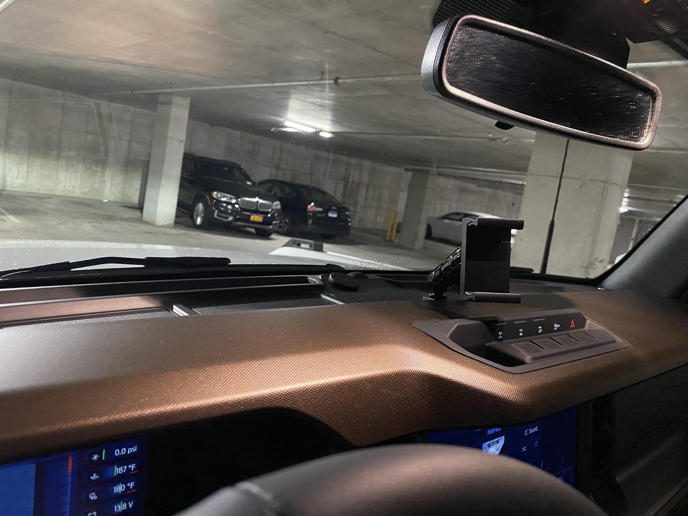

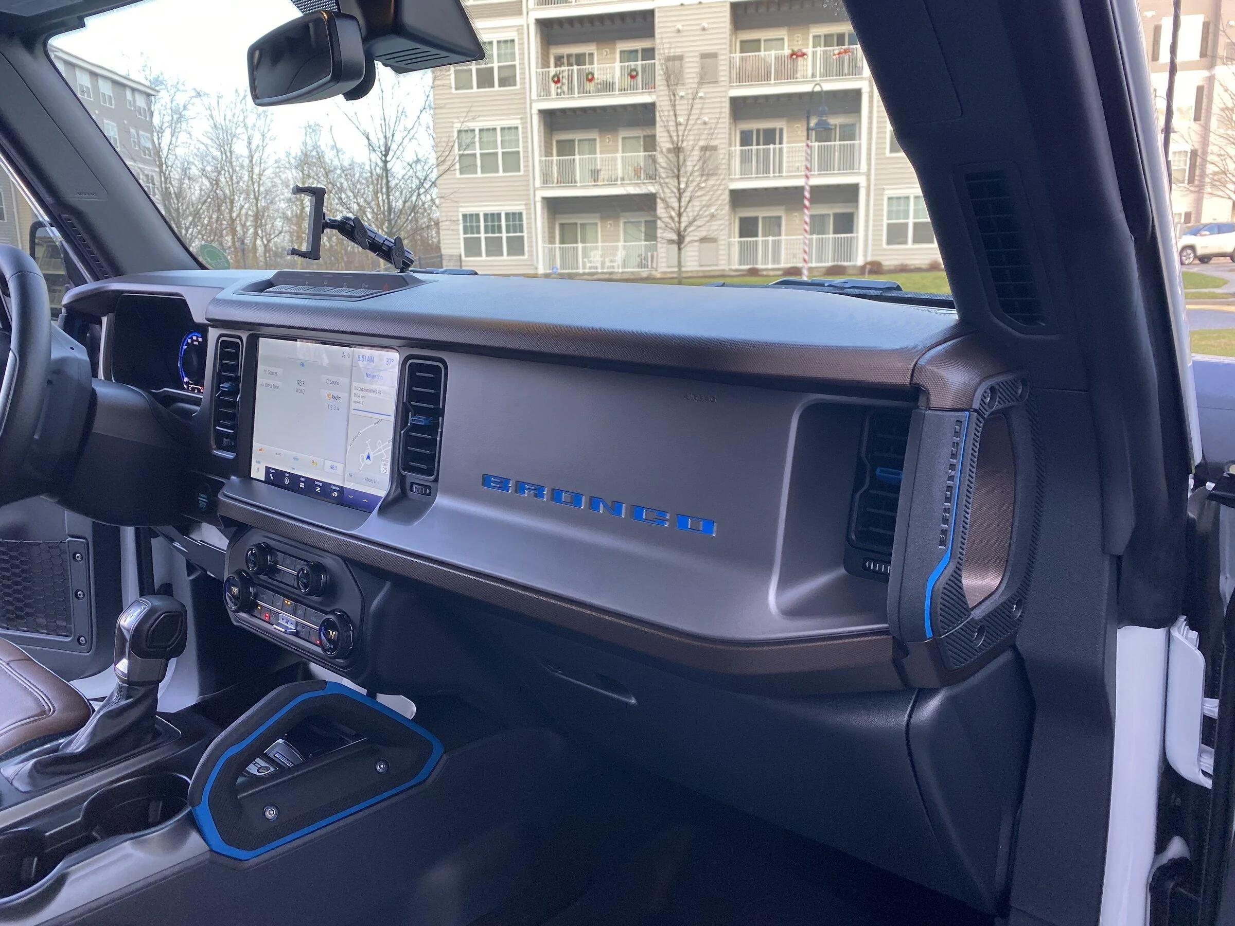

Did you have to take apart your mount base and add thread locker? I have the Tacform as well but it worked the base loose in one day. It's an easy fix though, pops right out of you remove the two T25 Torx screws. Also, the Tacform mount rattles a bit and I had to add a small piece of Gorilla tape between the two metal halves to stop it. And check the spring screws too they didn't come very tight.

1 spring screw was loose when it arrived. I tightened all 4. All the rest has been good. I'll keep an eye out, but working currently as advertised.
