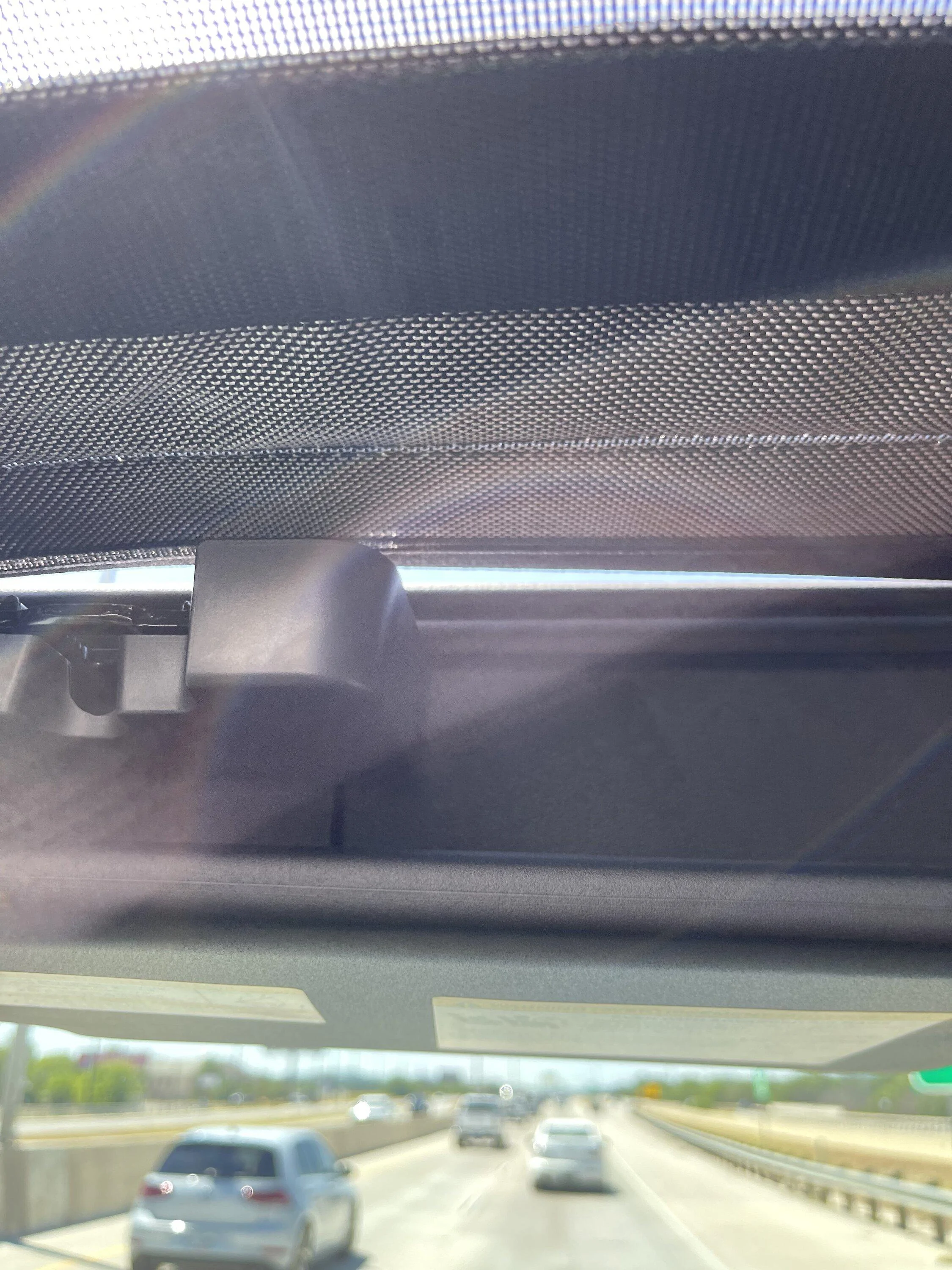

Hey y’all need some guidance…just got JTop installed (love the top) but I’m having an issue with the front flap not staying flat above the soft top attachment bracket on both sides. Took this photo at 65 mph into an 11 mph headwind (did same thing coming home with same tailwind). I can’t seem to get top to stretch far enough to weather stripping seal (front to back) or tight enough across in an effort to keep flap tucked down.
Are my expectations out of line? Anyone else experienced the same and found a fix? If there was a way to attach something to top to attach to soft top bracket, I’m thinking that would be a winning solution. Thanks in advance for any/all guidance if you have same top on your rig.

Is that where the loop straps are for the hooks? Mike says people wanted the straps to make it easier to unhook (no idea why), I cut them off with a pair of scissors and now it sits lower. I’m actually going to be pulling mine off this week and resetting it.
The one thing he told me was that you need to seat the rubber flap all the way in before you unroll and start using the Velcro. That’s the biggest reason I’m redoing mine

It’s outboard from the hook straps…between them and the location for soft top latch. I may have to bite the bullet and pull mine off and reset as well. I’m still not 100% confident that will solve the issue but it’s worth a try.

Mine does this as well and I’ve noted that above 85 the wind gets under that front flap and flips it all the way up and back. I haven’t really looked to see about adjusting it, but when I flip back my soft top, I make sure to pull out and down on the front magnets when I flip the Jtop flap down. Seems to do ok and I don’t mind the small gap you’re picture shows.

Did cutting them off make a difference with seating it?
IMO...yes. The straps were causing a gap between the top and the weather strip where wind could get in and cause lift. I cut them off and it made a big difference.
