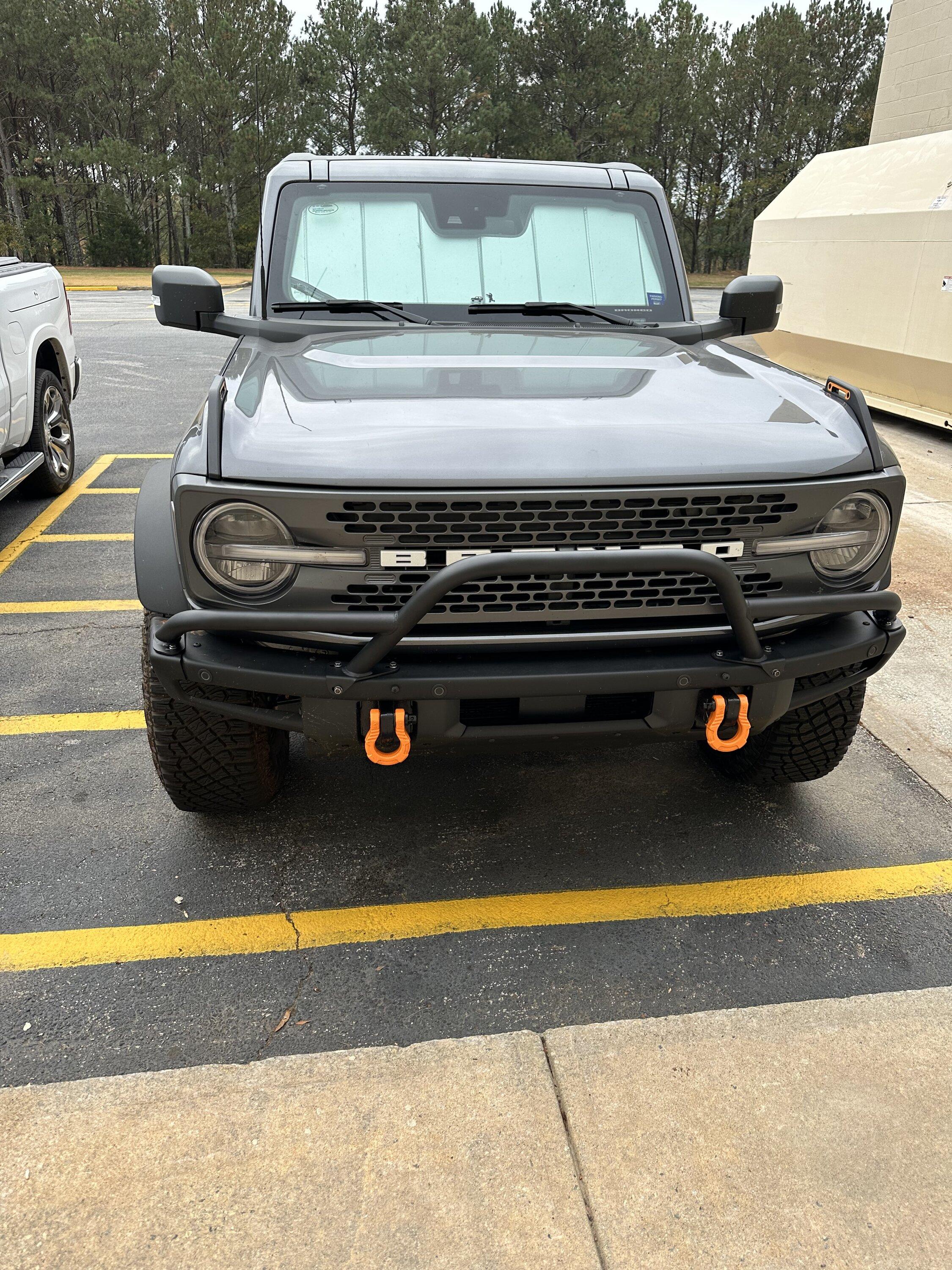

Maybe repeating info but just installed JCR Prerunner tube on 23 SAS Badlands MOD bumper
Instructions called for bolting from center outward - this did not work for me - the two outer forward bolts right under the prerunner tube bend has zero room to drop bolt into threads …. The tube prevents access.
With saving the outside bolts to last, as instructions indicated, I had to unbolt everything and start over. With bolting these two outside bolts FIRST I got the whole thing on easy.
Just wanted to save you all time

Oh and the front camera still works fine with these tube installed if curious.

Looks good, I have the same setup. It’s held up great so far.
