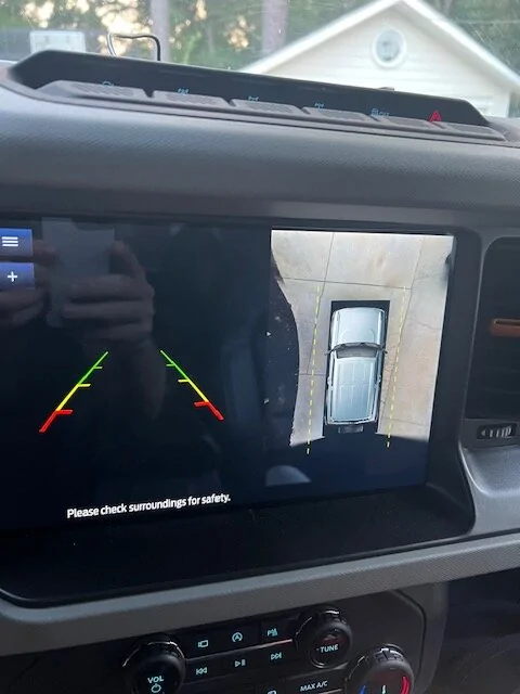

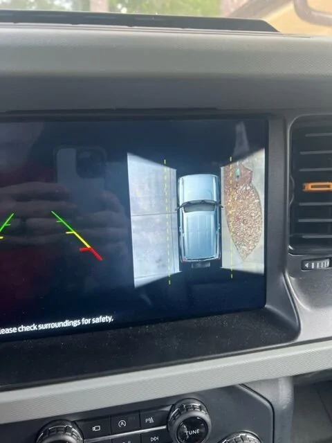

I am having intermittent issues with my front and rear camera. Sometimes front does not work, sometimes rear does not work, and sometimes neither works. I took it to the dealer and they said that the problem was caused by dirty lenses. I am a little skeptical that a dirty lens would cause the camera to not work at all. They still have the Bronco while they try to work out a funny noise and vibration I'm getting, but I don't want to pick it up and have to bring it back for the cameras again a second time if I don't have to. FYI they usually work, but every couple of days one or both of them won't work and 10 minutes later (or even 2) they will. Anyone heard of anything like this? Anybody ever had the same problem fixed by cleaning the lens? Suggestions for what I should tell my service advisor?

What was the fix i started having same issue

They replaced my front and rear cameras.

Yeah, so they just replaced one of our cams and the entire wiring harness for the camera system for the same problem.
