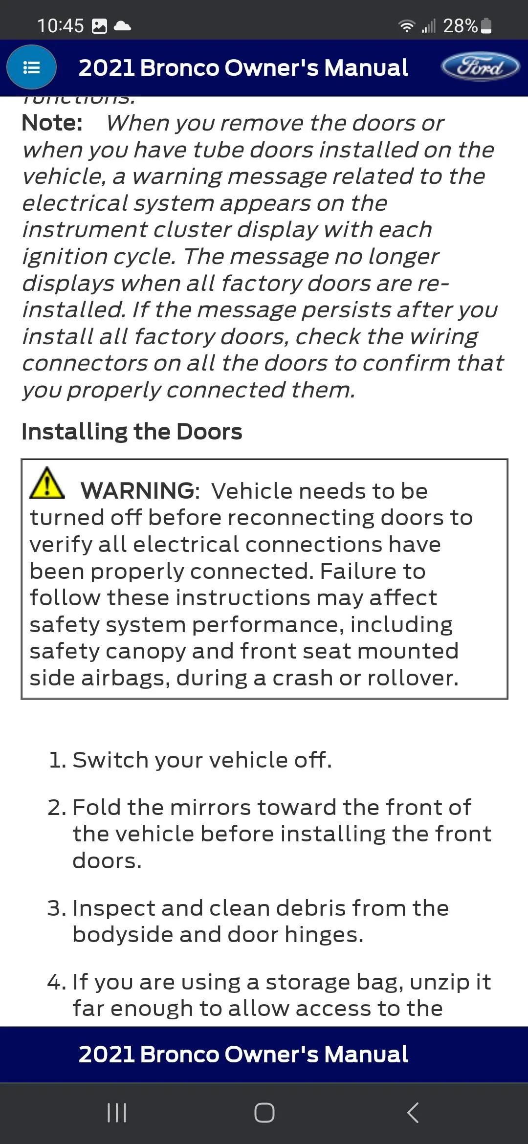

I tried it with seatbelts on.
If the doors are still off the message is normal. You'll get a different message if you drive with no seatbelts with doors off (so that's my bad).
Thank you Jason. So the message is normal with doors off. That solves my issue. Awesome that you looked it up in owners book. I should of looked it up myself. Too bad when I asked Ford dealer they didn’t know.
