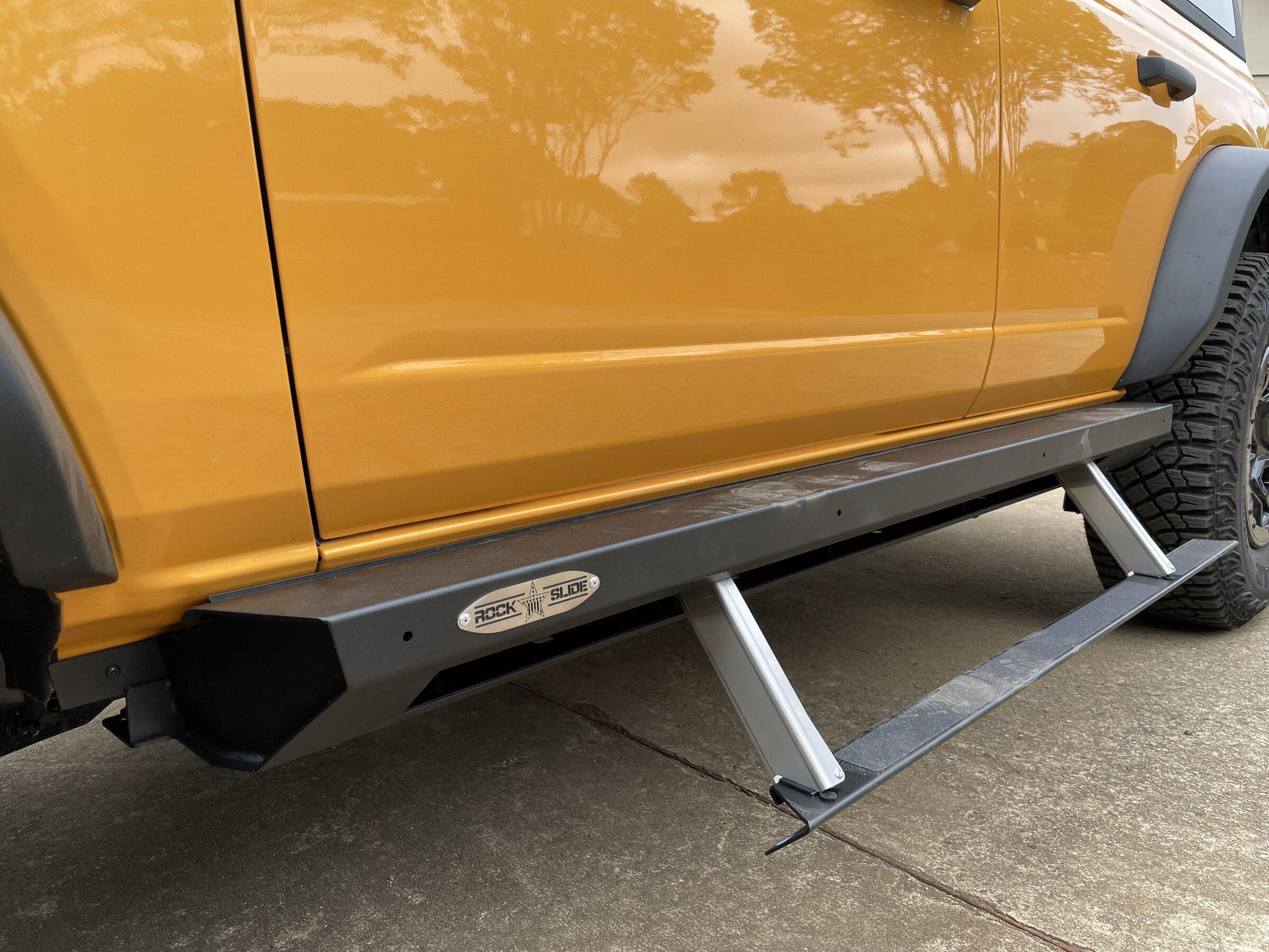

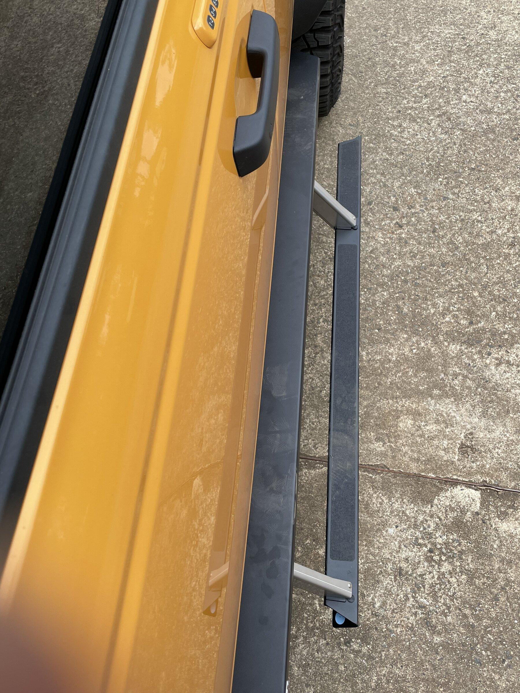

I ordered my bronco without any steps as I was planning on installing AMPs like put on my F250s. H, when I saw the Rock Slide Engineering step sliders on Motoroso's youtube, I knew that I wanted them for the extra protection over the AMPs, so I ordered them from Motoroso.

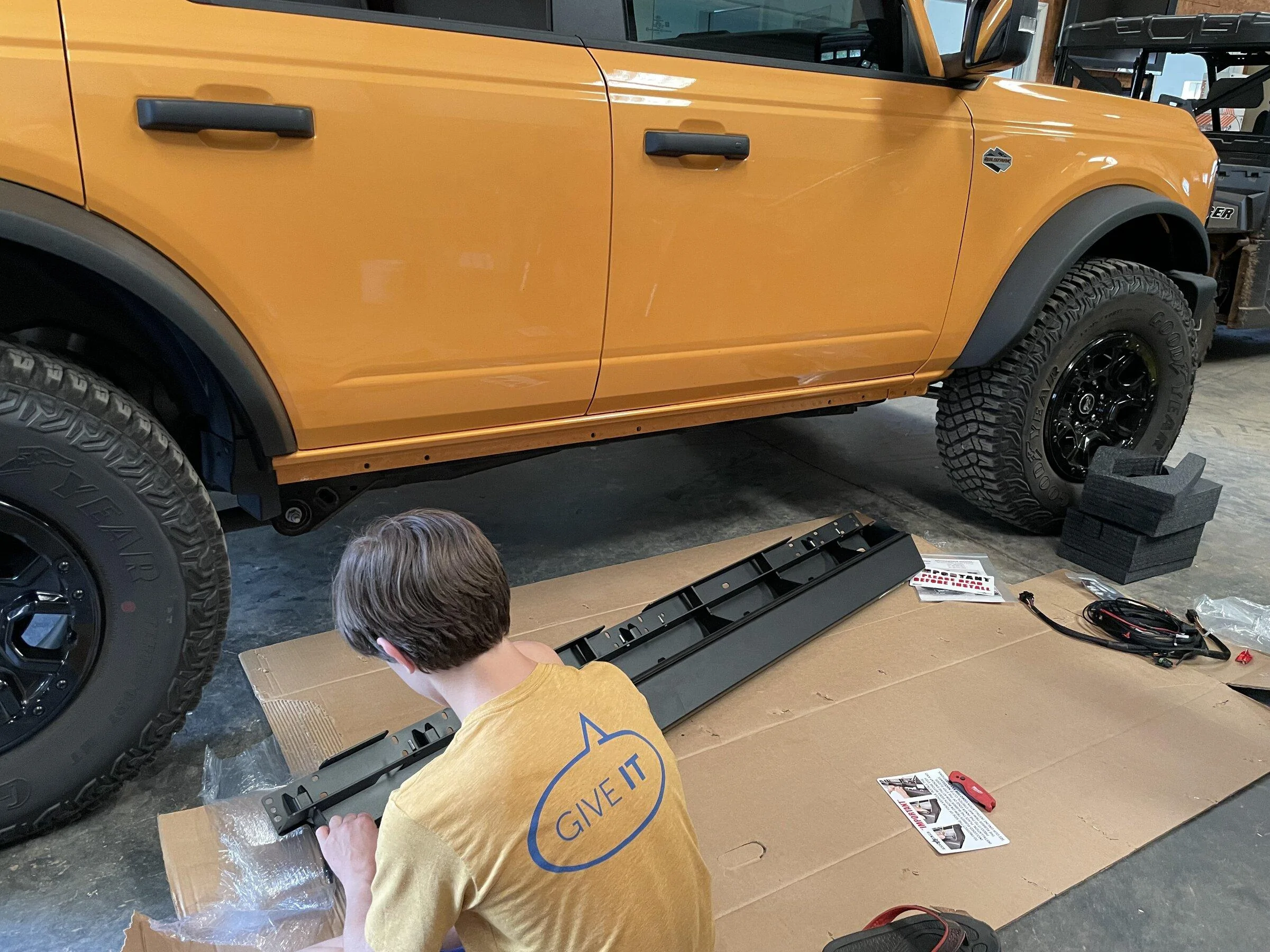

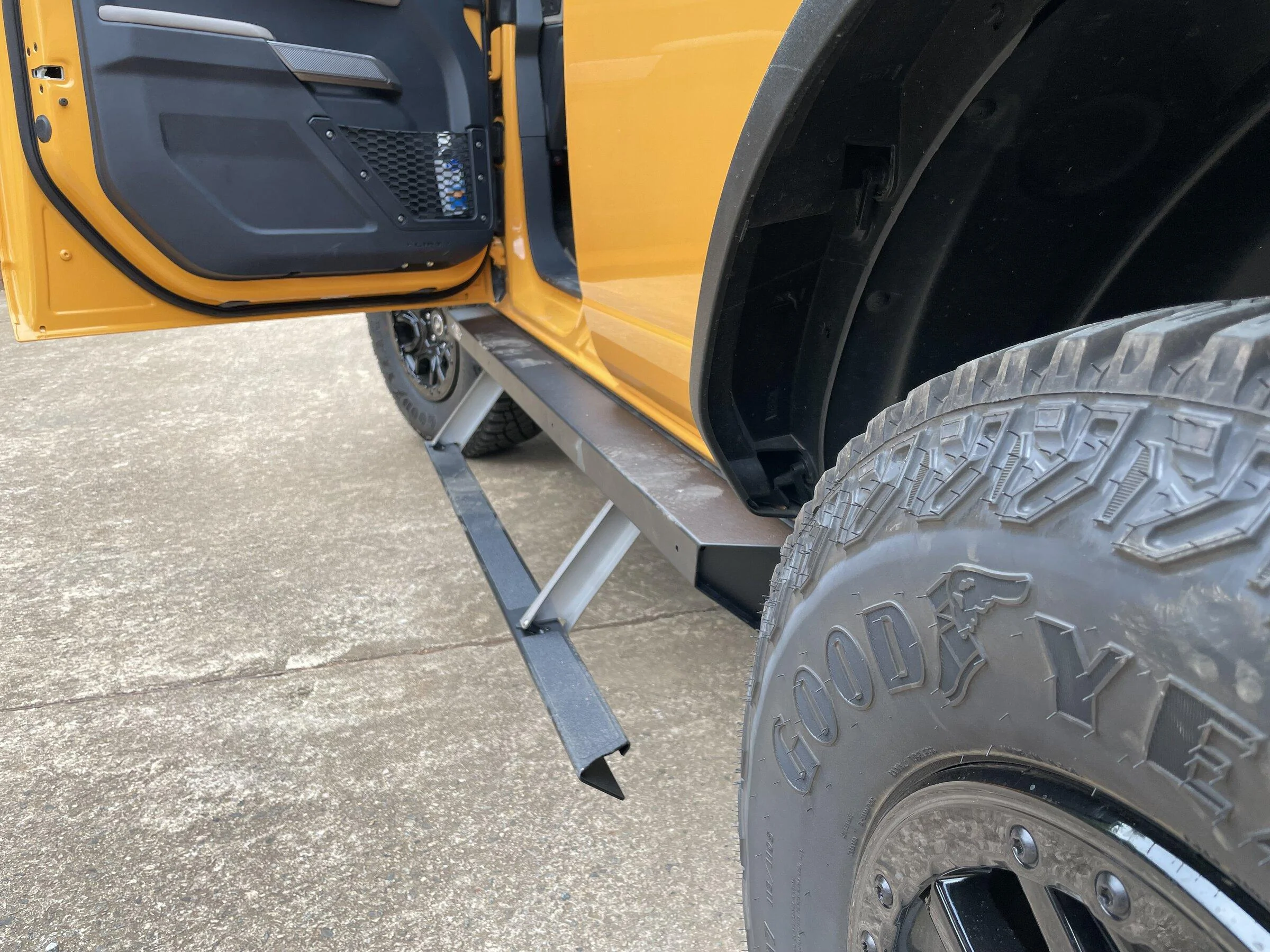

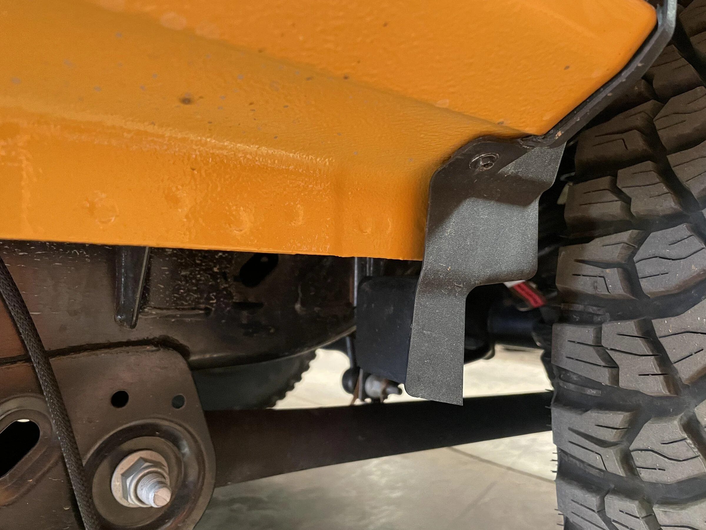

The installation was pretty easy. I did mix up the 2nd & last brackets, so that set me back a bit. The other part that hung me up was that my Wildtrak had a plastic piece on the rear wheel wells that had to be removed, which was not addressed in the instructions.
Ford Bronco Installed Rock Slide Engineering step slider IMG_1874
There were three long screws & 1 push pin per side. After removing the part, I reinstalled the mounting hardware for safekeeping.
I installed the sliders, the door delete kit, the lights & the skidplates.

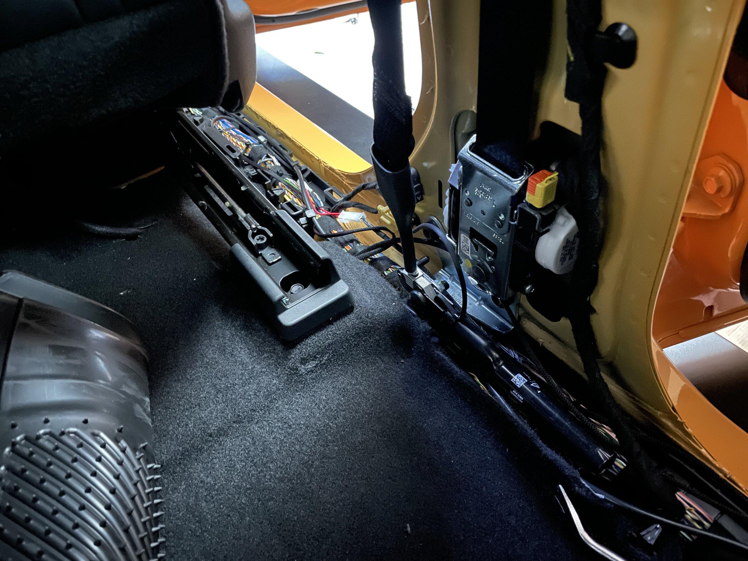

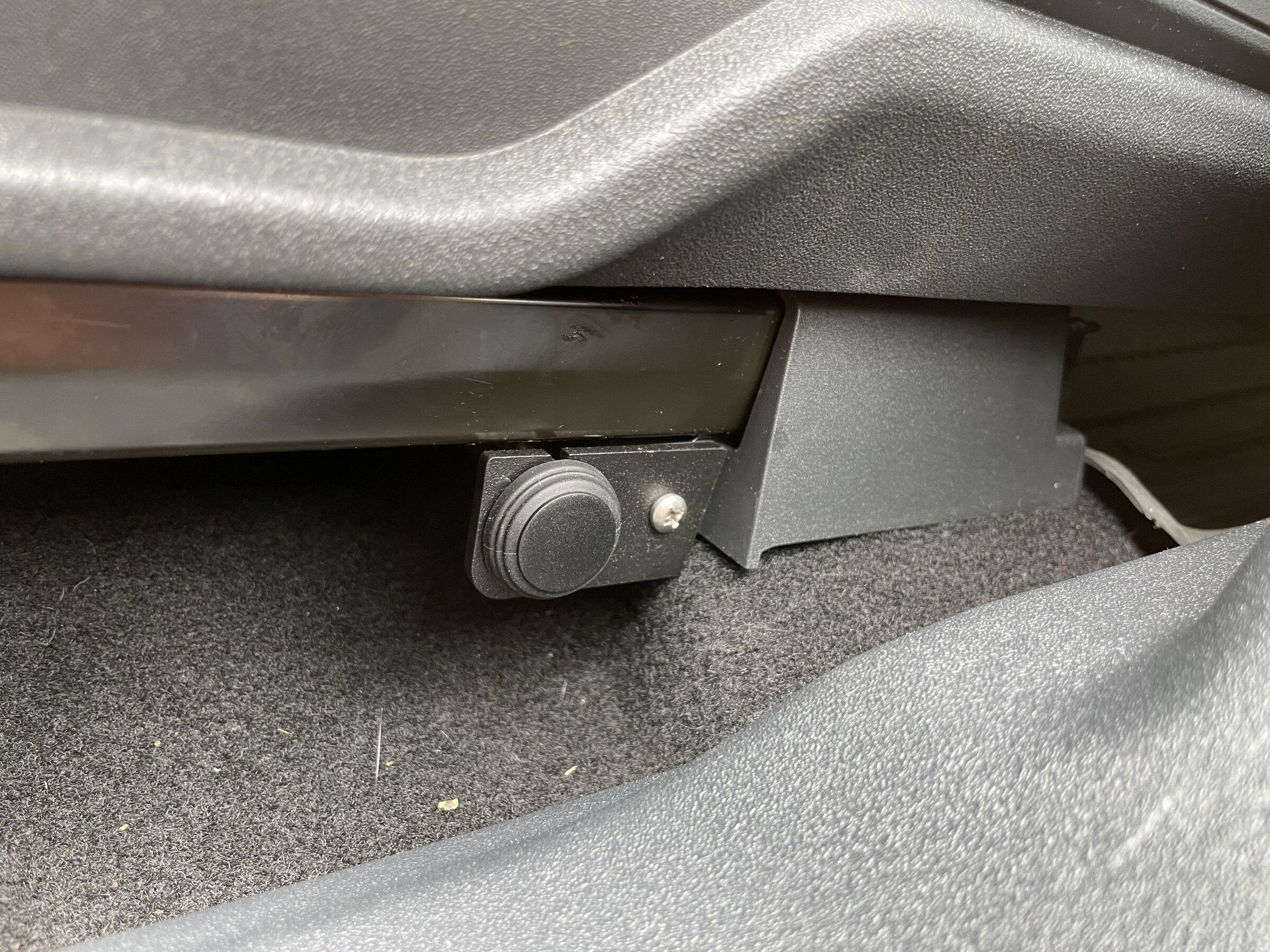

I found it best to go ahead & remove the plastic trim on the pillar between the doors as it allowed me to have the most room to clean up the wires & run the door delete wire under the carpet & up by the seat mounting point to keep the cables hidden.

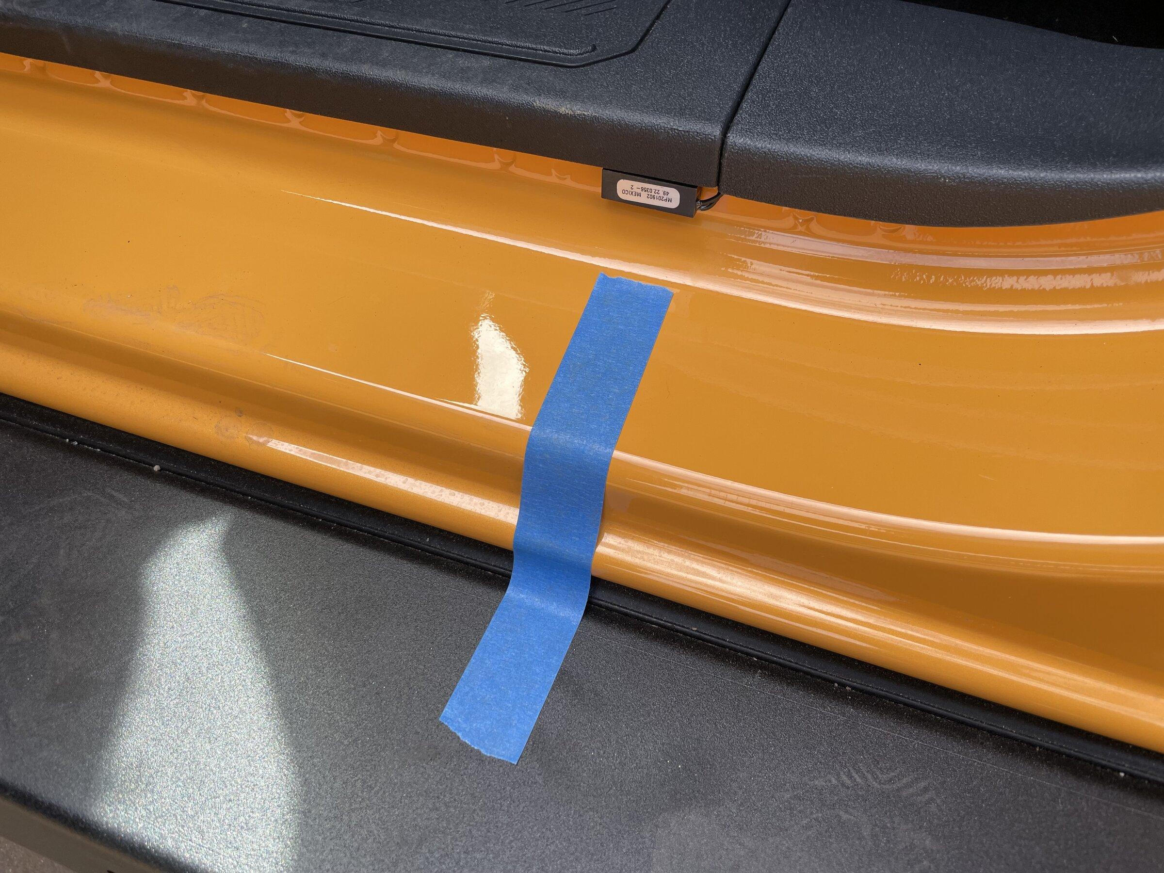

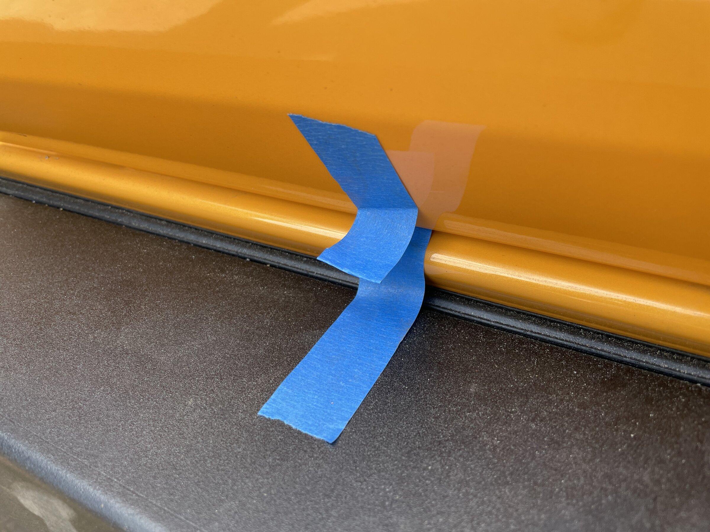

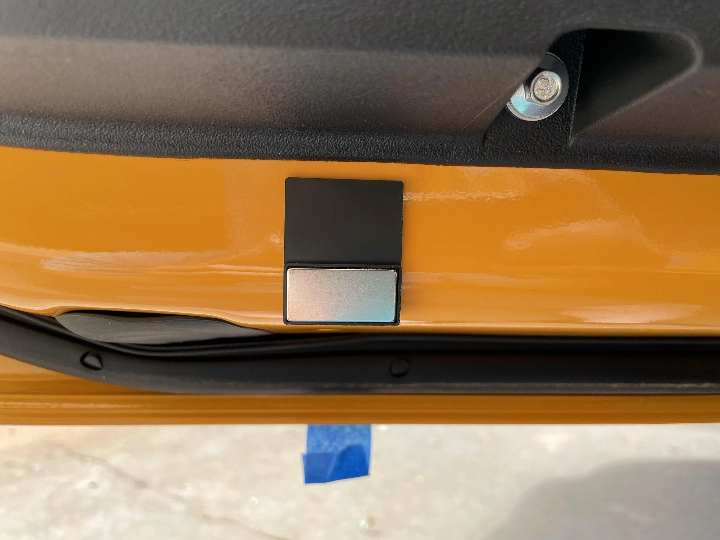

To help me align the magnet to the switch, I ran some blue painter's tape perpendicular to the switch out the door onto the step. Then I closed the door & ran a piece on the door, but left some hanging off the end. This allowed me to see exactly where the magnet needed to be installed.

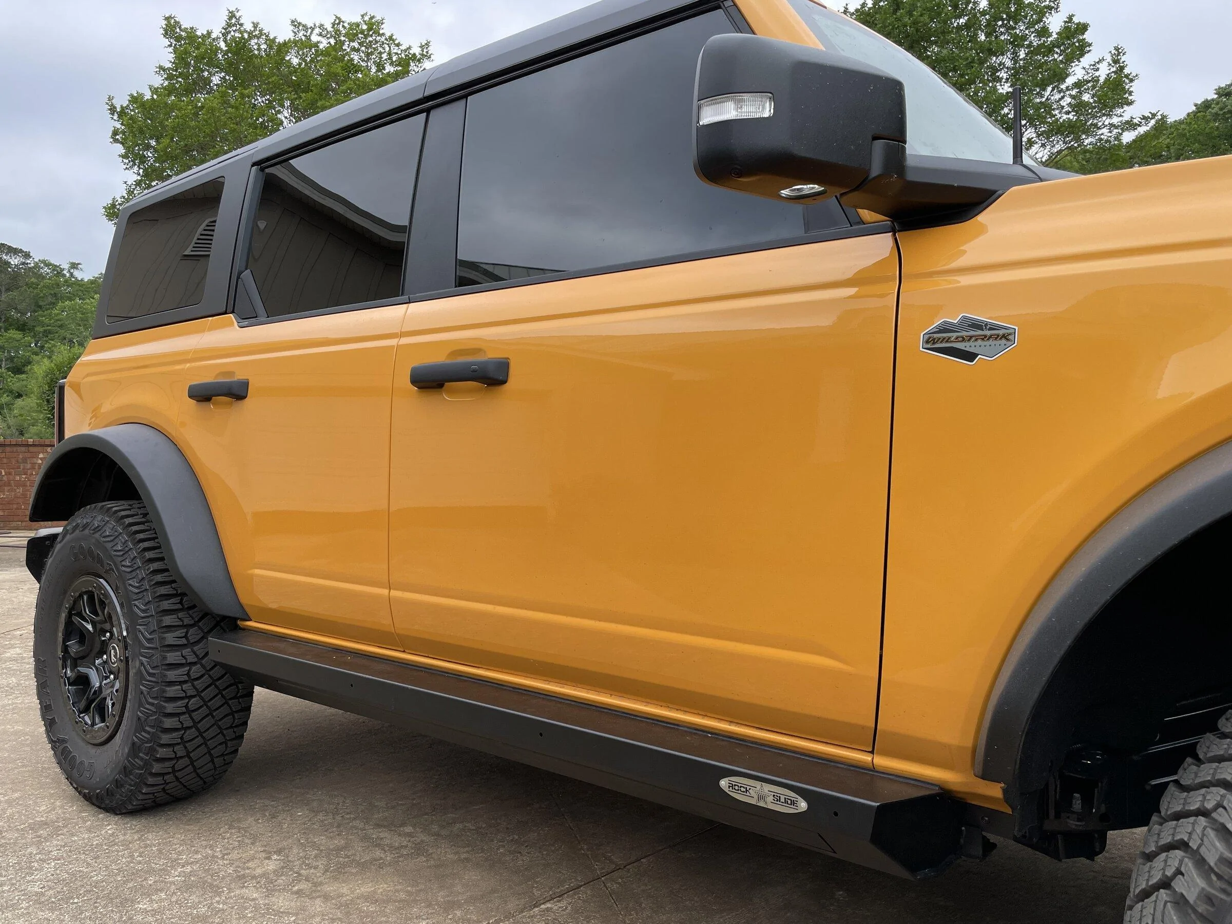

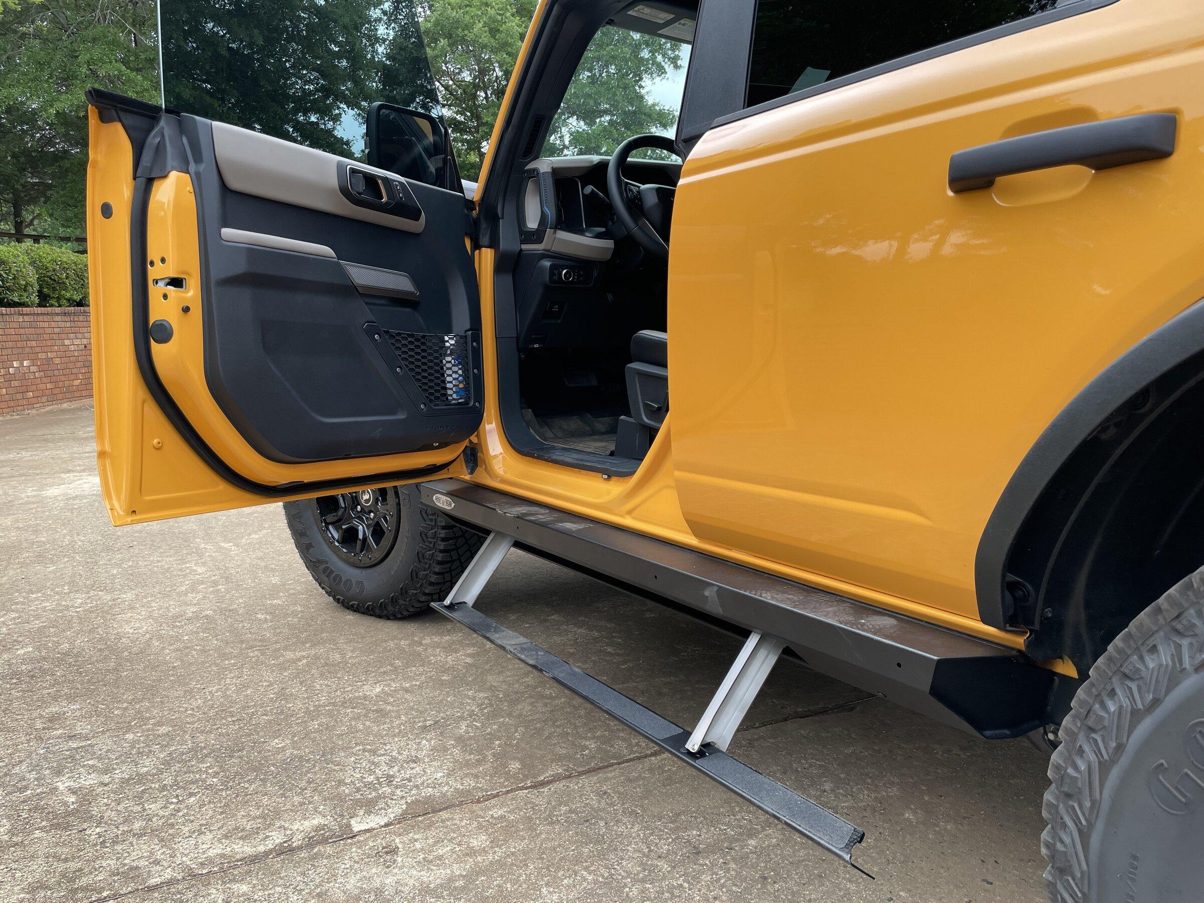

Here are some pictures of the finished results (I have not installed the skids yet as I want to retorque the bolts after driving it a bit)

All & in all, I am thrilled with them. These SAS tires throw rocks so severely, so I am glad to have all the coverage. They stick out about as wide as SAS flares, making them semi-in-the-way when getting in/out, but I would do it if I had it to do over again.
